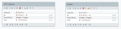

The input directory contains the following flow definition files:
  • TCP_Listener_flow_definition.json
    This file contains the TCP Listener process group (ID: b41940d7-0194-1000-42fc-458834630567)
  • Elastic_flow_definition.json
    This file contains process group Elastic (ID: b42881c7-0194-1000-3cdf-1bd453a0ed0f)

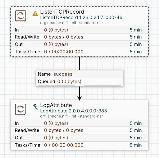

TCP Listener Process Group
This process group contains the following simple flow:
The process group defines a variable called TCP Listener Port, which is referenced by the ListenTCPRecord processor.

The example guides you through component migration one flow definition at a time, simplifying the process and maintaining a clear activity log. Although the example uses simple flow definitions, the step-by-step approach can be applied to more complex scenarios. In real-world scenarios, Cloudera recommends defining a migration strategy based on your flow’s structure.
  1. Make a backup of the output folder (/etc/migration-tool-output/components) before running the next migration step.
  2. Copy the migrated_TCP_Listener.json and migrated_Elastic.json files to the Migration Tool’s input folder (/etc/migration-tool-input).
  3. Rename the file, overwriting the existing ones, to TCP_Listener_flow_definition.json and Elastic_flow_definition.json for clarity.

  8. Validate the Stage 2 component migration output for TCP_Listener_flow_definition.json.
    1. Load the targetVersion/migrated_output/migrated_TCP_Listener.json into a NiFi 2 instance and check the flow.
    2. Review the targetVersion/activity_log.json file.
      In this example, you can see the following manual-change-request entry.
      	"sequence" : 6,
      	"type" : "manual-change-request",
      	"subject" : "b41966ad-0194-1000-a08d-a92489457356",
      	"message" : "The component has been deprecated. It is suggested to replace it with a combination of [org.apache.nifi.processors.standard.ListenTCP] and [org.apache.nifi.processors.standard.ConvertRecord] processors",
      	"context" : {
        	"rule" : "36227b60-75f0-40dc-8caf-a2ec577aa54c"
      1. Open the targetVersion/migrated_TCP_Listener.json file and search for the "subject" ID b41966ad-0194-1000-a08d-a92489457356. This ID refers to the ListenTCPRecord processor.
      2. To identify the processor affected by these changes, search for the identifier value of the “subject” element in NiFi’s search box. It refers to the ListenTCPRecord processor. Open the TCP Listener process group. You can see that the processor is marked with dashed borders and its version number still shows that of the NiFi 1 instance. It means that it is a "ghost processor", not available in NiFi 2. The log message suggests replacing it with a combination of ListenTCP and ConvertRecord processors.
        Instantiate and configure the ListenTCP and ConvertRecord processors, connect them appropriately, and then remove the ghost processor.
        Besides these changes there are no further manual-change-requests or manual-validation-requests in the Activity Log.
