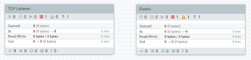

The flow consists of two process groups:
  • TCP Listener (ID: b41940d7-0194-1000-42fc-458834630567)
  • Elastic (ID: b42881c7-0194-1000-3cdf-1bd453a0ed0f)
At the root level, the flow is structured as follows:

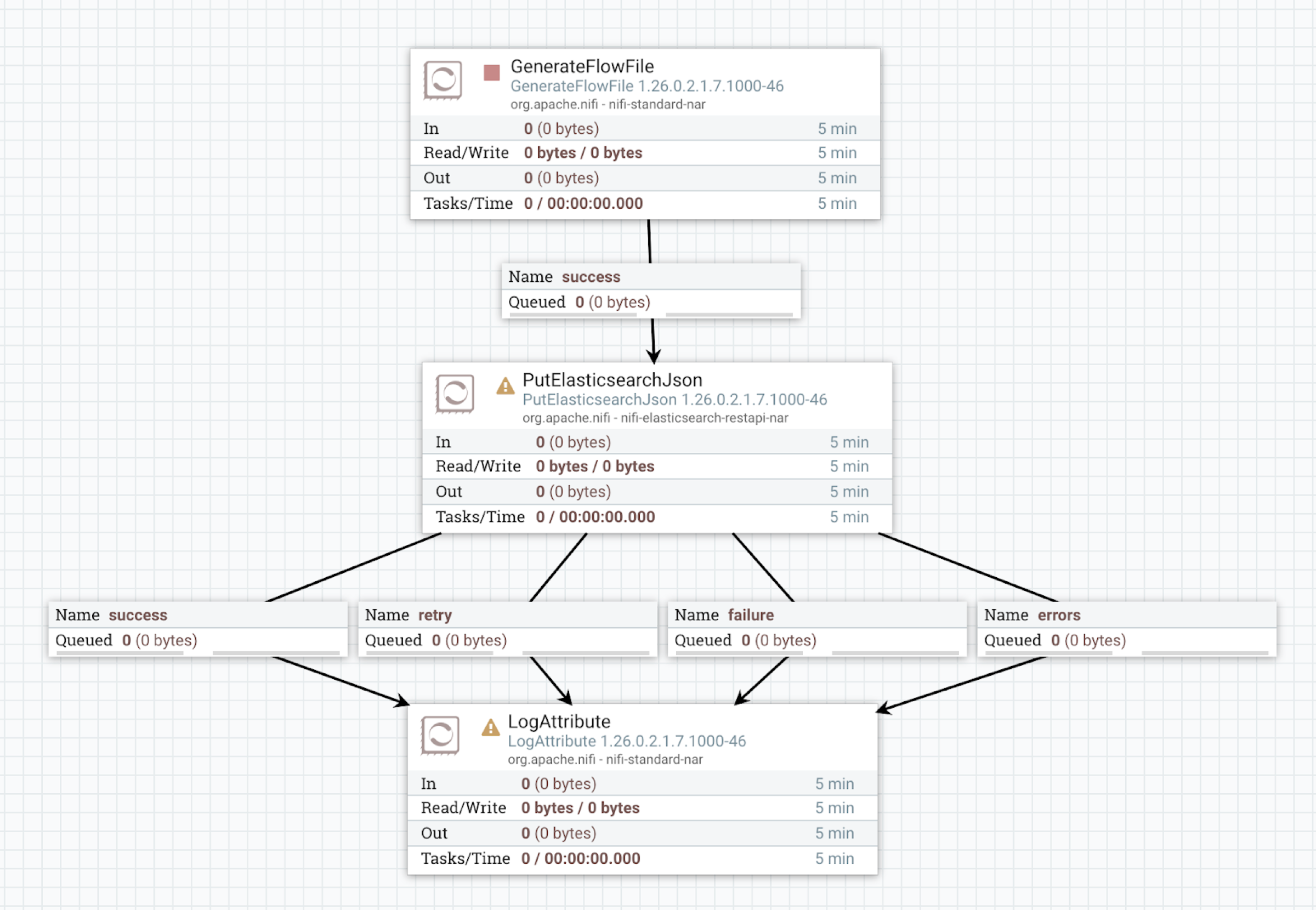

Elastic Process Group
This process group also contains a simple flow:
The process group defines a variable called Elasticsearch Index. This variable is referenced in the PutElasticsearchJson processor’s Index property.
