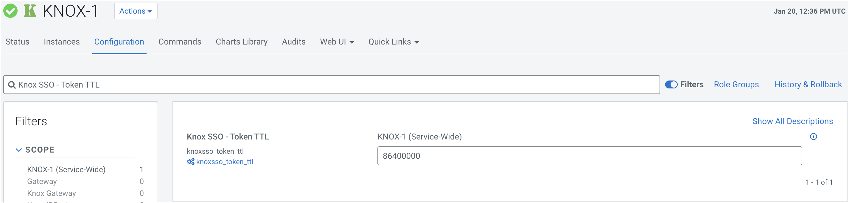

  1. In Cloudera Manager, select the Knox service.
  2. Go to Configuration.
  3. Search for the Knox SSO - Token TTL property.
  4. Update the default value to match the duration that is most suitable to your organization's requirements.
  5. Click the Save Changes(CTRL+S) button.
  6. Refresh the Knox instances configuration by clicking the Stale Configuration: Refresh needed indicator and wait until the refresh process completes.
