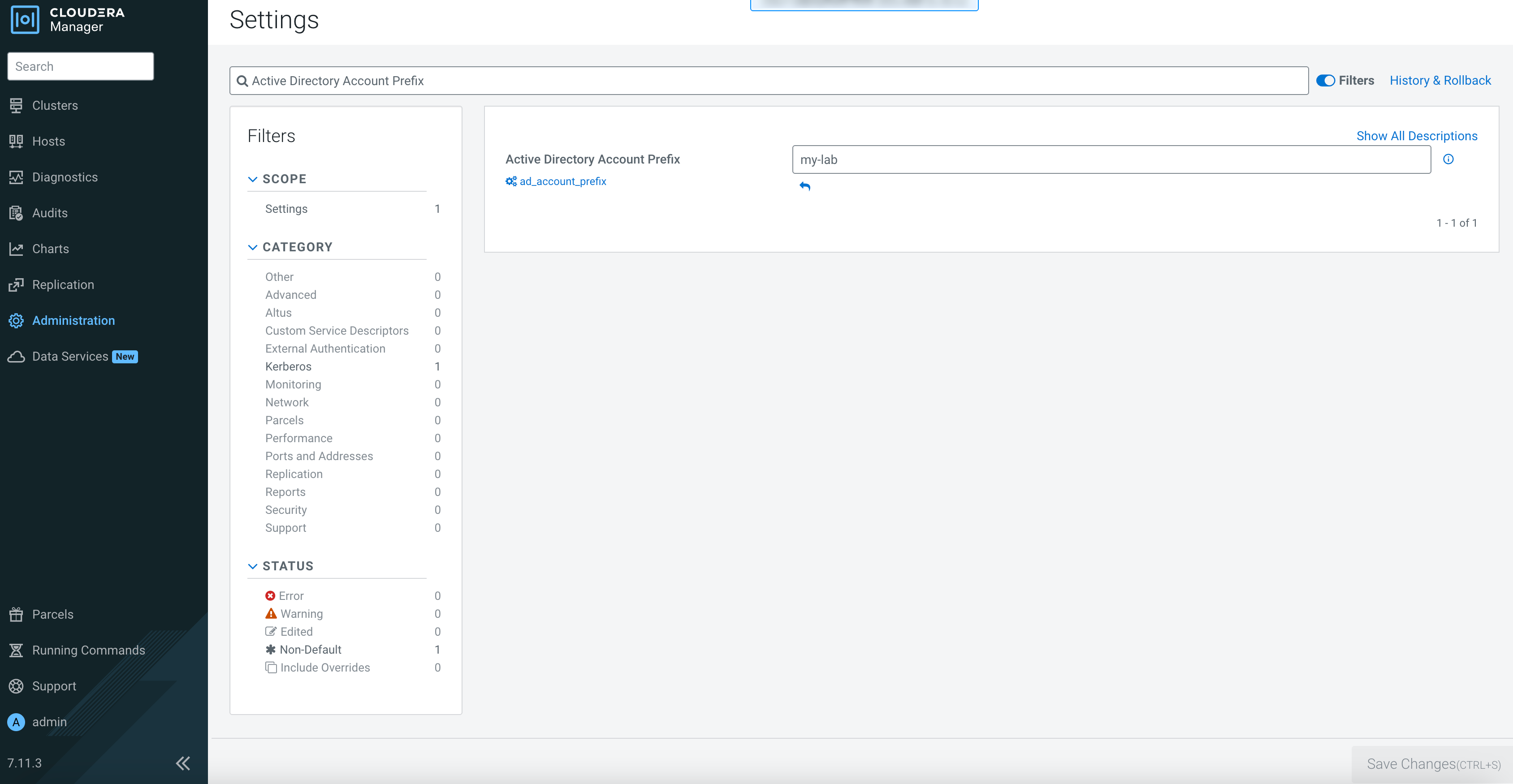

9. Add prefix to account names in Active Directory (Optional)
Learn about the steps you need to perform to add a prefix to account names in Active Directory.
If you are using Active Directory to enable Kerberos authentication, the account names in Active Directory show random strings created automatically by a bash script hosted in Cloudera Manager. This is expected behavior, but you can add a prefix to the account names, which helps identify the accounts used for authentication.
Follow these steps to add a prefix to the account names in Active Directory:
  1. In the Cloudera Manager Admin Console, select Administration > Settings.
  2. Find Active Directory Account Prefix in the search bar.
  3. Enter the desired prefix in the text field, such as my-lab or similar.
  1. Click Save Changes.
  2. On the Home > Status tab, click the three dots to the right of the cluster name, and select Stop.
  3. Regenerate the Kerberos credentials by selecting Administration > Security > Kerberos Credentials.
  4. Select all credentials, then click Regenerate Selected.
  5. On the Home > Status tab, click the three dots to the right of the cluster name, and select Start.
  6. Check in the Active Directory if the changes are reflected in the account names.
