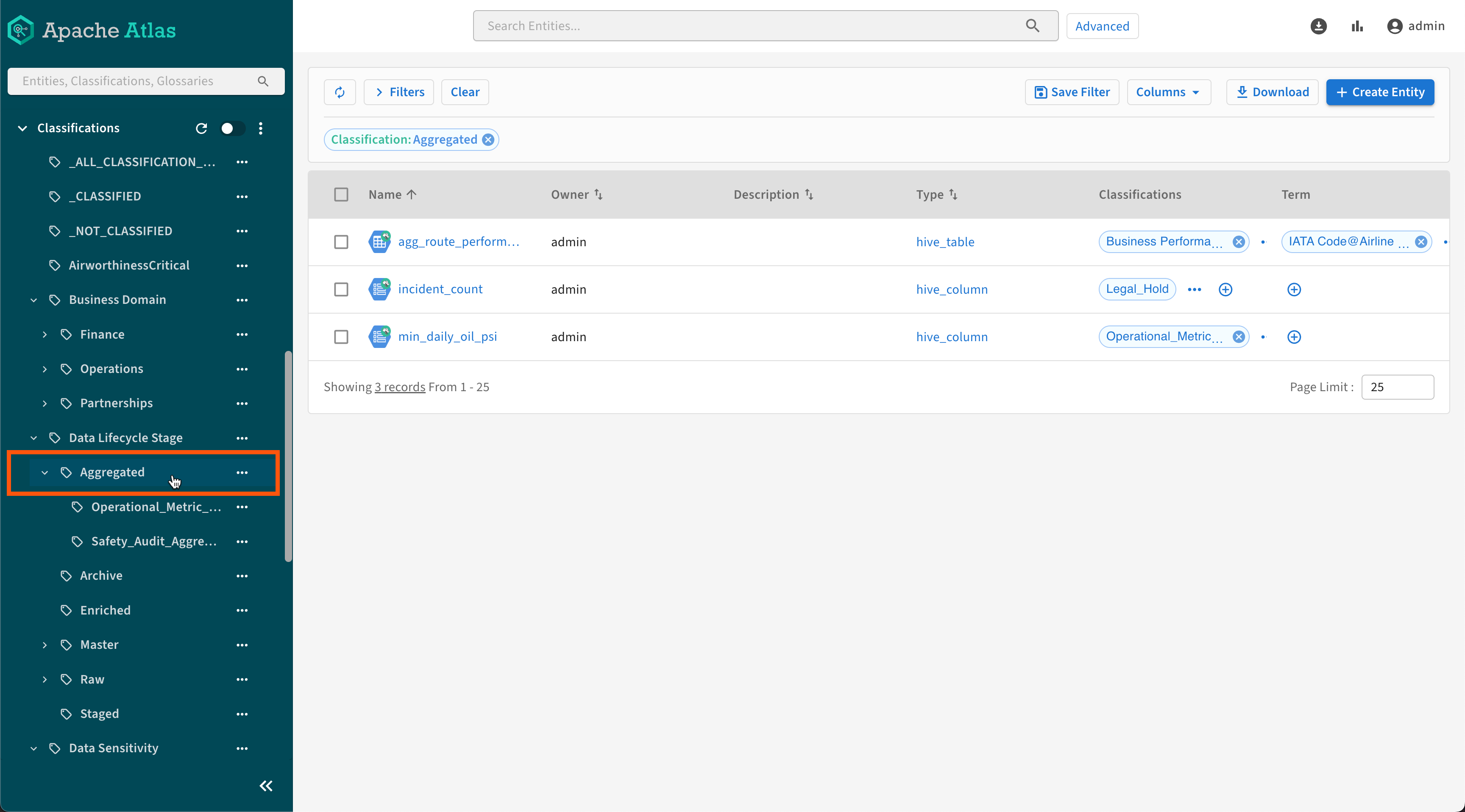

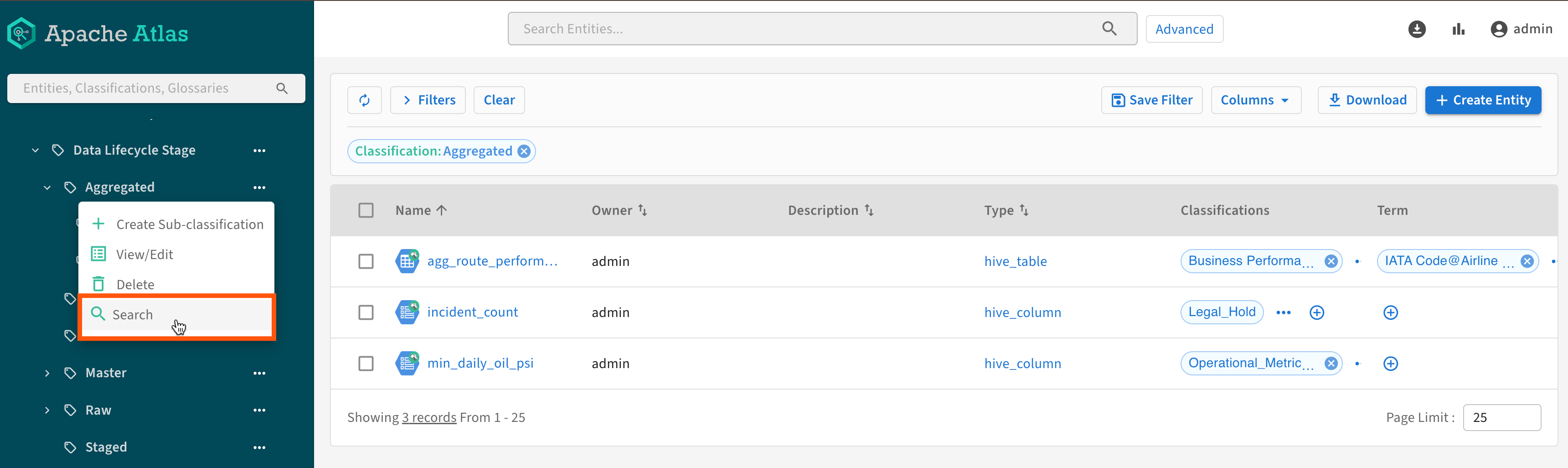

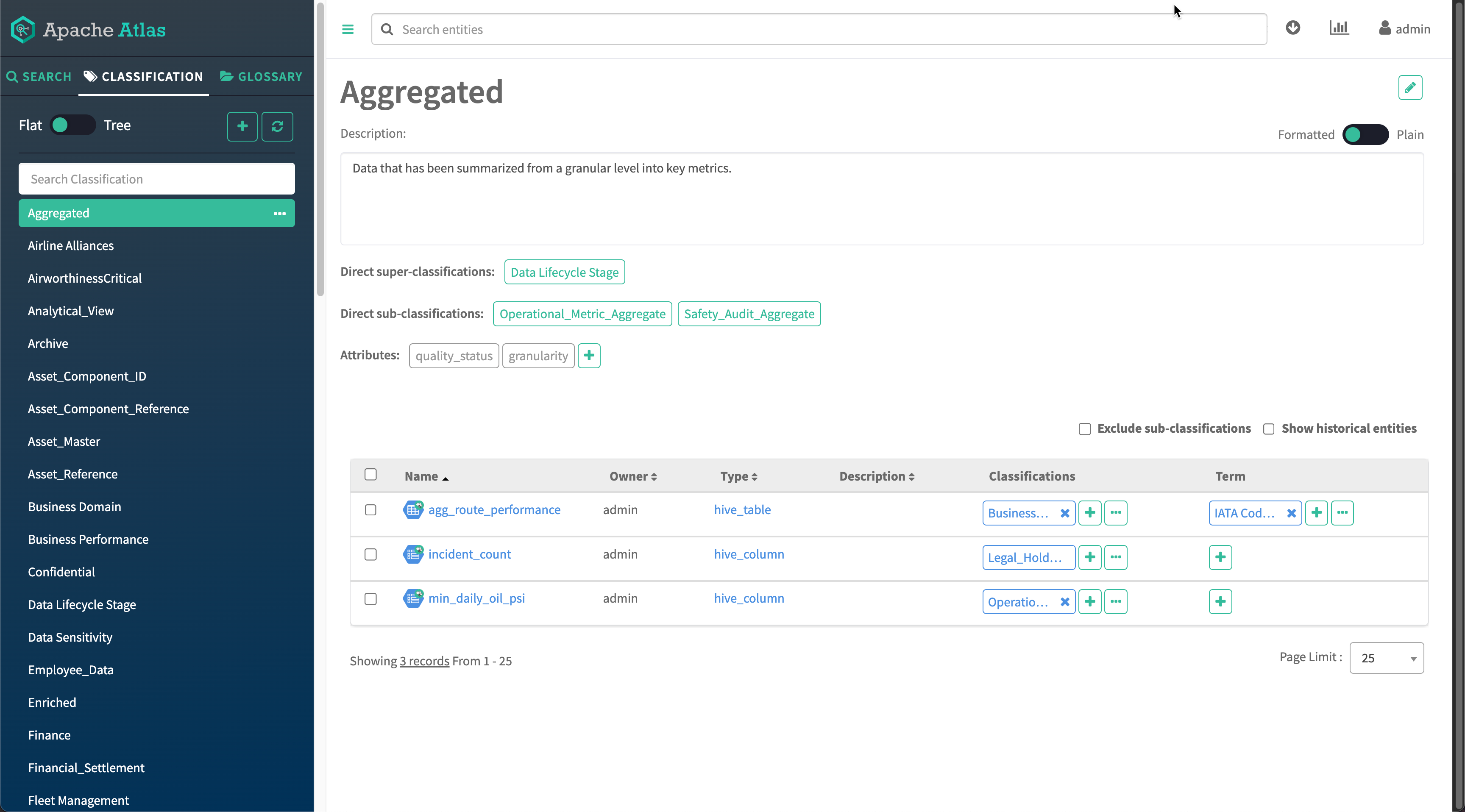

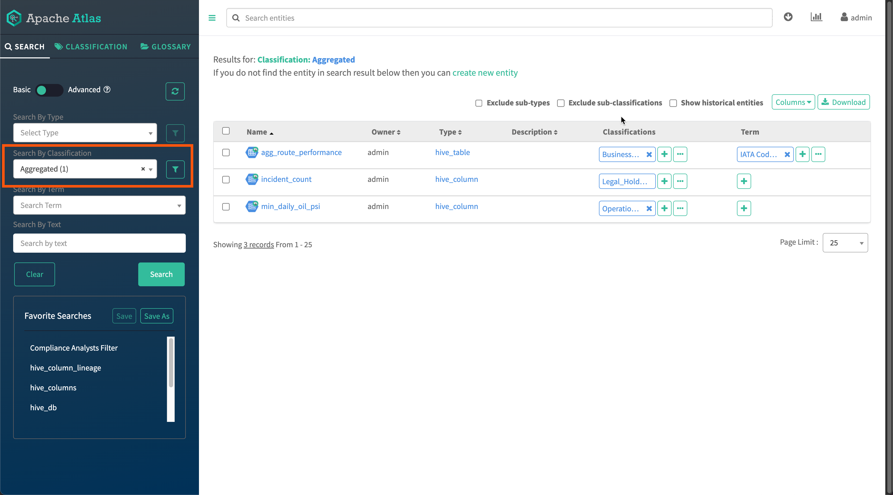

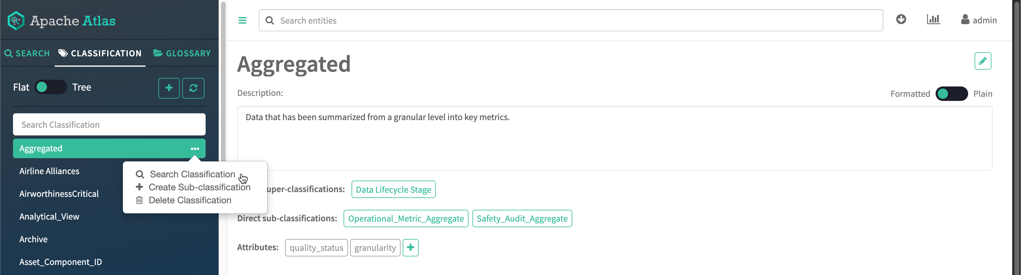

The Atlas dashboard makes it easy to find entities that you've tagged with classifications. In the left navigation pane, go to the Classification and select the classification you want. You can refine your search results by adding criteria on the Search tab (Basic search).
Figure 1. Classification search results
Figure 2. Classification search results
Figure 3. Starting a filtered classification search
Figure 4. Classification search with filters
