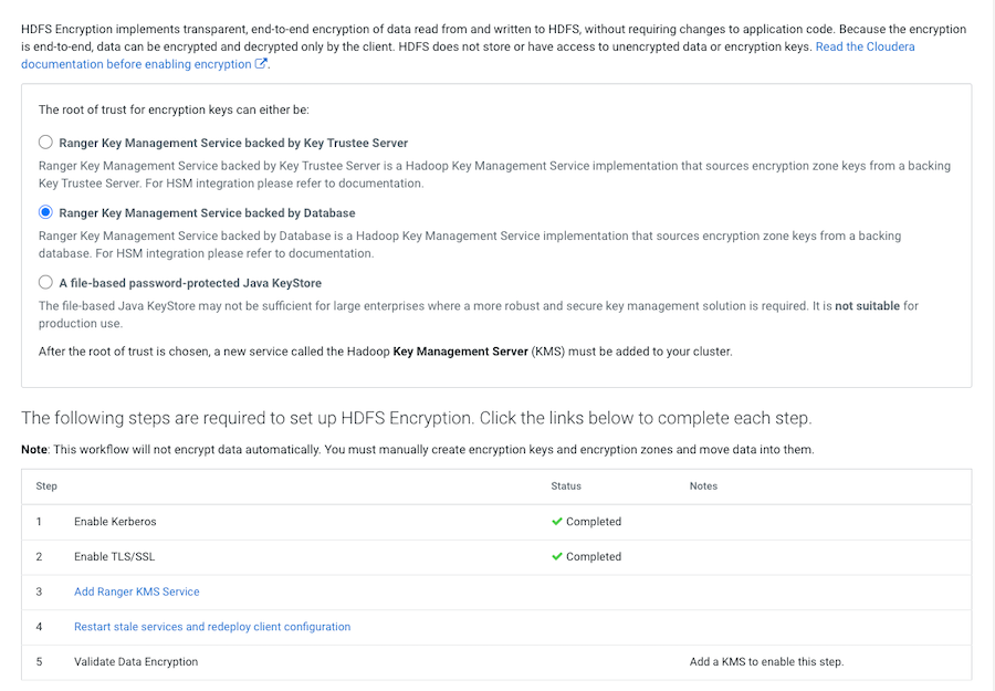

This task uses the Set up HDFS Data At Rest Encryption wizard to install a Ranger KMS that uses a database as the backing key store.
The following image shows the Set up HDFS Data At Rest Encryption page. When you select your encryption keys root of trust option, a list of tasks that you must do to enable encryption to-and-from HDFS is displayed.
You complete each task independently from the other tasks. Where, the task’s Status column indicates whether the step has been completed and the Notes column provides additional context for the task. If your Cloudera Manager user account does not have sufficient privileges to complete a task, the Notes column indicates the privileges that are required.
When selected, each task contains links to wizards or documentation that help you complete the task. If a task is unavailable, due to insufficient privileges or an incomplete prerequisite step, no links are present and the Notes column displays the reason.
The Wizard steps are as follows and must be completed in the order listed:
  1. Enable Kerberos
  2. Enable TLS/SSL
  3. Add a Ranger KMS Service
  4. Restart the stale services and redeploy the client configuration
  5. Validate the Data Encryption
The following lists the post installation tasks for Installing the Ranger KMS backed by a Database and HA:

  1. In a supported web browser on the cluster in which the Ranger service is installed, log in to Cloudera Manager as a user with full administrative privileges.
  2. From the Cloudera Manager navigation side-bar, select Administration > Security.
  3. On the Security Status page, click Set up HDFS Data At Rest Encryption.
  4. In the Set up HDFS Data At Rest Encryption page, select the Ranger Key Management Service backed by Database option.
    A list of tasks are displayed at the bottom of the page. To successfully set up HDFS Data at Rest encryption, these tasks must be completed.
  5. To set up HDFS Encryption, follow the instructions as described below for each of the Set up HDFS Data At Rest Encryption Wizard's steps.
