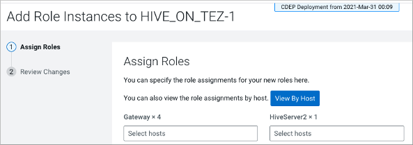

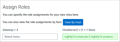

Cloudera Runtime services include Hive on Tez and Hive Metastore (HMS). Hive on Tez is a SQL query engine using Apache Tez that performs the HiveServer (HS2) role in a Cloudera cluster. You must install the Hive service (HMS) before Hive on Tez and HMS in the correct order; otherwise, HiveServer will fail. You must add the HiveServer role additionally to Hive on Tez, not the Hive service; otherwise, HiveServer will fail.
