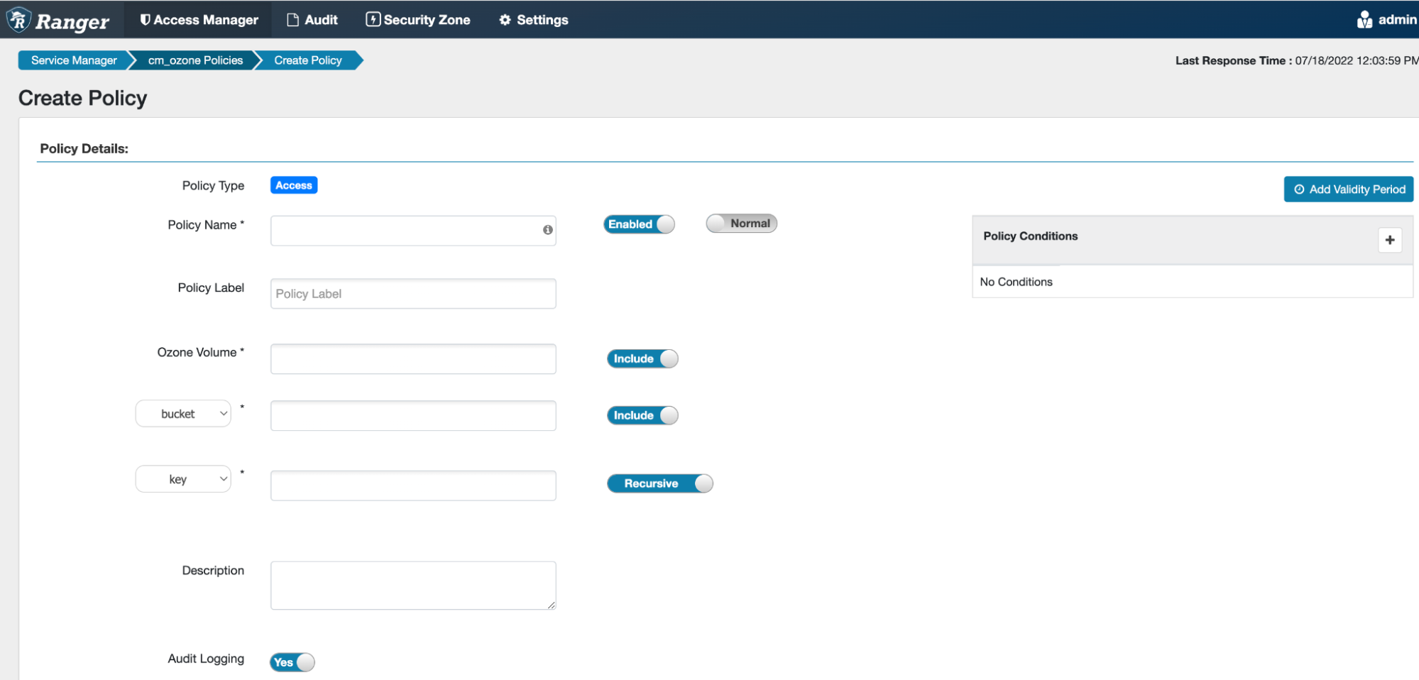

  1. On the Service Manager page, select an existing Ozone service. The List of Policies page appears.
  2. Click Add New Policy. The Create Policy page appears.
  3. Set the configurations on Create Policy page:
    FieldDescription
    Policy Name
    Enter a unique name for this policy. The name cannot be duplicated anywhere in the system.
    Normal or Override
    Enables you to specify an override policy. When override is selected, the access permissions in the policy override the access permissions in existing policies. This feature can be used with Add Validity Period to create temporary access policies that override existing policies.
    Add Validity Period
    Specify a start and end time for the policy.
    Policy Label (Optional) Specify a label for this policy. You can search reports and filter policies based on these labels.
    Ozone Volume
    Specify volumes that can be accessed. Ensure that the Ozone volume key is set to Include.
    If you want to deny access at the volume level, then disable this option by turning off using the Ozone Volume key to Exclude.
    Bucket
    Specify buckets that can be accessed. Ensure that the Ozone Bucket key is set to Include.
    If you want to deny access at the bucket level, then disable this option by turning off using the bucket key. Or, select None from the Bucket drop-down.
    Key
    Provide the Key
    Recursive or Non Recursive
    Recursive or Non recursive function
    Description
    (Optional) Describe the purpose of the policy.
    Audit Logging
    Specify whether this policy is audited. To disable auditing, turn off the Audit Logging key.
