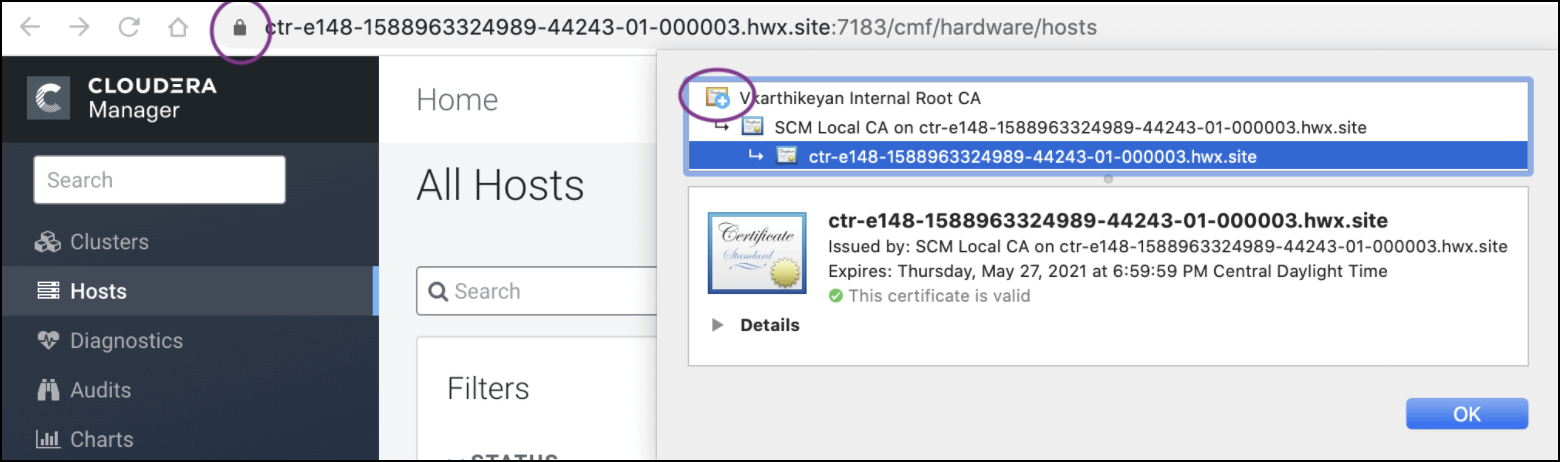

  5. Once the execution is done, start Cloudera Manager on TLS port 7183. If the signed Intermediate certificate is already imported into your browser’s truststore, then you should not see any warnings. In the screenshot below, “Vkarthikeyan Internal Root CA” is the root certificate. This certificate is already trusted by the system and has signed by the Cloudera intermediate CA.
