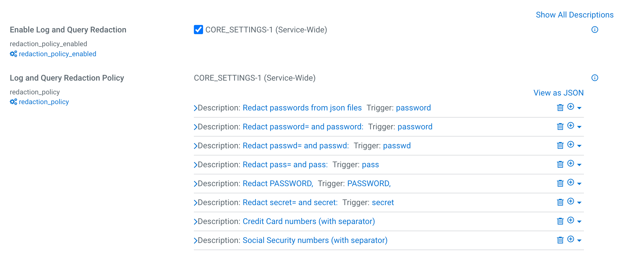

Enabling Log and Query Redaction Using Cloudera Manager
To enable log and query redaction in Cloudera Manager:
  1. Login to the Cloudera Manager Admin Console.
  2. Select Clusters > CORE_SETTINGS.
  3. Click the Configuration tab.
  4. In the Search box, type redaction to find the redaction property settings:
    • Enable Log and Query Redaction
    • Log and Query Redaction Policy list of rules for redacting sensitive information from log files and query strings. Choose a preconfigured rule or add a custom rule. See How Redaction Rules Work for more information about rule pattern definitions.
      Test your rules:
      • Enter sample text into the Test Redaction Rules text box
      • Click Test Redaction.
  5. Click Save Changes.
  6. Restart the cluster.
If no rules match, the text you entered displays in the Results field, unchanged.
