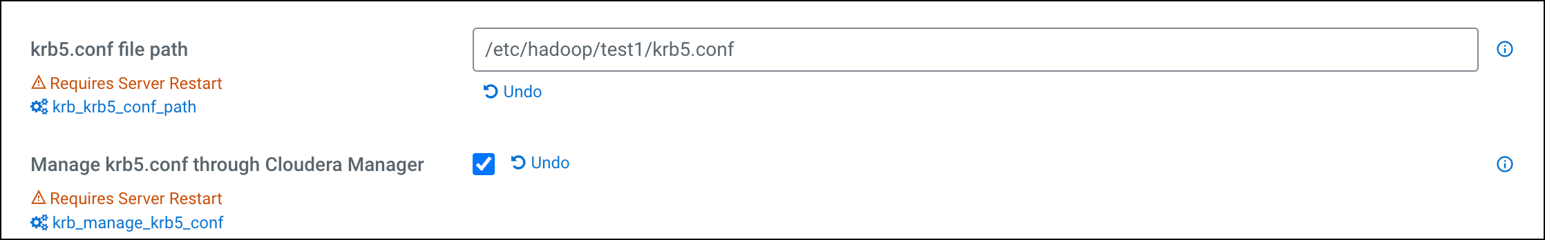

    Option 1: Configure Manage krb5.conf by Cloudera Manager and set the new location of krb5.conf to /etc/hadoop/[***custom_path***]/krb5.conf.
    1. Go to Cloudera Manager > Administration > Settings.
    2. Enter /etc/hadoop/[***custom_path***]/krb5.conf for krb5.conf file path.
    3. Select the Manage krb5.conf by Cloudera Manager checkbox.
    4. Click on Save Changes.
