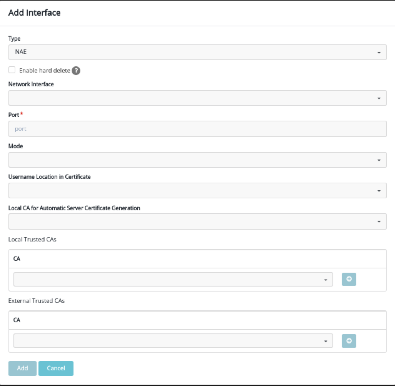

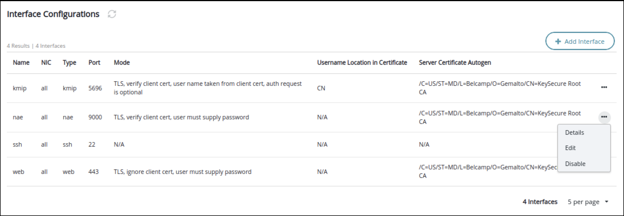

  1. Log in to Thales CipherTrust Manager.
  2. In CipherTrust Manager > Admin Settings, select Add Interface.
  3. In Type, Select NAE (default).
  4. In Network Interface, selectAll.
  5. In Port, type a value for the port number.
    9000
  6. In Mode, select one of the following options to match your environment:
    • No TLS,user must supply password.
    • TLS, Ignore client cert. user must supply password.
  7. Click Add.

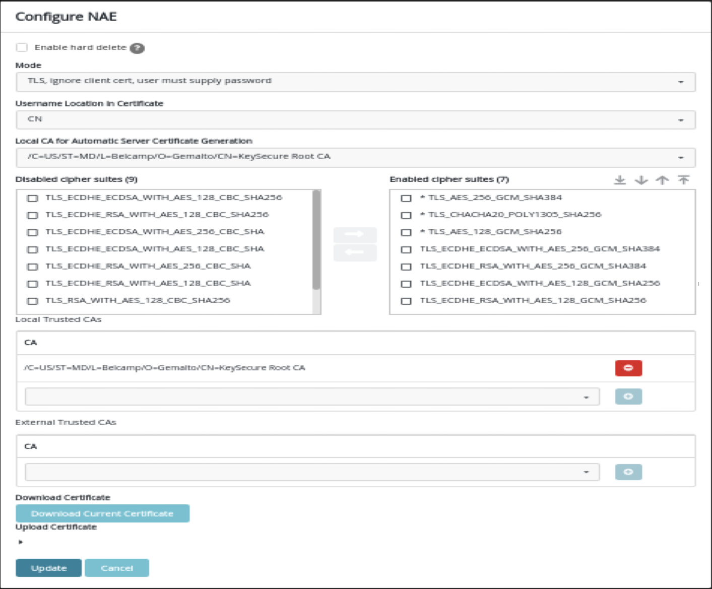

  8. If selected mode is TLS, ignore client cert, user must supply password while adding interface, then click on Edit and Download Current Certificate as shown in the images below. Else, skip this step.
  9. After the certificate is downloaded (for example, Certificate_nae.txt), copy it to Ranger KMS server

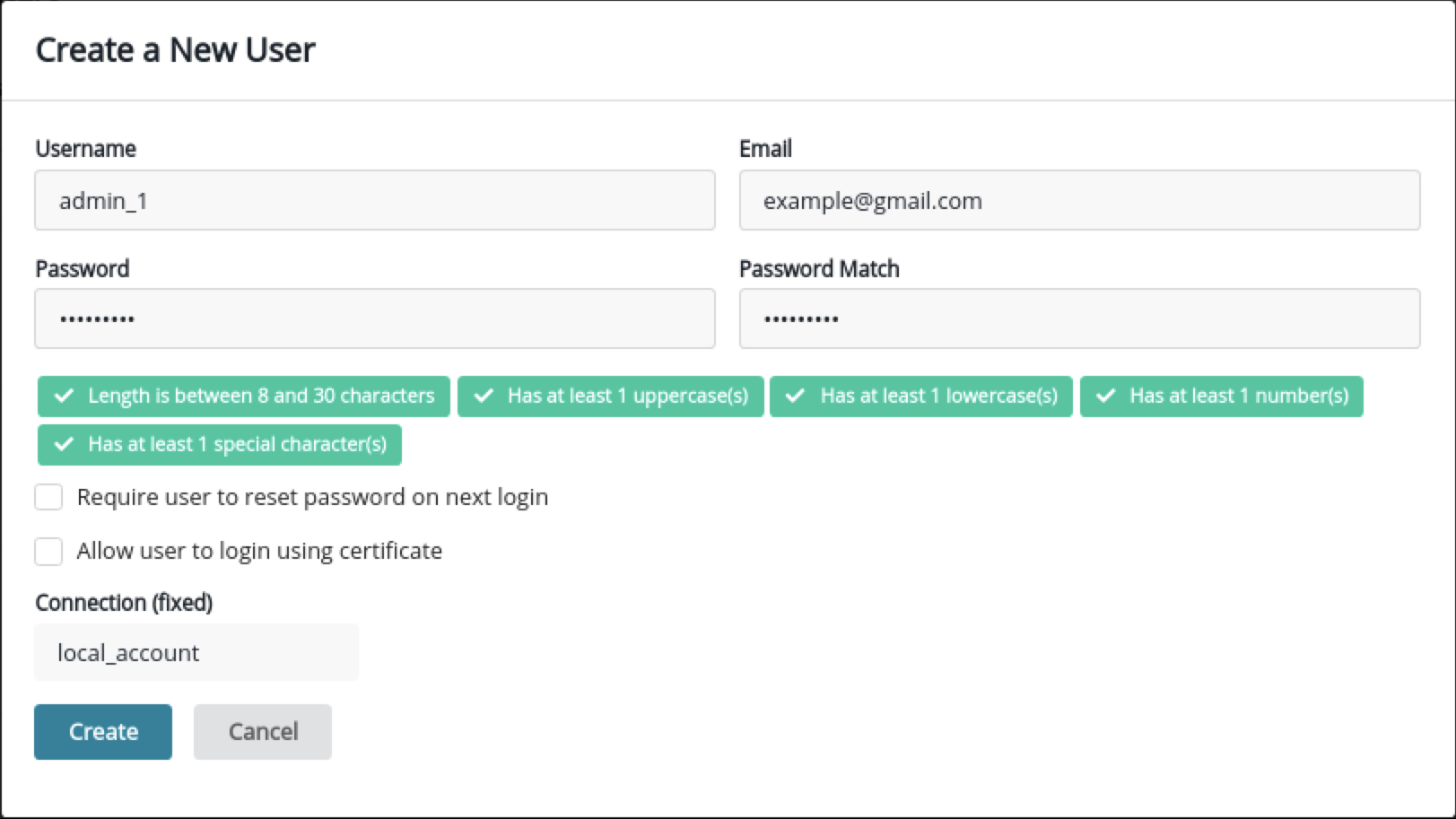

  10. Create a user.
    1. Go toAccess Management > Users, click Create New User .
    2. In Create a New User, provide a username, password, and any required information.
    3. Click Create.

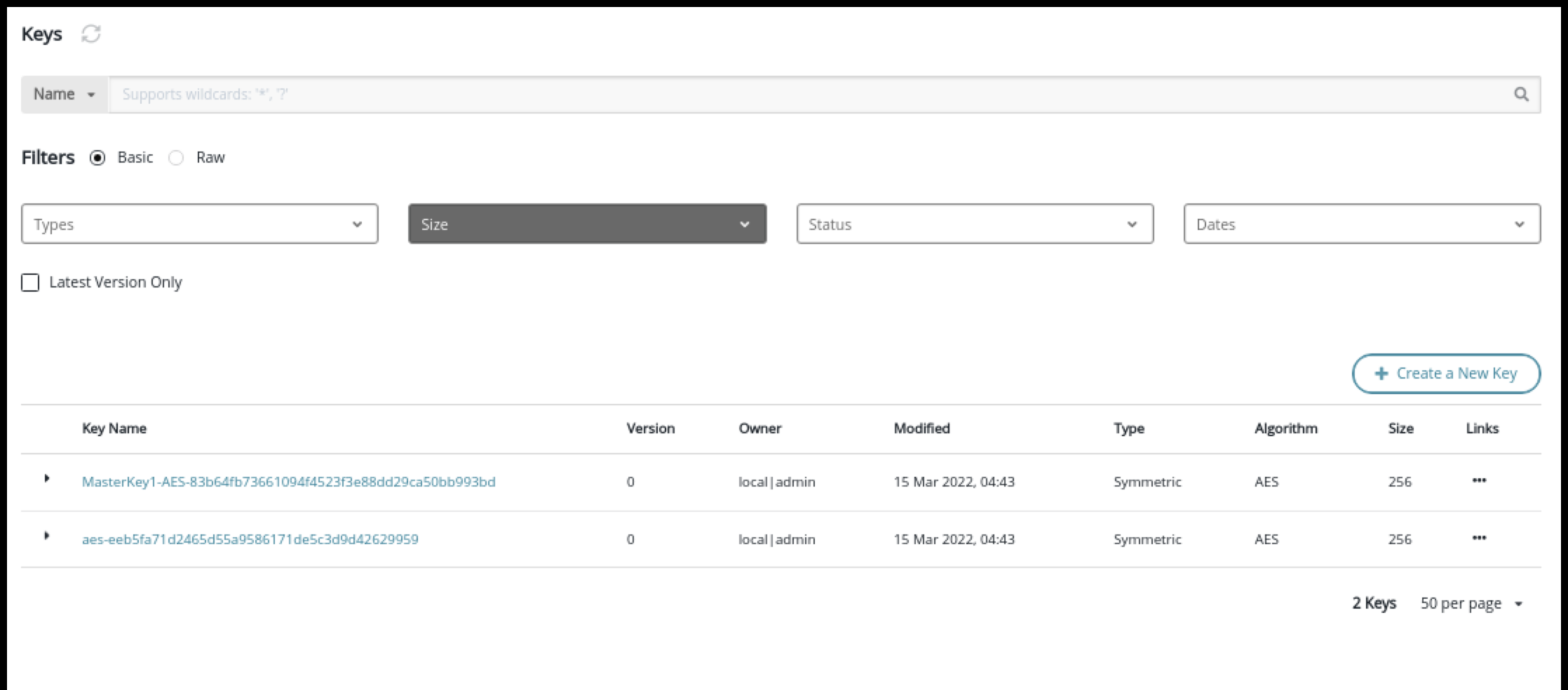

The master key with alias MasterKey1 is created in CipherTrust Manager.
Once Ranger KMS has started successfully, verify zone key creation, and zone encryption/decryption.
