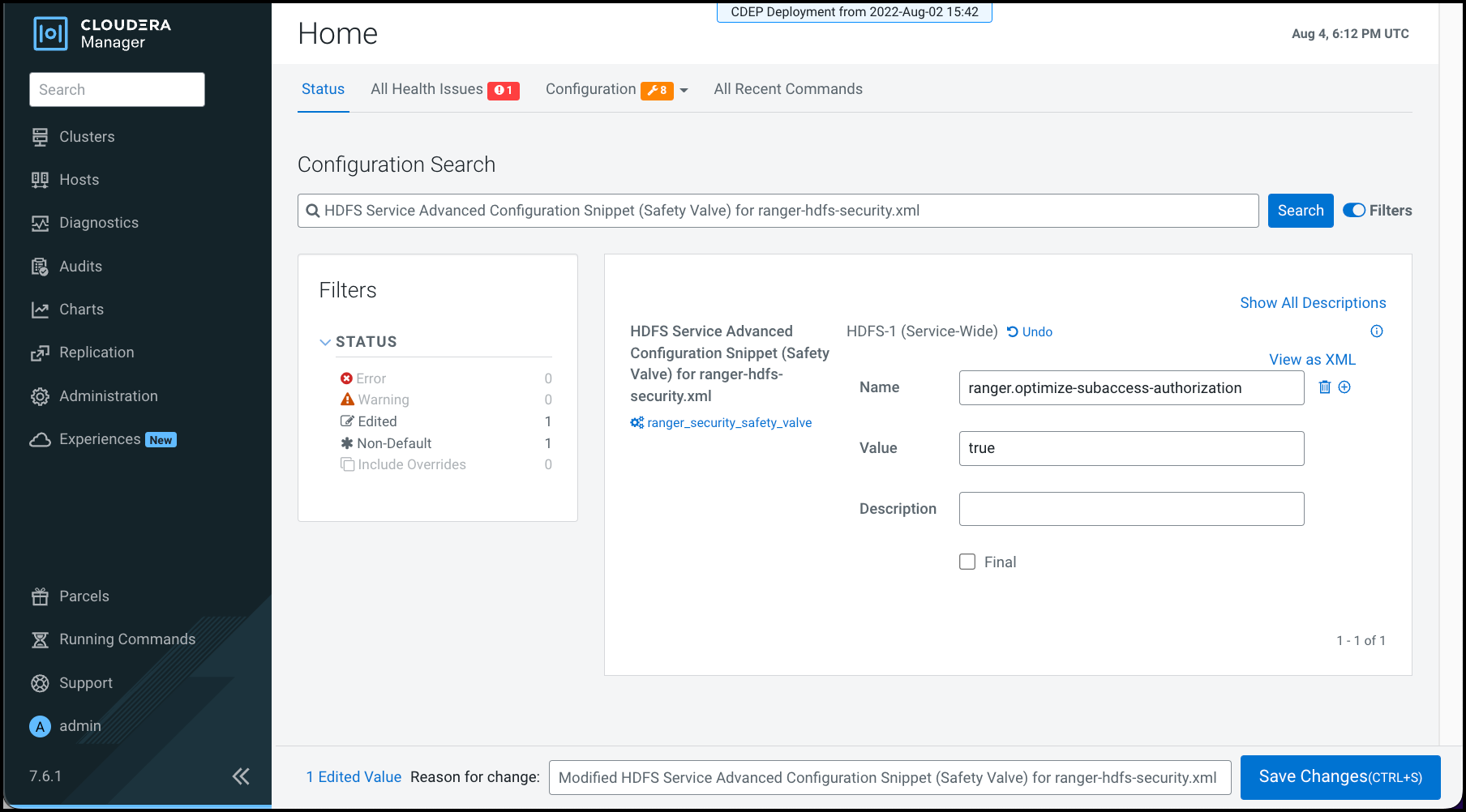

HDFS contentSummary calls locked
Symptom: contentSummary calls in HDFS locking for tens or hundreds of seconds. The locking effectively makes HDFS unusable in the worst cases. In the least impact cases, the call locking negatively impacts performance.
Possible cause: These calls are blocked in Ranger code when performing a recursive permission check.
Steps to resolve:
  1. Go to Cloudera Manager > Configuration > Configuration Search
  2. In Configuration Search, type HDFS Service Advanced Configuration Snippet (Safety Valve) for ranger-hdfs-security.xml .
  3. In HDFS Service Advanced Configuration Snippet (Safety Valve) for ranger-hdfs-security.xml, click + (Add).
  4. In Name, type ranger.optimize-subaccess-authorization.
  5. In Value, type true.
  6. Click Save Changes(CTRL+S).
Figure 1. Adding ranger.optimize-subaccess-authoriztion=true to ranger-hdfs-security.xml
