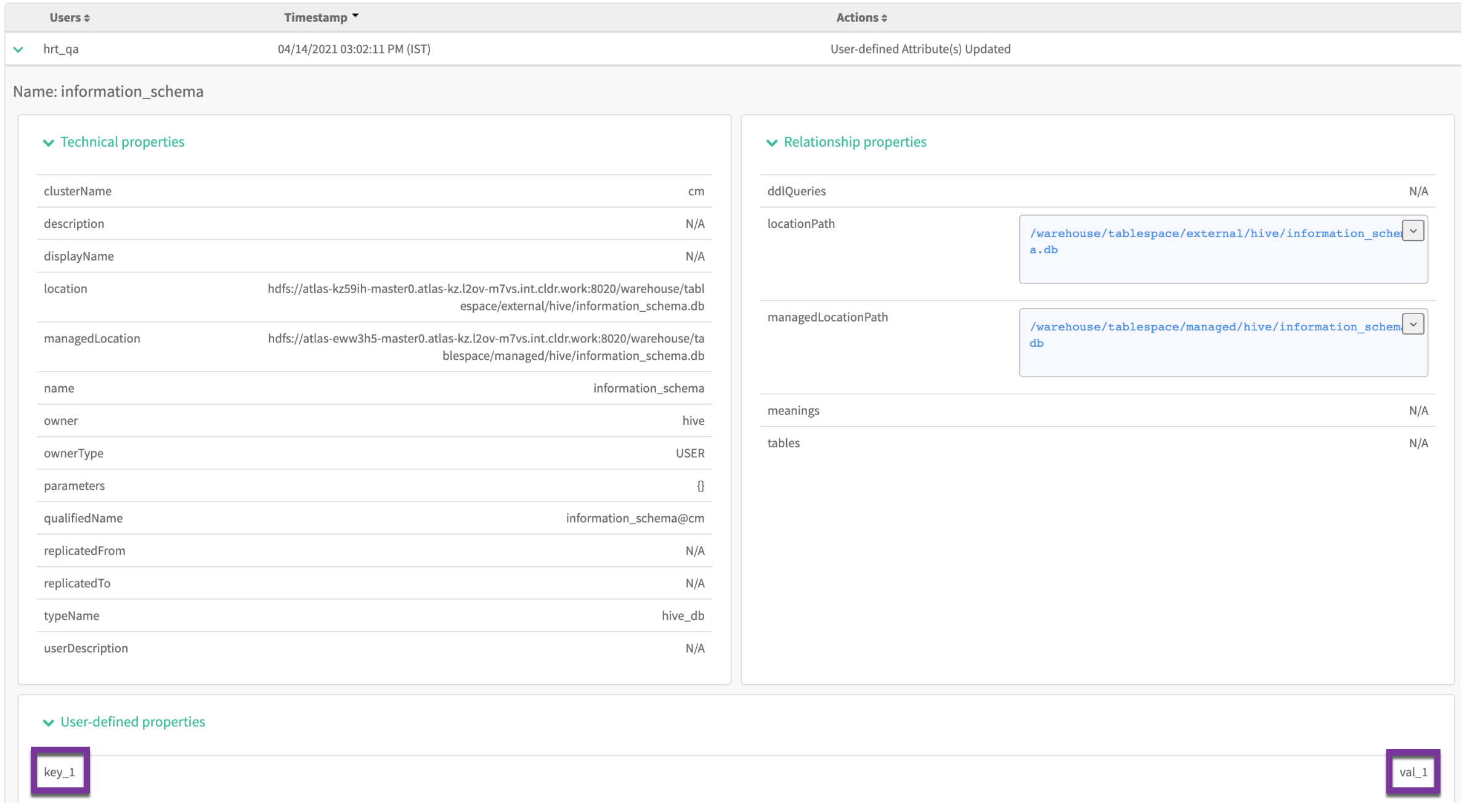

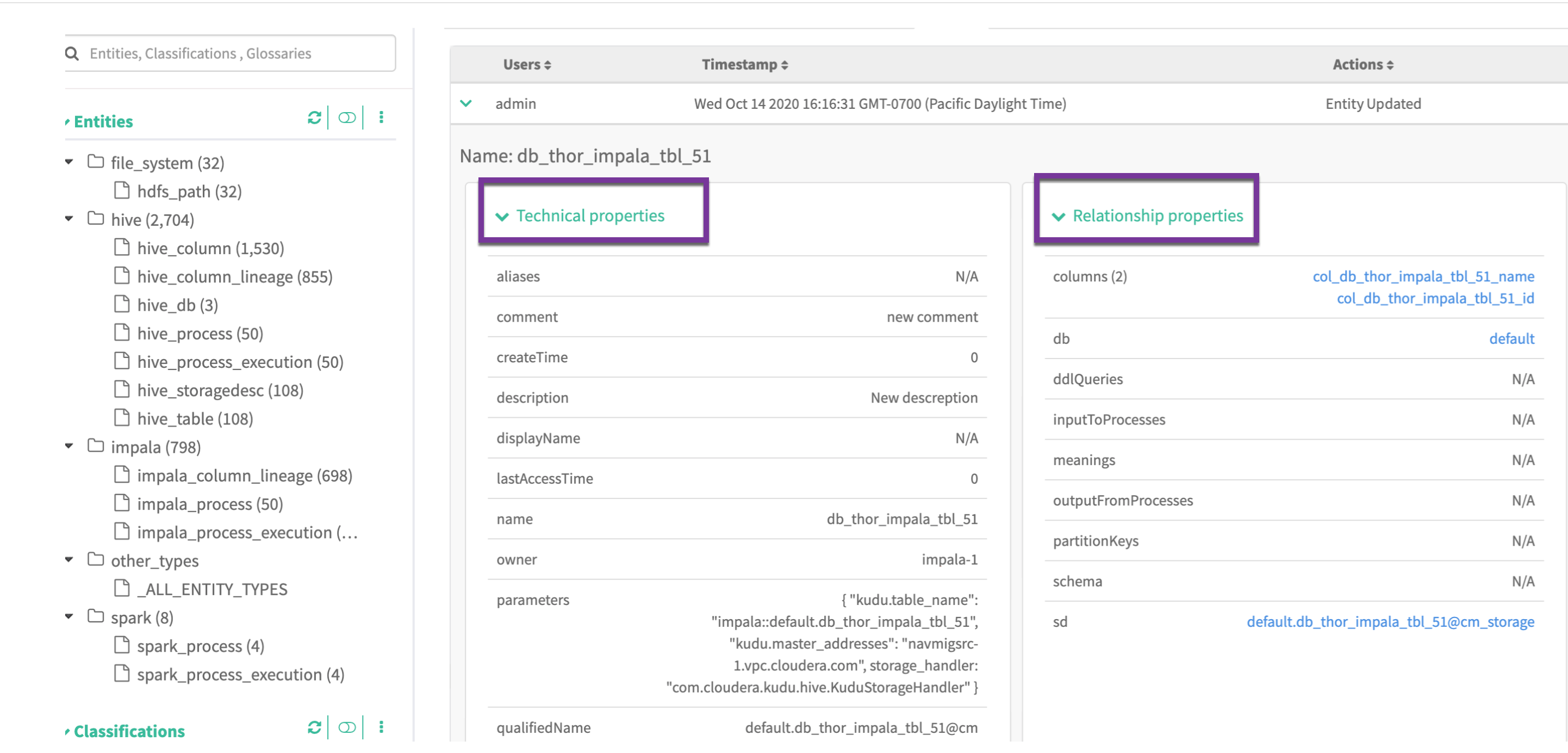

Previously, Atlas exhibited full entity as shown in the image:

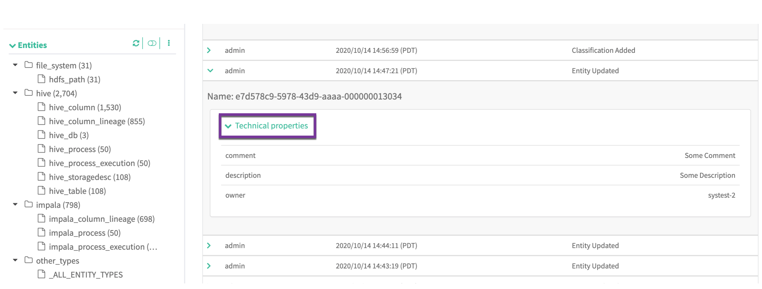

            Currently, Atlas displays only the differences between the original and updated entity state as shown in the image

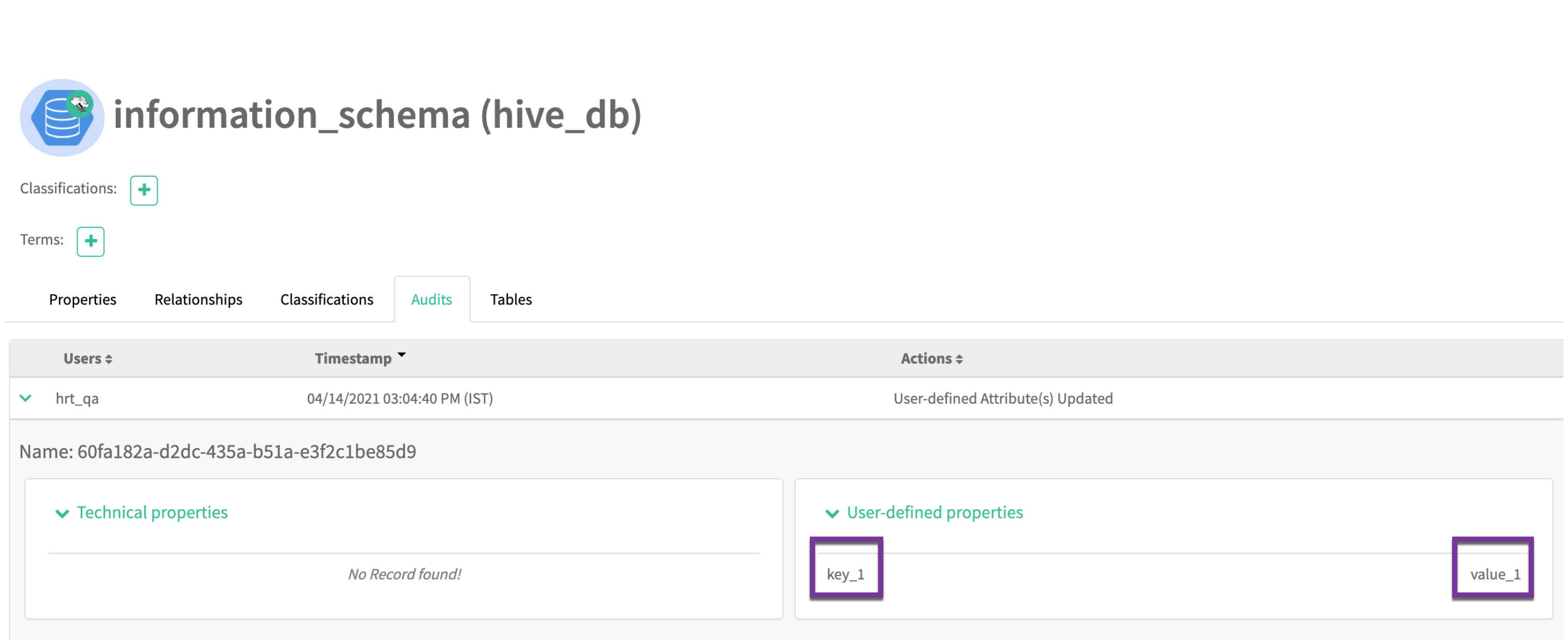

        As a use case, previously when you add data under user-defined-properties, for example, key_1 and val_1, Atlas displayed the same as seen in the image.
        Currently Atlas displays only the changed or updated entity values.
