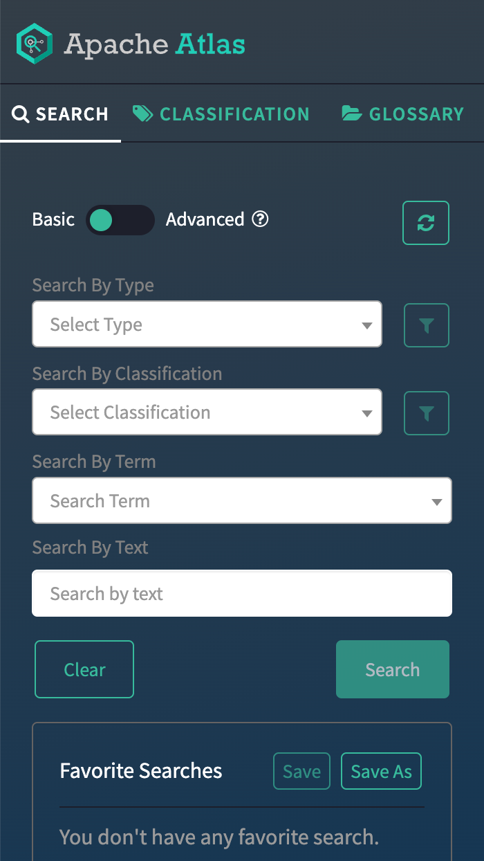

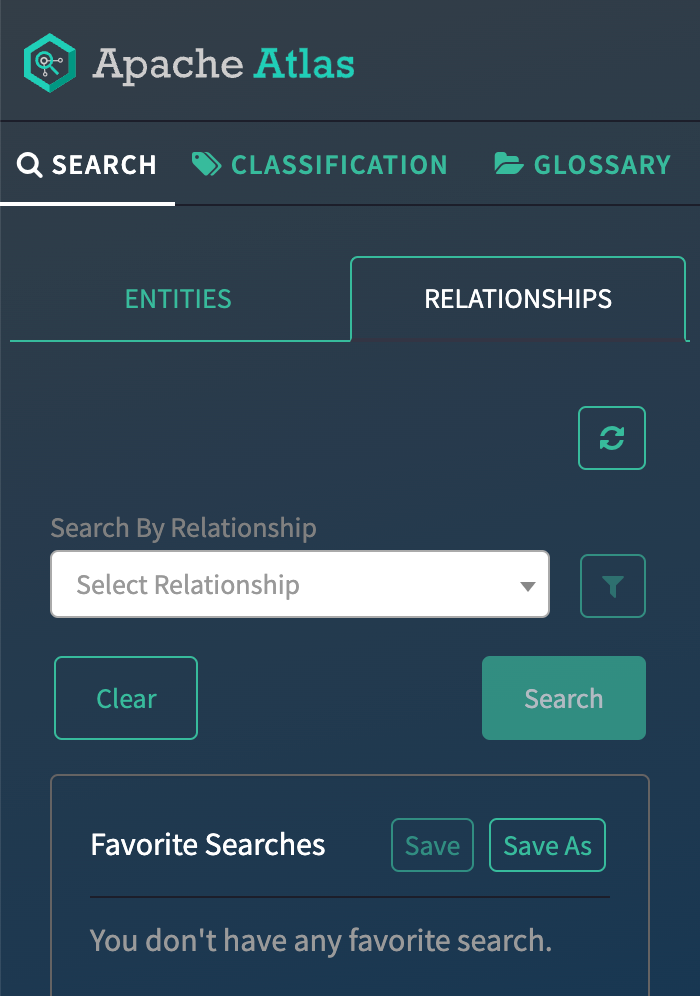

}]atlas.relationship.search.enabled property is set
        to true, you can switch between Entity Search and
          Relationship Search:

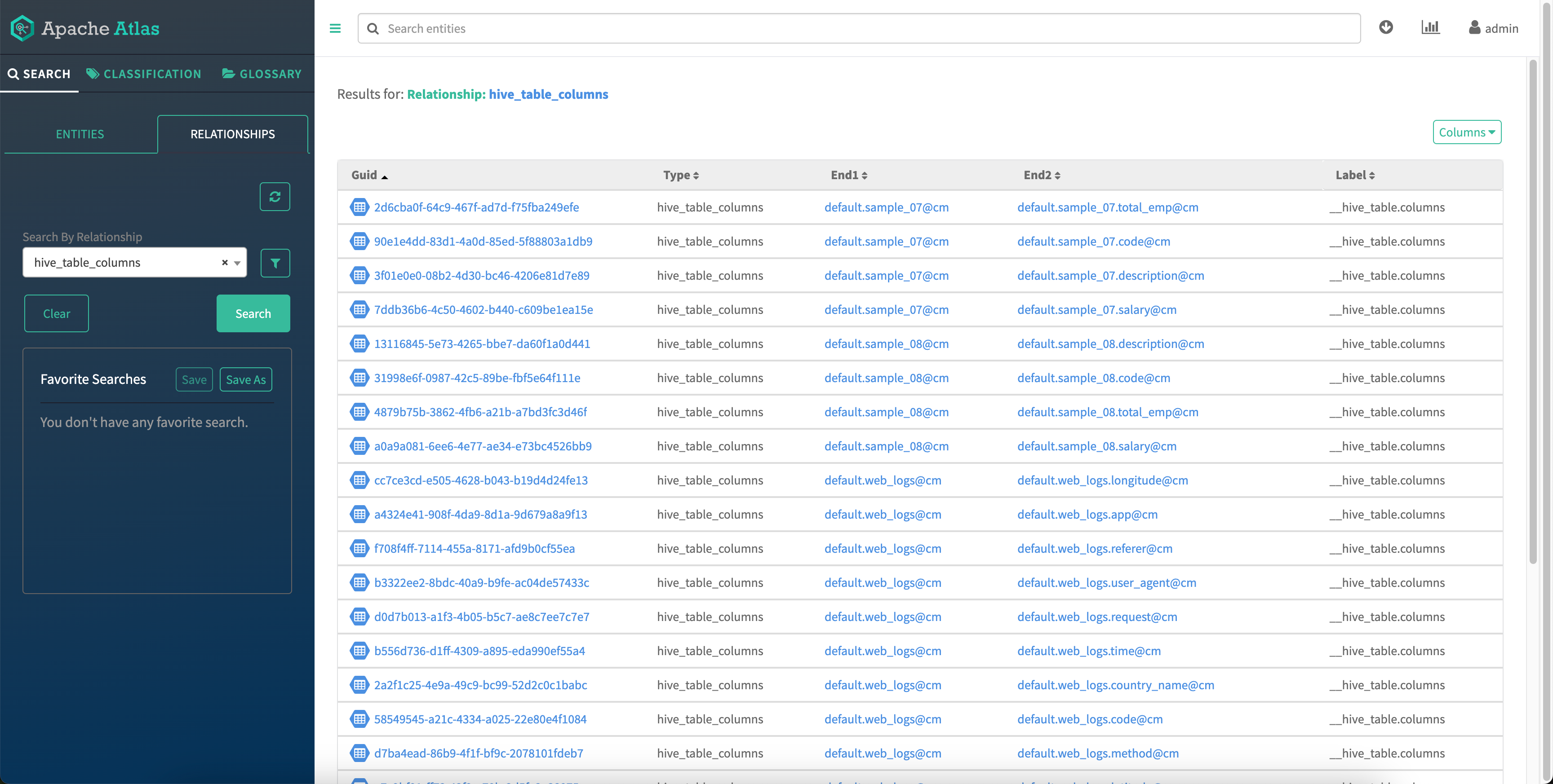

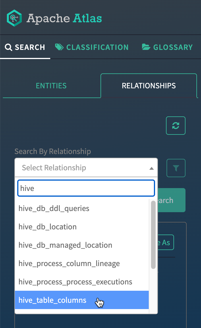

      You can search for the relationship using the drop-down list to select a relationship between entities and explore them in Atlas.
      The list of entities with the type hive_table_columns contains additional information about the connected entities.

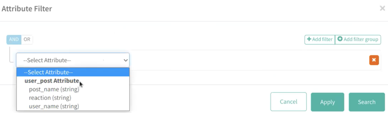

   You can add specific filters to search for relationship entities.

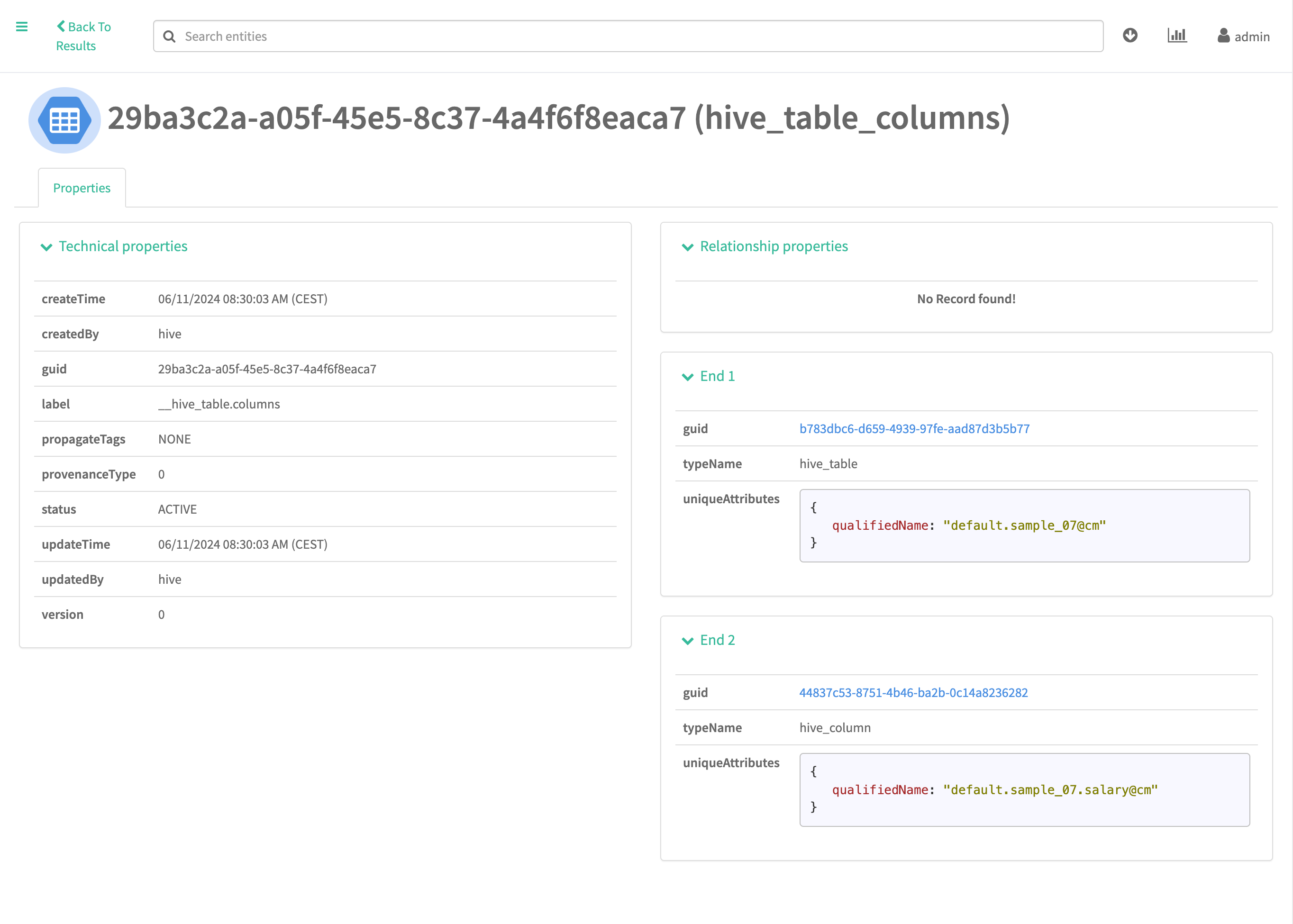

      In the example image, end 1 and end 2 are the entities with which the relationship is created.
   By clicking on each search result, you can navigate to the details page to view additional details and pertinent information.
