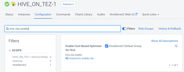

  1. In Cloudera Manager, click Clusters > Hive On Tez > Configuration.
  2. In the Configuration page, search for the hive.cbo.enable property.
    If the property is not visible in your version of Cloudera Manager, add the property to Hive site using the Cloudera Manager Safety Valve (see links below). Set the property to enabled.
  3. Accept the default (enabled), or check to enable the hive.cbo.enable property for the HiveServer Default Group.
