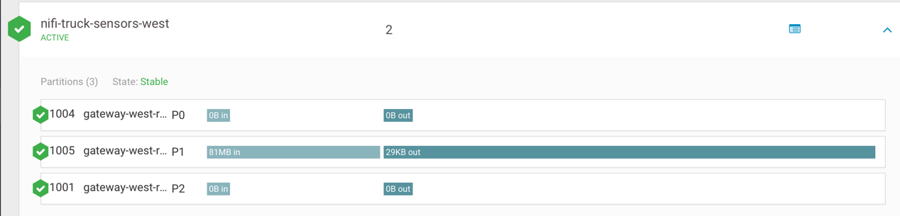

Viewing details about a consumer group
- From the left navigation pane, click Consumer Group.
- Identify the consumer group about which you want information. You can either scroll through the list of consumer groups, or use the Search bar at the top left of the page.
- Click the green hexagon at the left of the consumer group to view details.

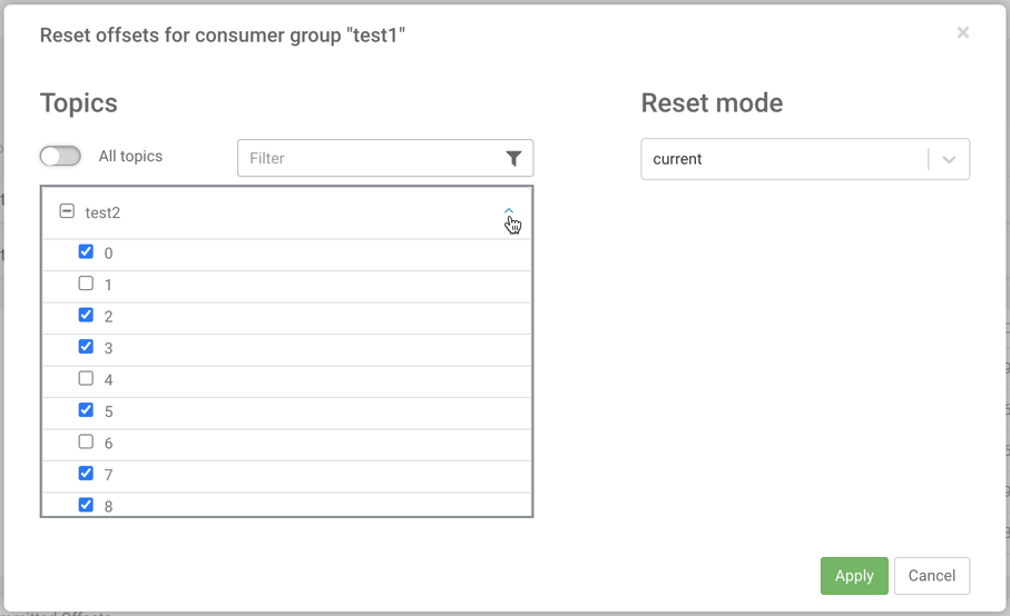

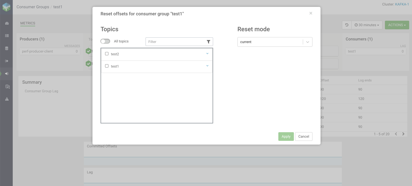

Resetting consumer offset
- Choose the consumer group for which you want to reset the offset, and click the
Profile icon.
- In the Metrics page, click .The Reset offsets for consumer group dialog appears.
- Select the topic and partition(s) you want to reset.You can use the arrow beside each topic to display the partitions of that topic, and select partition(s) as required. You can also select all topics and all related partitions by selecting the All topics option. You can use the Filter option to find a specific topic.
- Select the reset option from the Reset mode.The available options are as shown in the following image:
- Click Apply.
