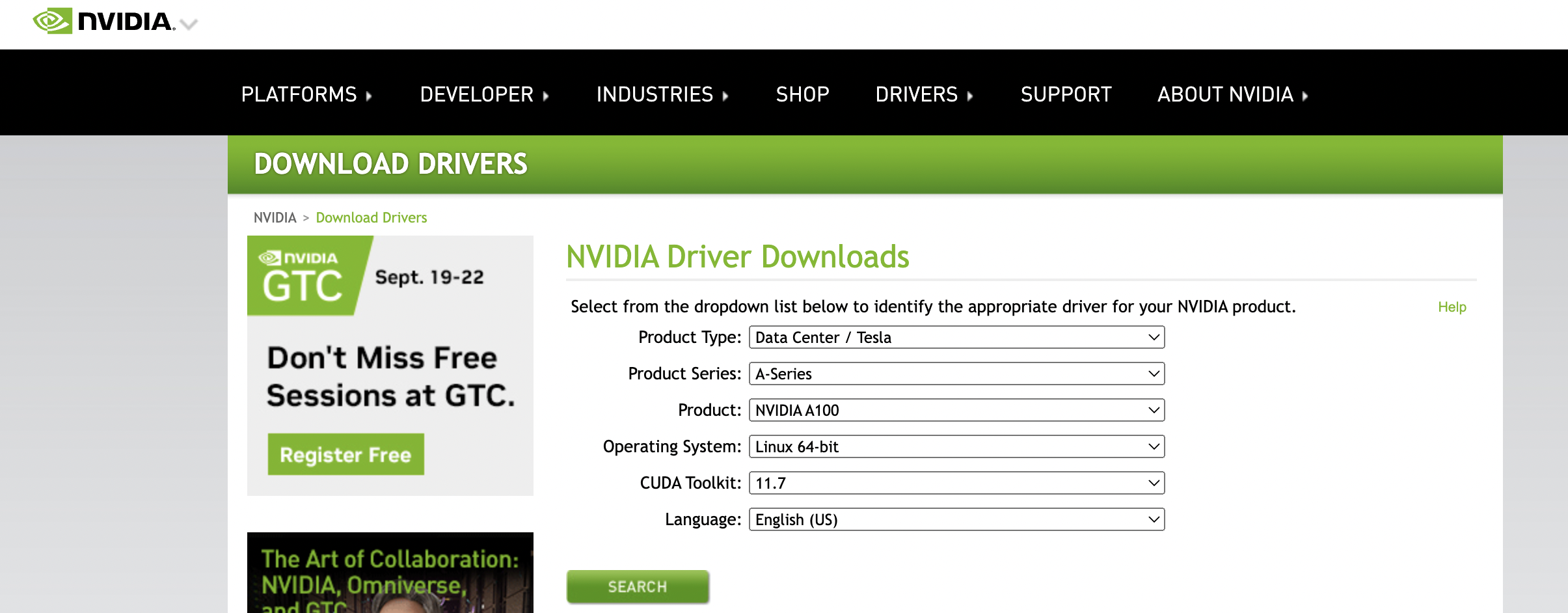

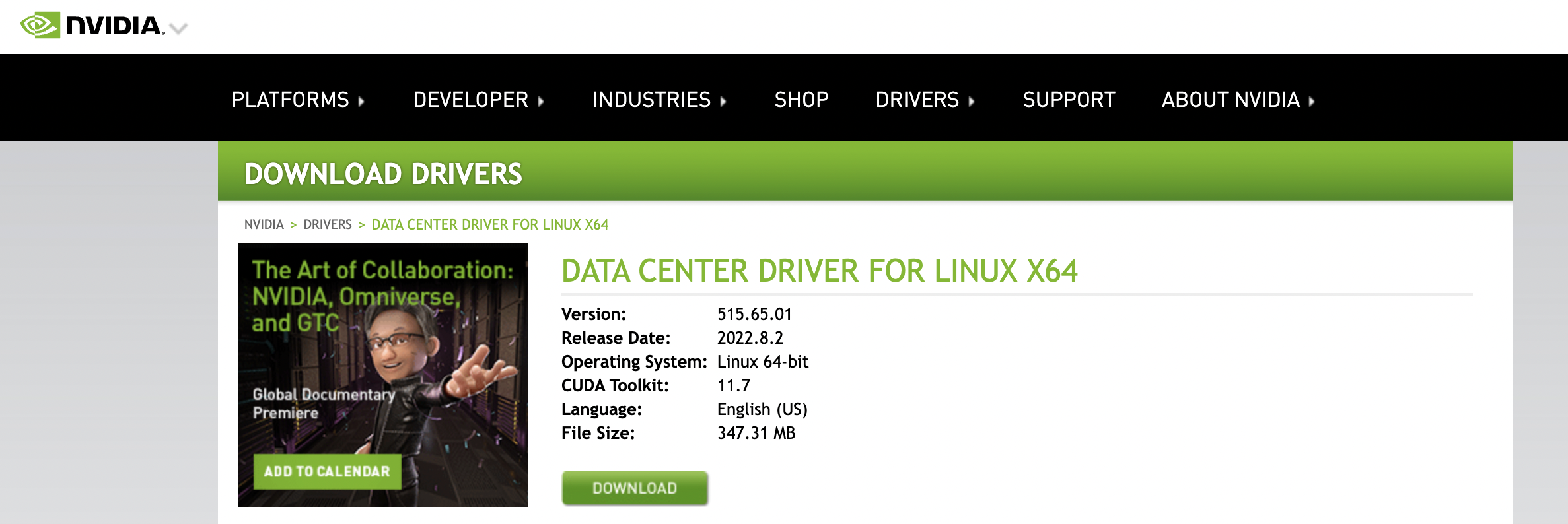

  1. Use the NVIDIA Driver Downloads page to determine the software driver version required for your NVIDIA GPU card. This example uses a NVIDIA A100 GPU card, which requires driver version 515.65.01.

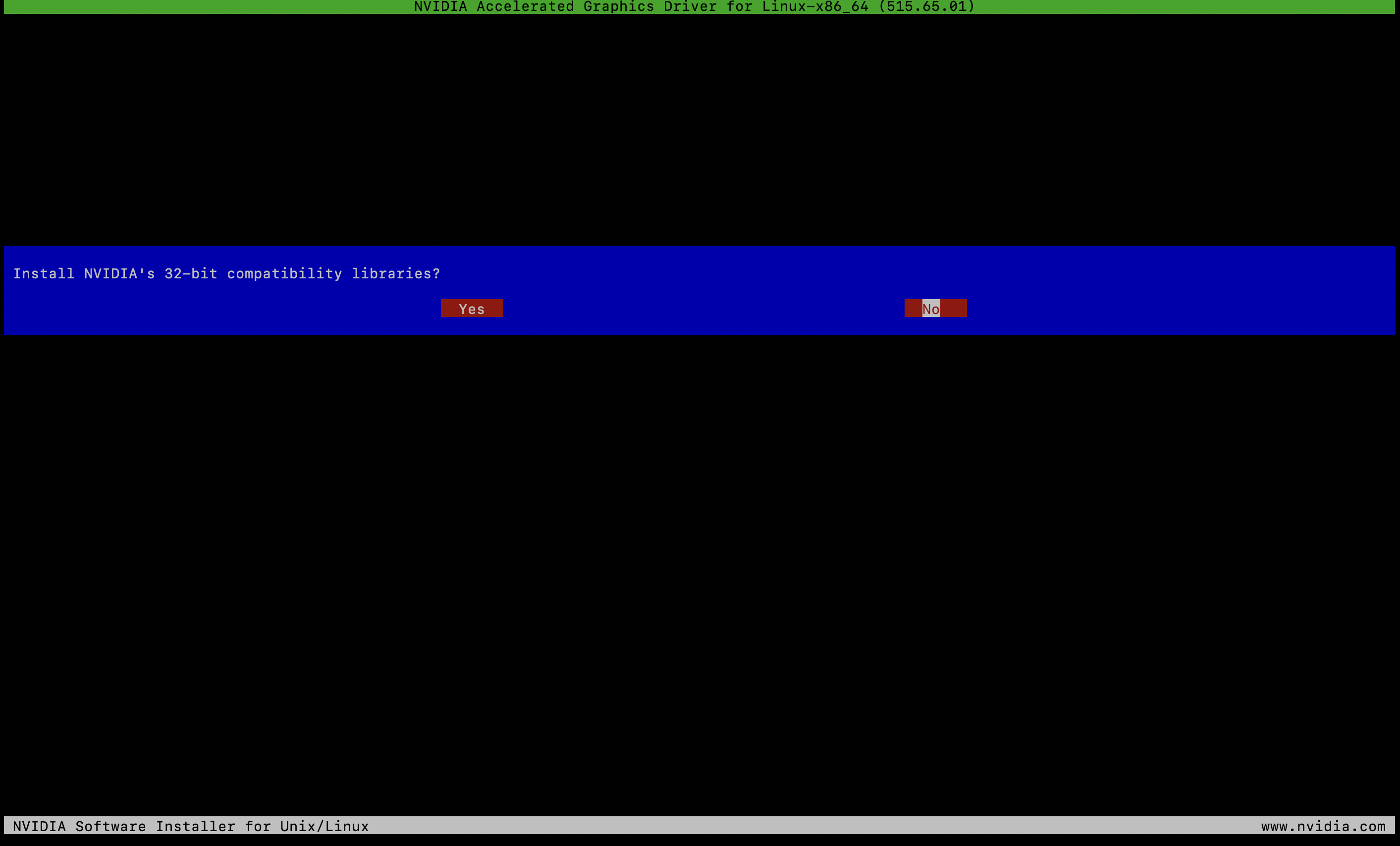

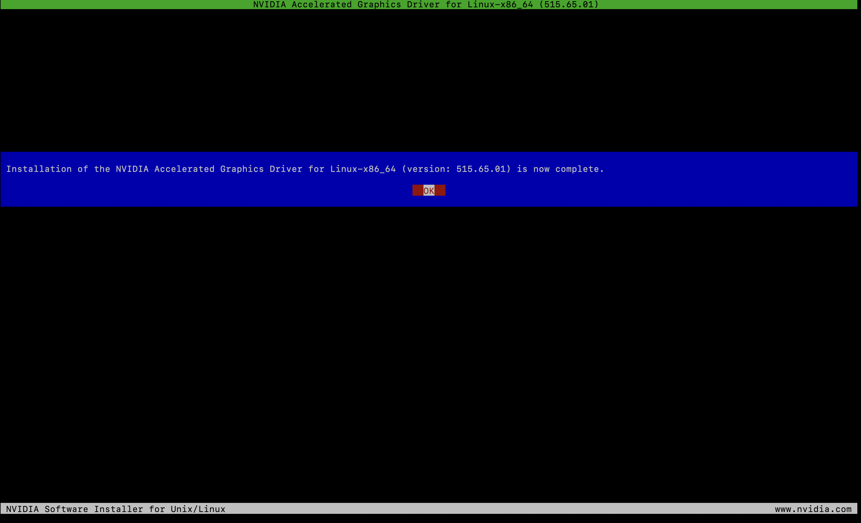

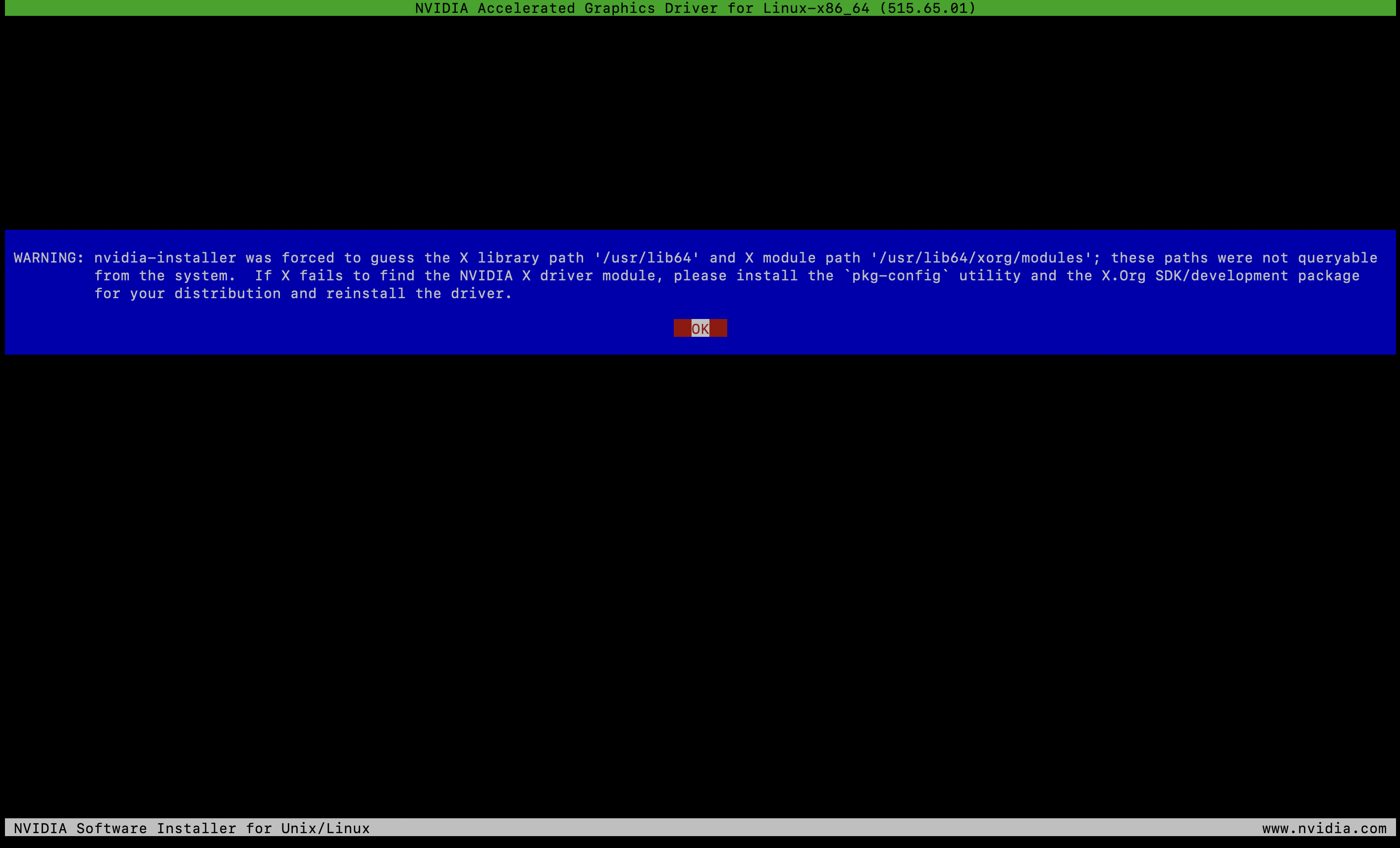

  4. Next, run the following commands to install the NVIDIA driver and nvidia-container-toolkit software:
    # BASE_URL=https://us.download.nvidia.com/tesla# DRIVER_VERSION=515.65.01
    # curl -fSsl -O $BASE_URL/$DRIVER_VERSION/NVIDIA-Linux-x86_64-$DRIVER_VERSION.run
    # sh NVIDIA-Linux-x86_64-$DRIVER_VERSION.run
  5. After the installation is complete, run the nvidia-smi tool and ensure that the driver was successfully deployed. The output should look similar to the following example:

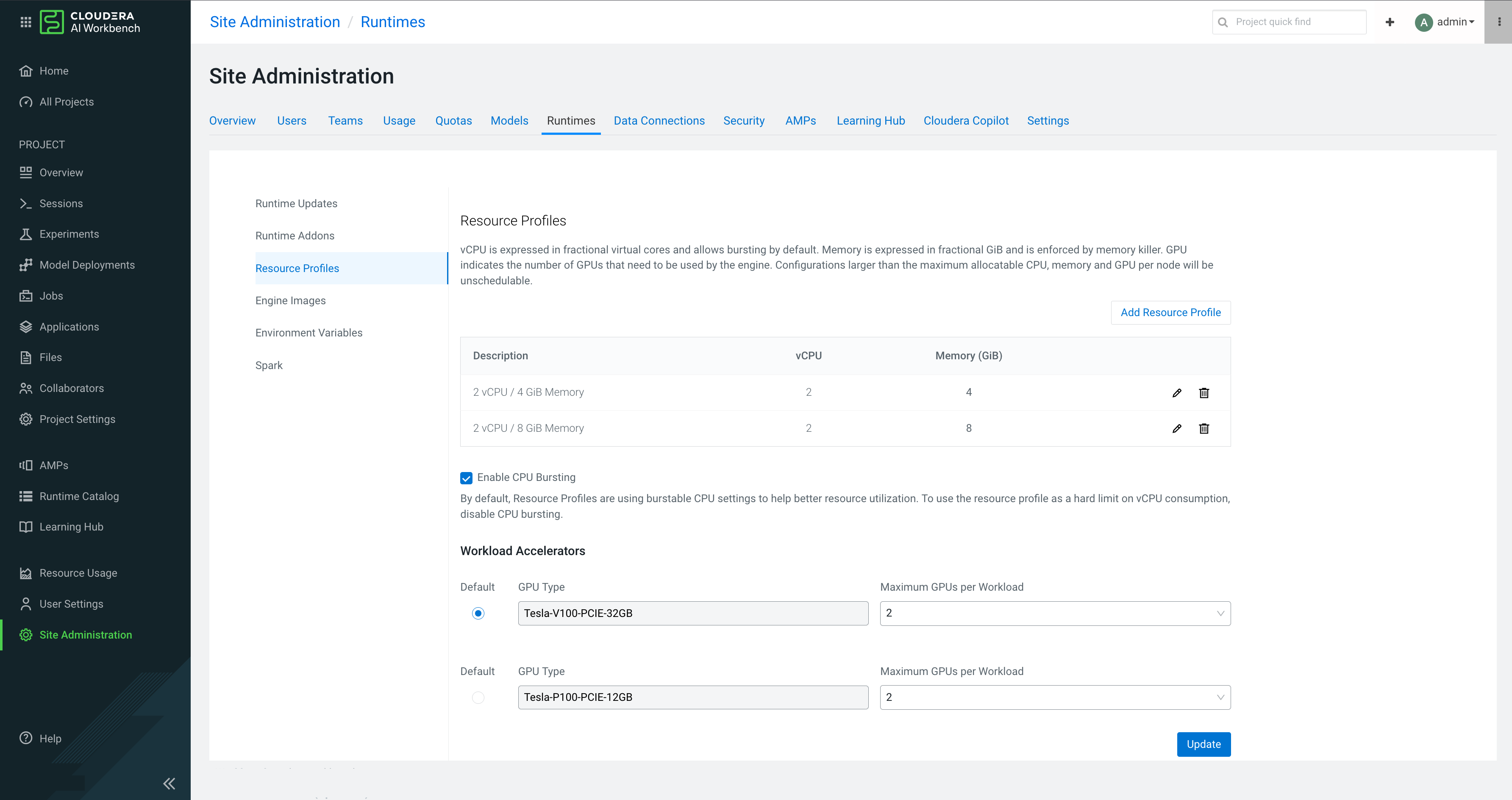

  2. In the Cloudera Data Services on premises Cloudera AI Workbench, select Site Administration > Runtimes > Resource Profiles. Specify the default GPU Type and the number of GPUs that can be used for a given workload. This procedure enables the Cloudera AI session to effectively utilize the GPU card.

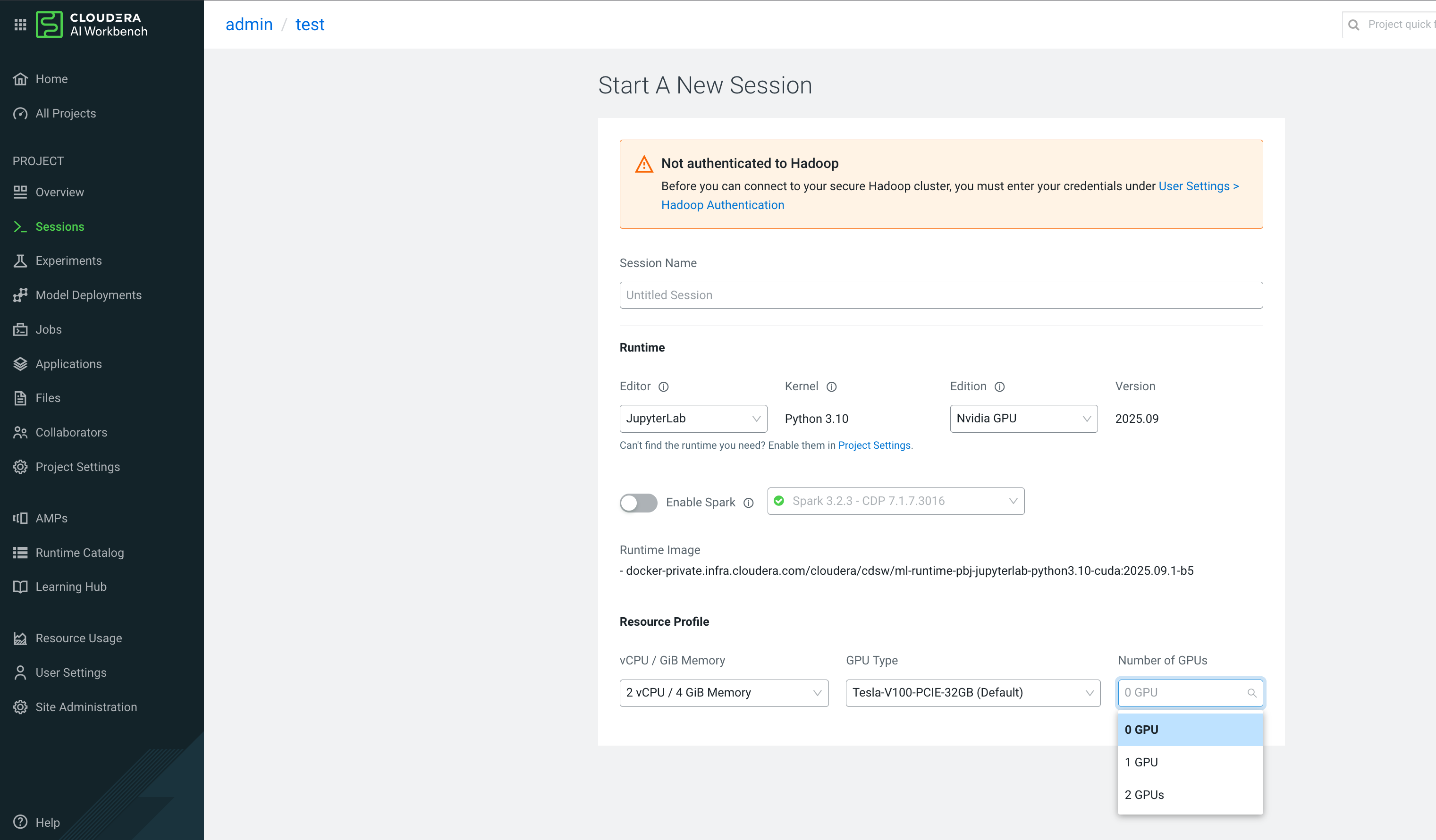

  3. Create a Cloudera AI project and start a new session by selecting the Workbench editor with a Python kernel and a NVIDIA GPU edition. Specify the GPU Type and number of GPUs to use. If the number of GPUs is 0, then the session will not consume any GPU.

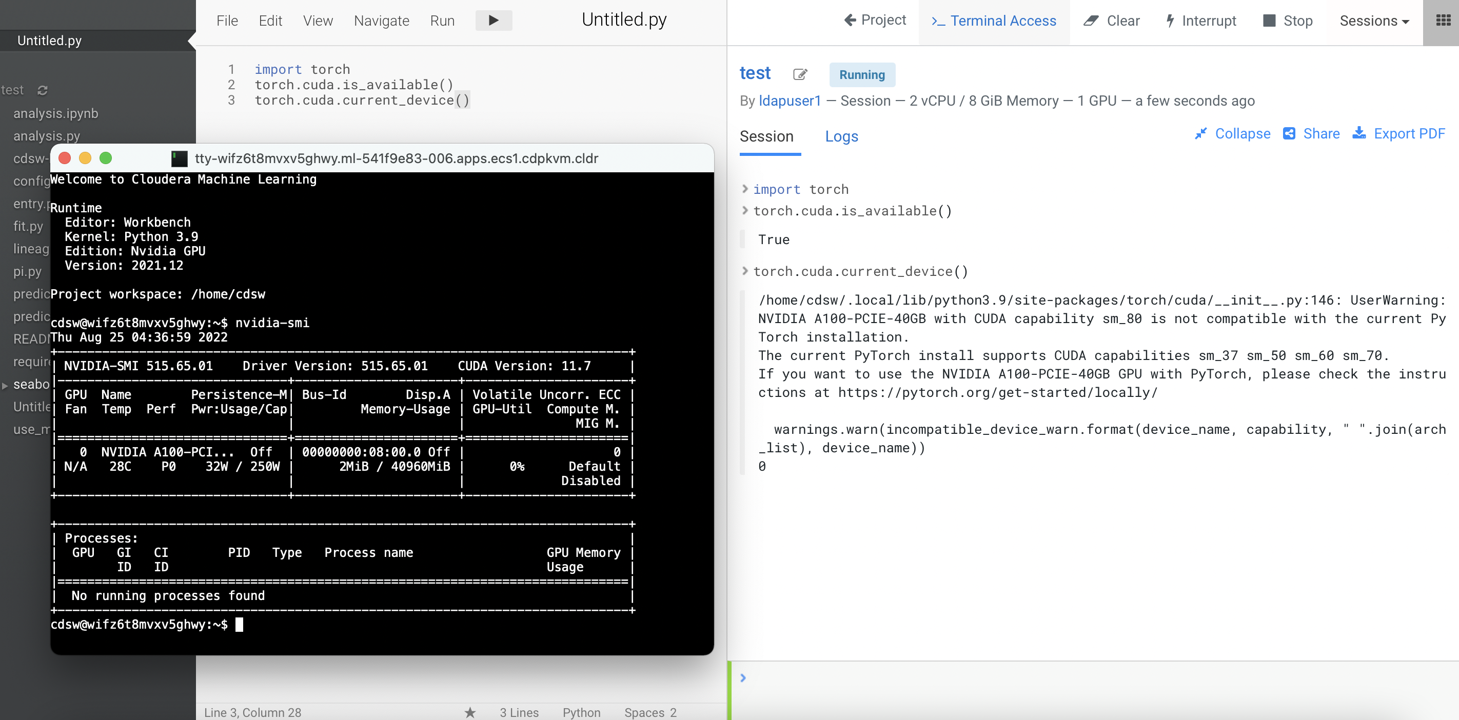

  4. Create a new Python file and run the following script. Also, open the terminal session and run the nvidia-smi tool. Note that the output shows the NVIDIA GPU card details.
    !pip3install torchimport torchtorch.cuda.is_available()torch.cuda.device_count()torch.cuda.get_device_name(0)

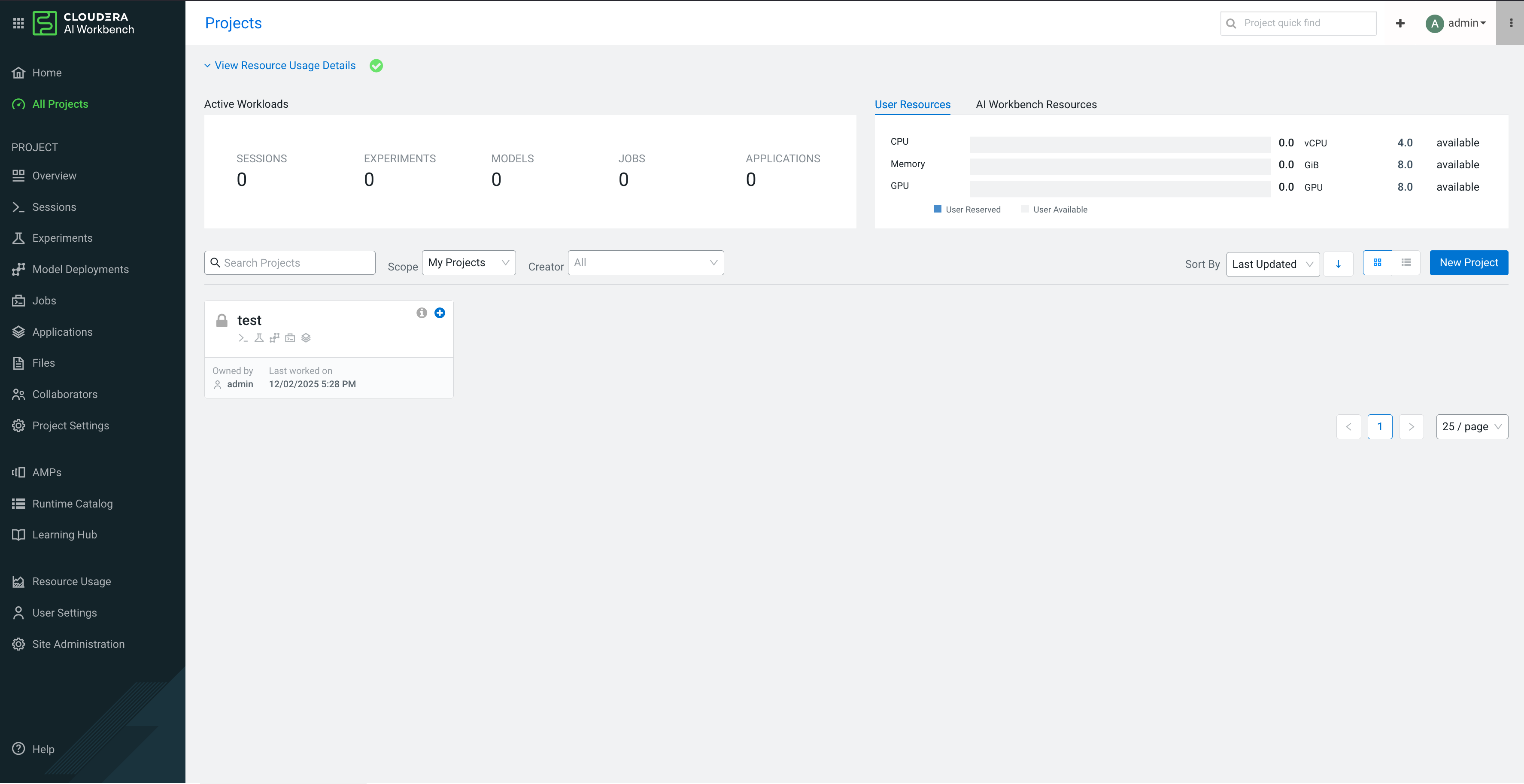

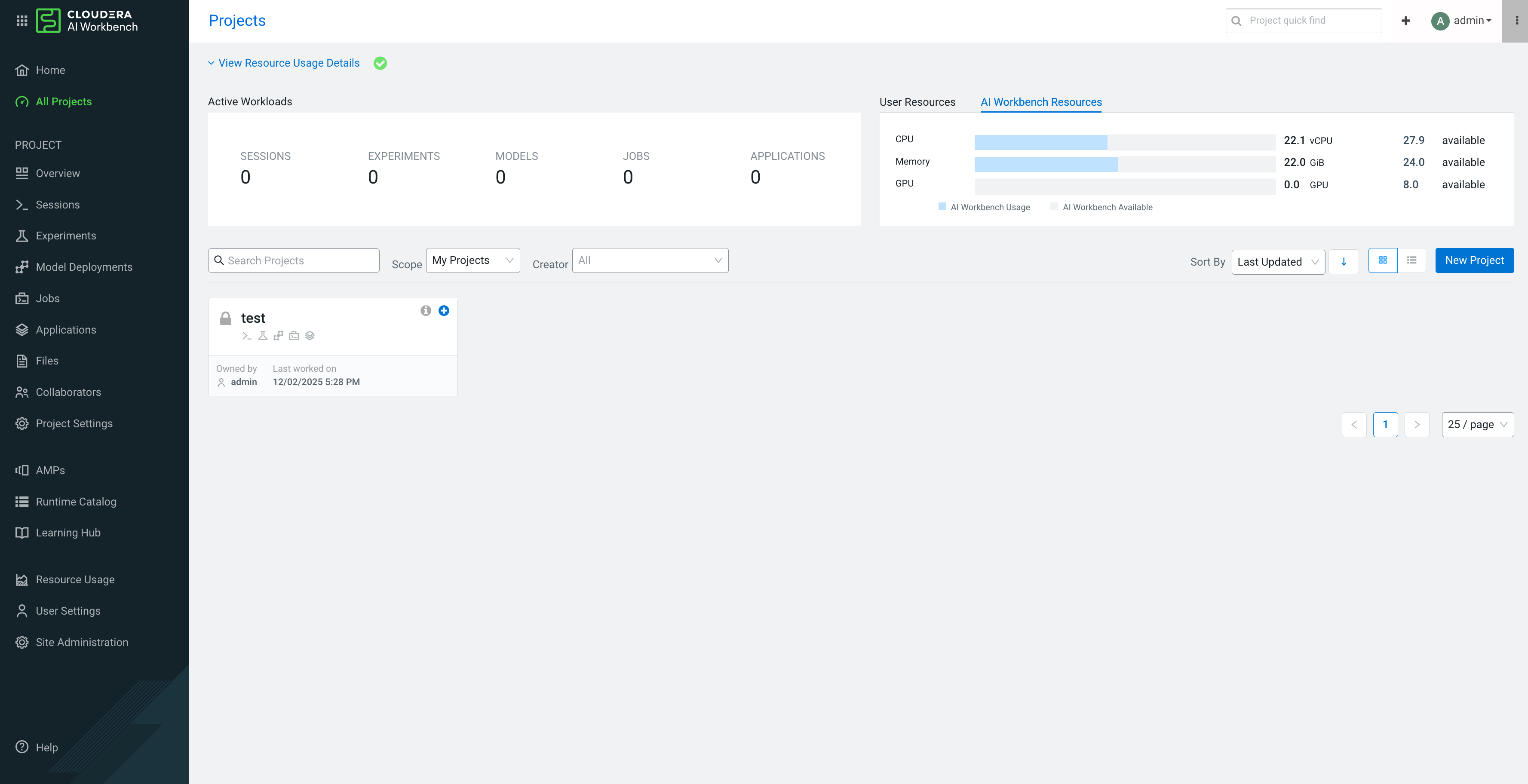

  5. Navigate to the Cloudera AI Projects page and confirm that the User Resources dashboard displays the GPU card availability.

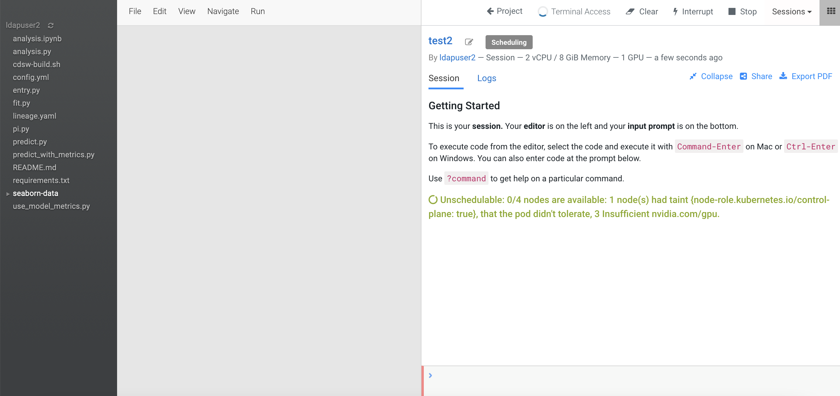

  8. In the event that the ECS platform has no available worker node with a GPU card, provisioning a session with GPU will result in a Pending state as the system is looking for a worker node installed with at least one NVIDIA GPU card.
