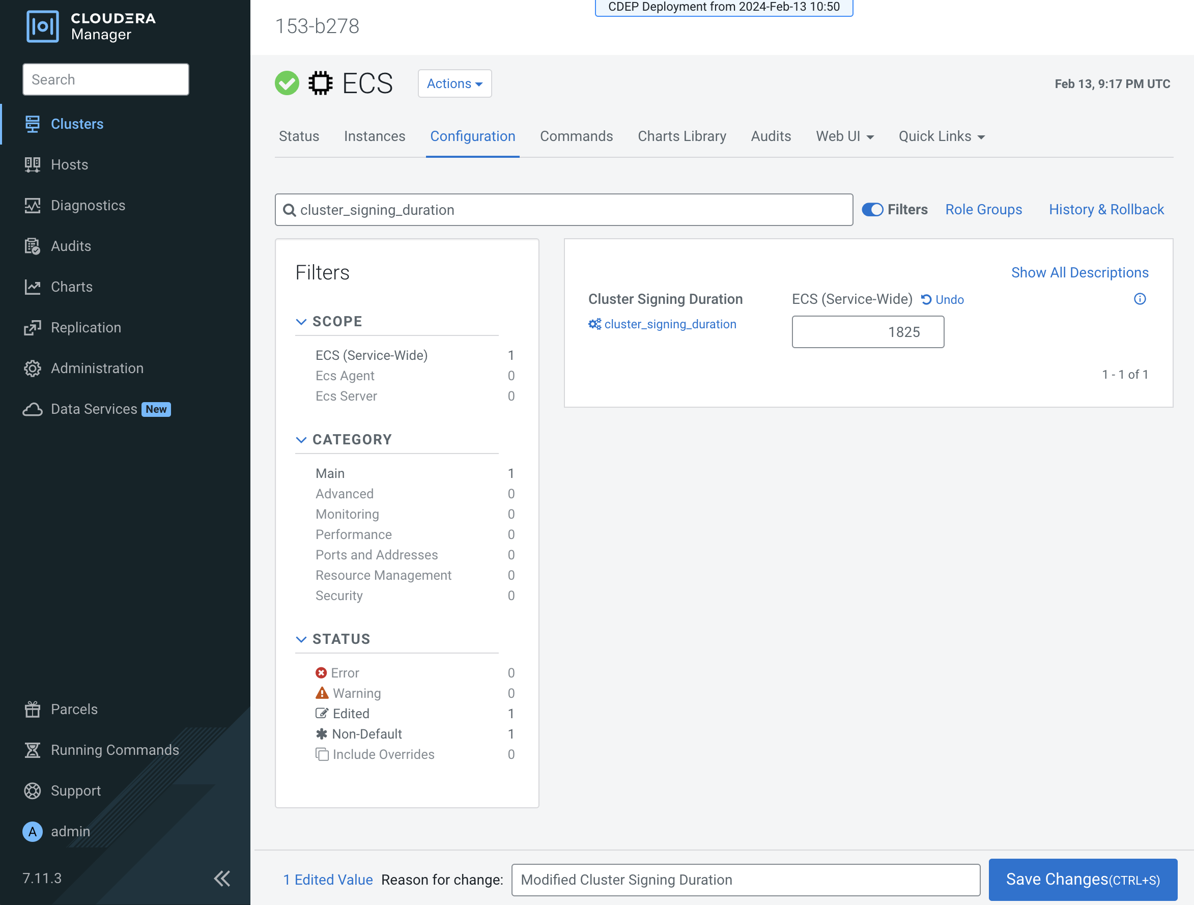

  2. Click the Configuration tab, then use the Search box to locate the cluster_signing_duration configuration property.
  3. The cluster_signing_duration configuration property sets the expiration time for the RKE Kubernetes, Vault, and ECS webhook certificates, and is set to 1 year (365 days) by default. In the example below, the certificate expiration has been reset to 5 years (1825 days):
  4. Click Save Changes.
  3. The the cluster_signing_duration configuration property sets the expiration time for the RKE Kubernetes, Vault, and ECS webhook certificates, and is set to 1 year (365 days) by default. In the example below, the certificate expiration has been reset to 5 years (1825 days):
