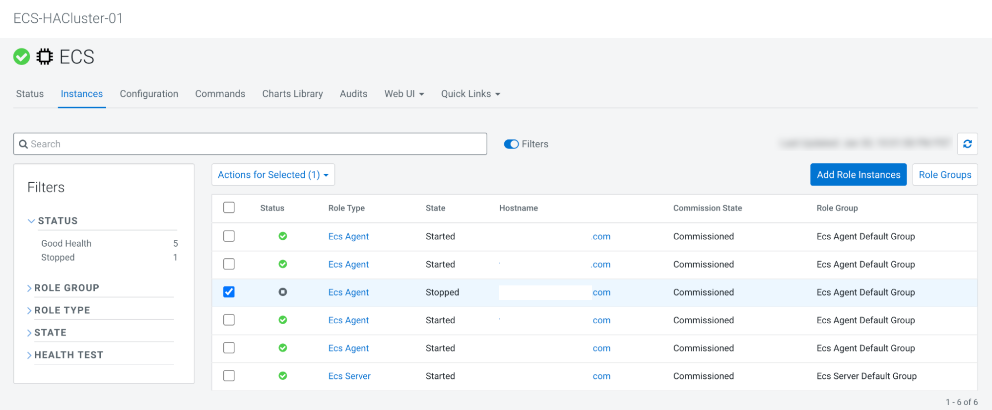

  1. In Cloudera Manager, select the Cloudera Embedded Container Service cluster, then click ECS. Stop the ECS Agent running on agent1 and then delete the agent.

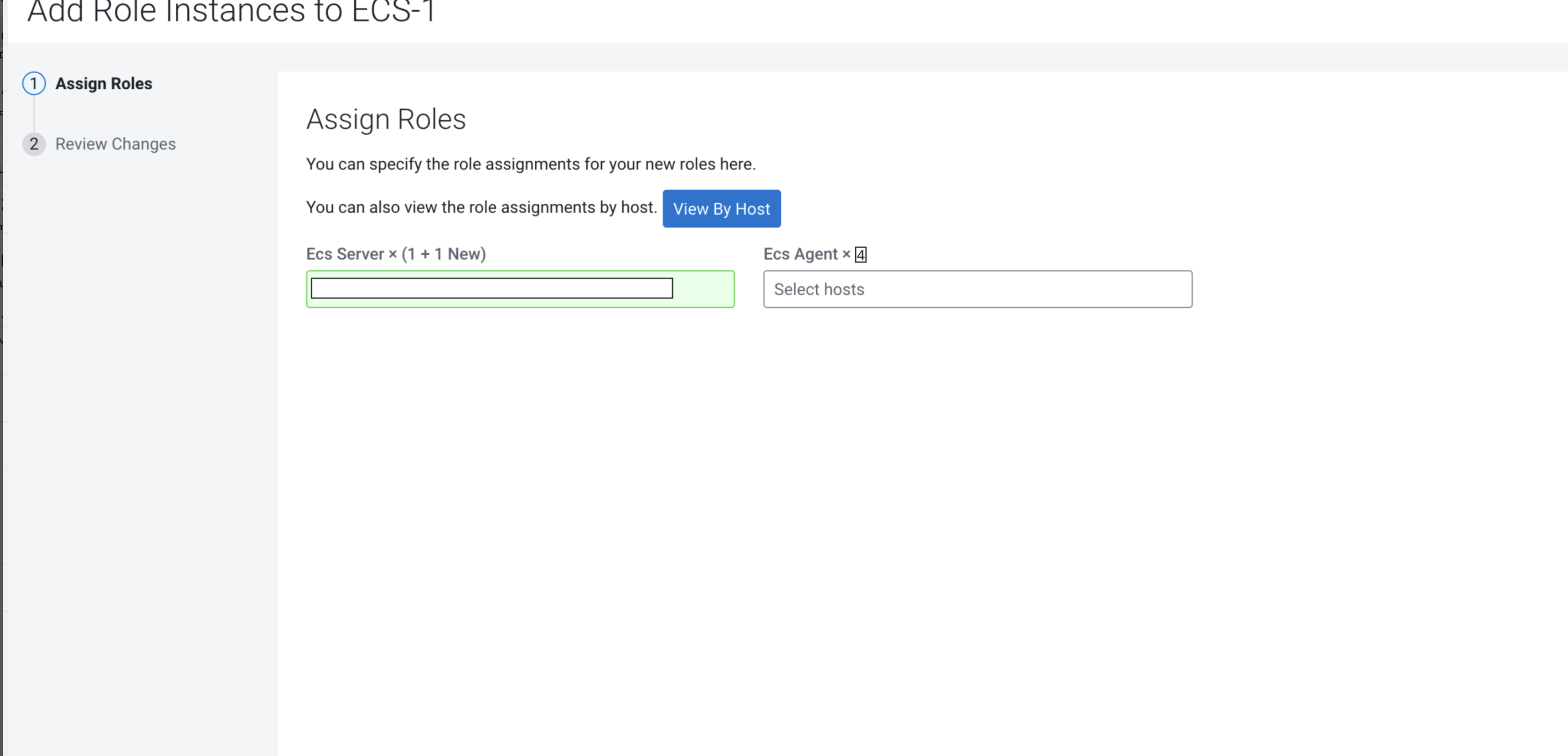

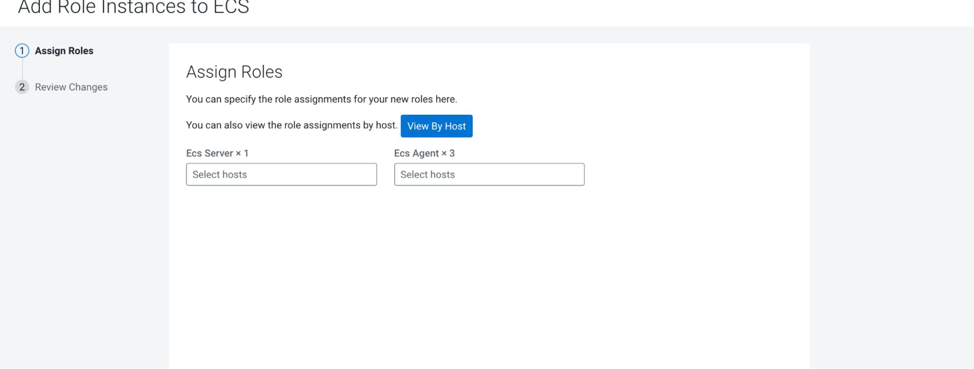

  2. In ECS, click Add Role Instances.

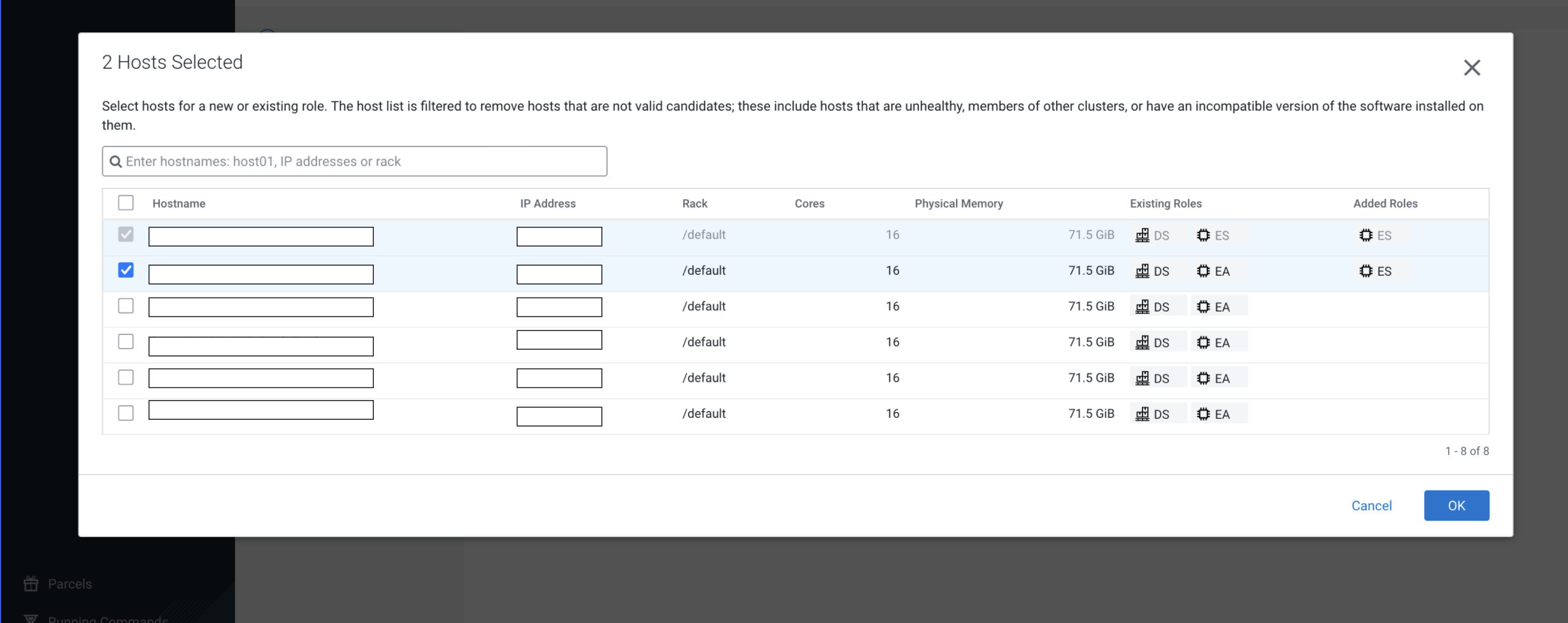

  3. Select the available host as an Cloudera Embedded Container Service server and then select the Add Role Instances to ECS in the pop-up. Click OK.
  4. Click Continue.

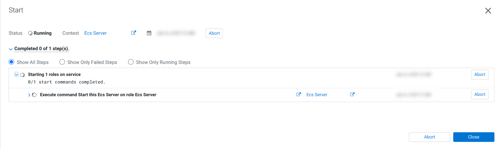

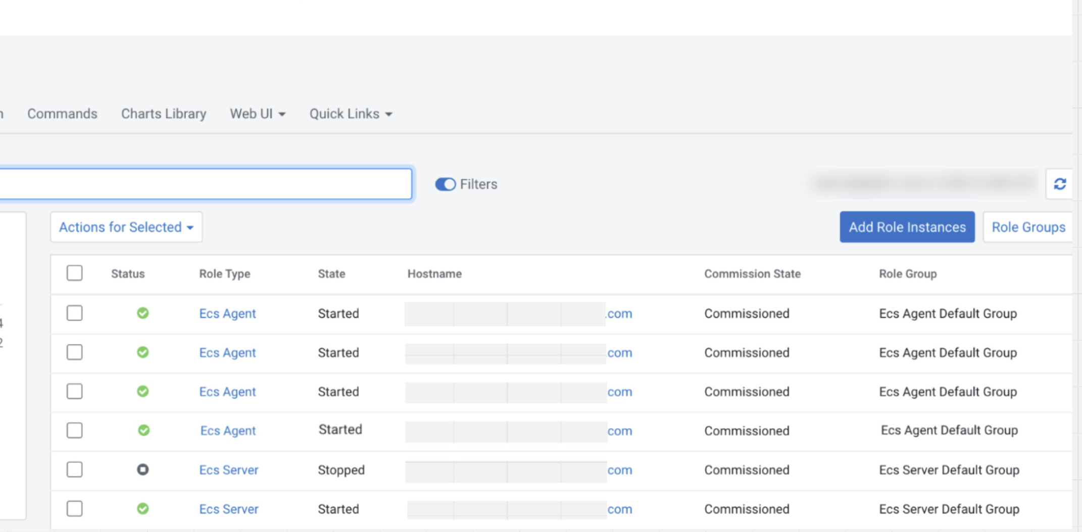

  5. Start the new ECS server from the ECS Instances view. For example, start the ECS Server on agent1.

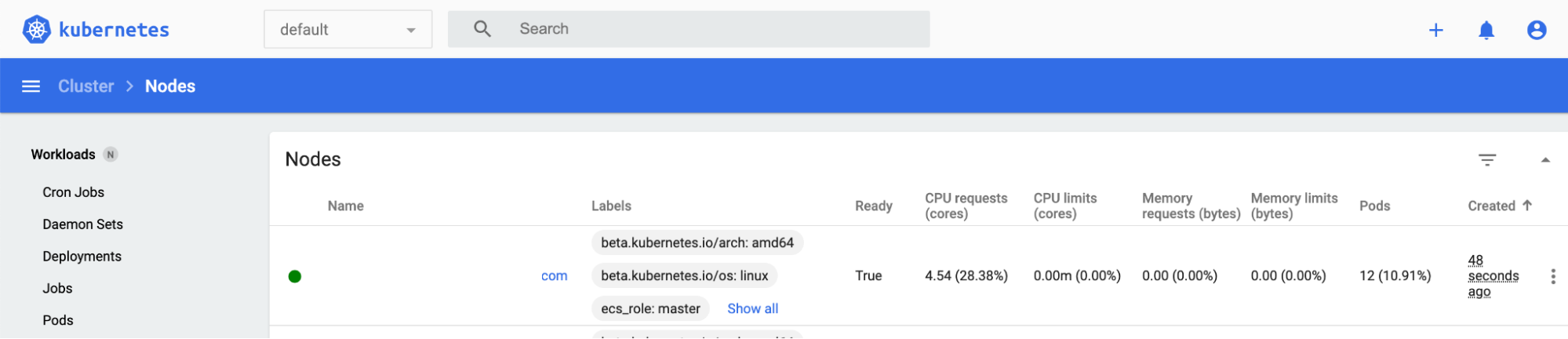

  6. Confirm the node’s status from the Web UI or the command line by running the following command:
    sudo /var/lib/rancher/rke2/bin/kubectl --kubeconfig=/etc/rancher/rke2/rke2.yaml get nodes
When agent1 is ready, you can promote agent2. To promote agent2, perform steps 1-8 again using agent2.example.com.
