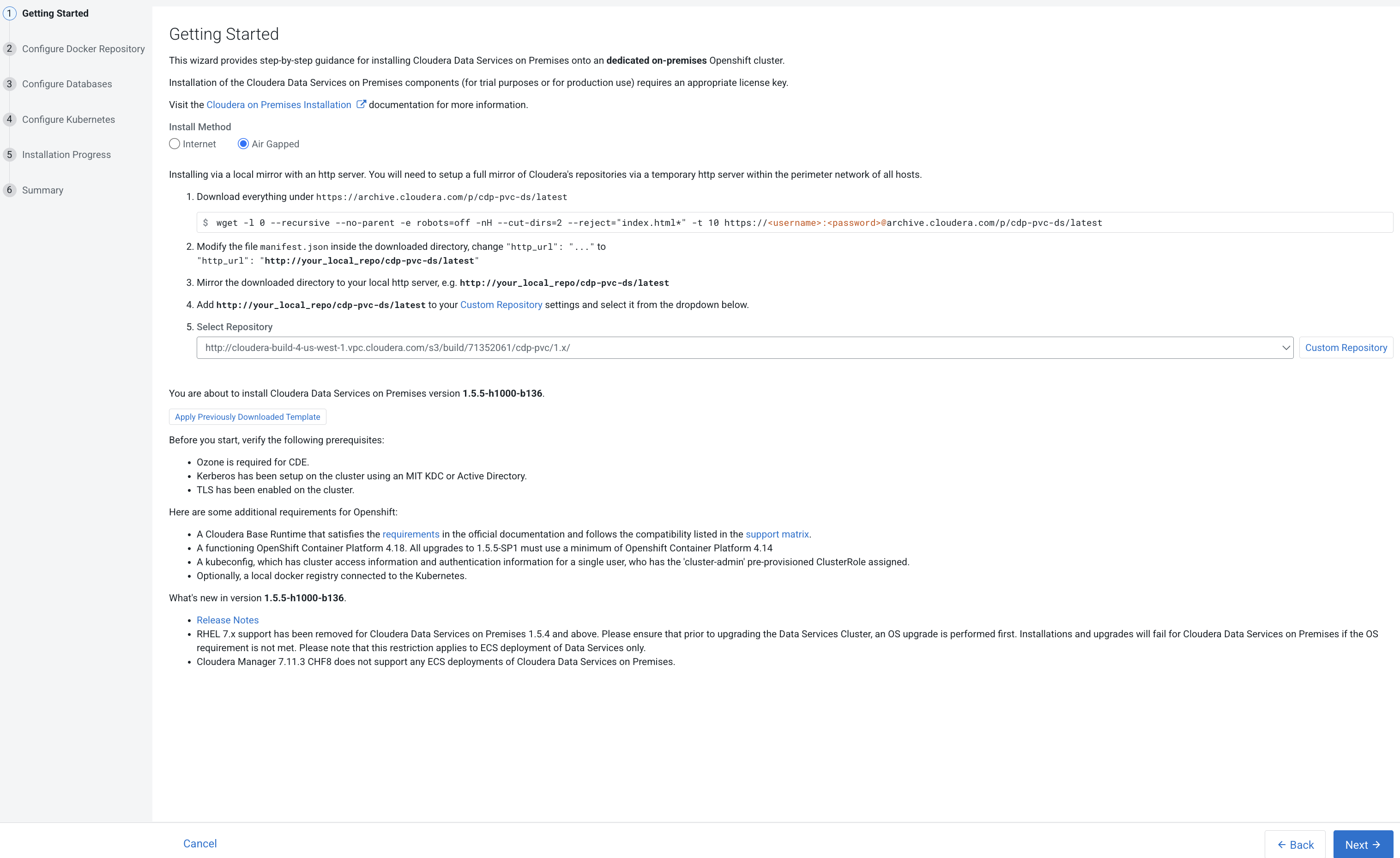

  1. In Cloudera Manager, on the top right corner, click Add > Add Cluster. The Select Cluster Type page appears.
  2. On the Select Cluster Type page, select the cluster type as on premises Containerized Cluster. Under Other Options, click here to install Cloudera Data Services on premises. Click Continue.
  3. On the Getting Started page of the installation wizard, select Air Gapped as the Install Method. When you select the Air Gapped install option, extra steps are displayed. Follow these steps to download the Cloudera Data Services on premises deliverables .
    1. Offline download everything under the release you have been asked to download with the below command: LINK=https://<username>:<password>@archive.cloudera.com/p/cdp-pvc-ds/ && echo "$LINK$(curl -I "$LINK/latest/" 2>/dev/null | grep location | awk '{print $2}' | awk -F'/' '{print $4}')/" |xargs wget -l 0 --recursive --no-parent -e robots=off -nH --cut-dirs=2 --reject="index.html*" -t 10
      In the above command, replace username, password as provided by Cloudera.
    2. Once you have all the needed files, create on your local http server a new folder (parallel to the folders of the Cloudera Manager and the CDH releases) as follows (example given for the 1.5.4-h4 release):
      sudo mkdir -p
      /var/www/html/cloudera-repos/cdp–pvc-ds/1.5.4-h4
    3. In case needed, pass the files to the customer for approval, and once they are approved, ask the customer to place them in the target folder created above (or into the customer organizational repository in case such is used). Once the files were moved into the folder, ensure that they have the same permissions as the cm7 files by running (example given for the 1.5.4-h4 release):
      sudo chmod -R 755
      /var/www/html/cloudera-repos/cdp-pvc-ds/1.5.4-h4
    4. Visit the Repository URL: http:///cloudera-repos/ in your browser and verify the files you downloaded are present. If you do not see anything, your web server may have been configured to not show indexes.
    5. Click the Select Repository drop-down and select http://your_local_repo/cdp-pvc-ds/1.5.4-h4 (example given for the 1.5.4-h4 release)
    6. Click Next.

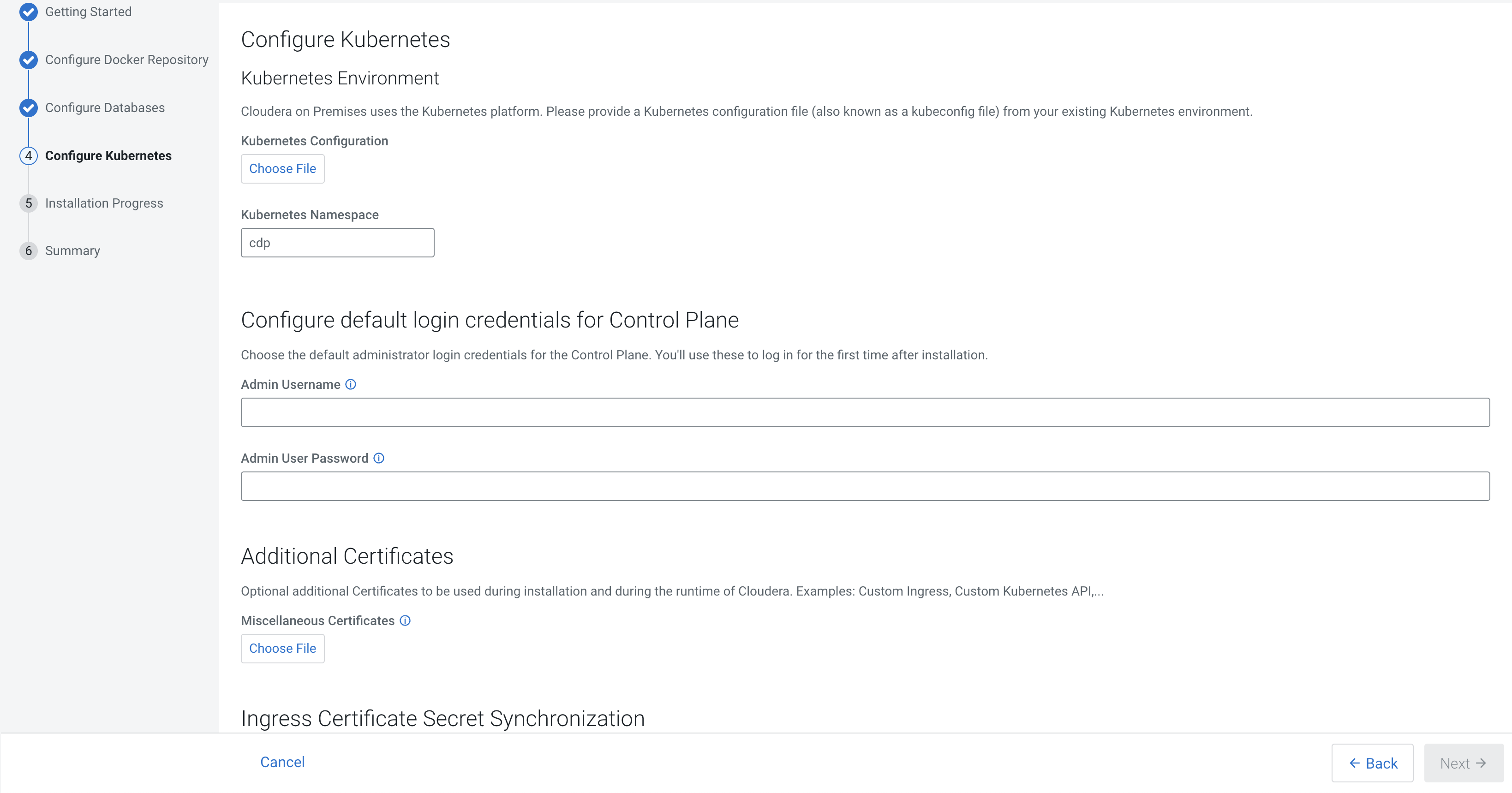

  6. On the Configure Kubernetes page, enter your Kubernetes, Docker, database, and vault information.
    1. Upload a Kubernetes configuration (kubeconfig) file from your existing environment. You can obtain this file from your OpenShift Container Platform administrator. Ensure that this kubeconfig has permissions to create Kubernetes namespaces.
    2. In the Kubernetes Namespace field, enter the Kubernetes namespace that you want to use with this Cloudera on premises deployment. Kubernetes virtual clusters are called namespaces. For more information, see Kubernetes namespaces
    3. Enter your Vault information and upload a CA certificate. Cloudera recommends that you use an external Vault for production environments. Enter the Vault address and token, and upload a CA certificate.
    4. Enter a Block Storage Class to be configured on the Kubernetes cluster. Cloudera on premises uses Persistent Volumes to provision storage. You can leave this field empty if you have a default storage class configured on your Openshift cluster. Click Continue.
