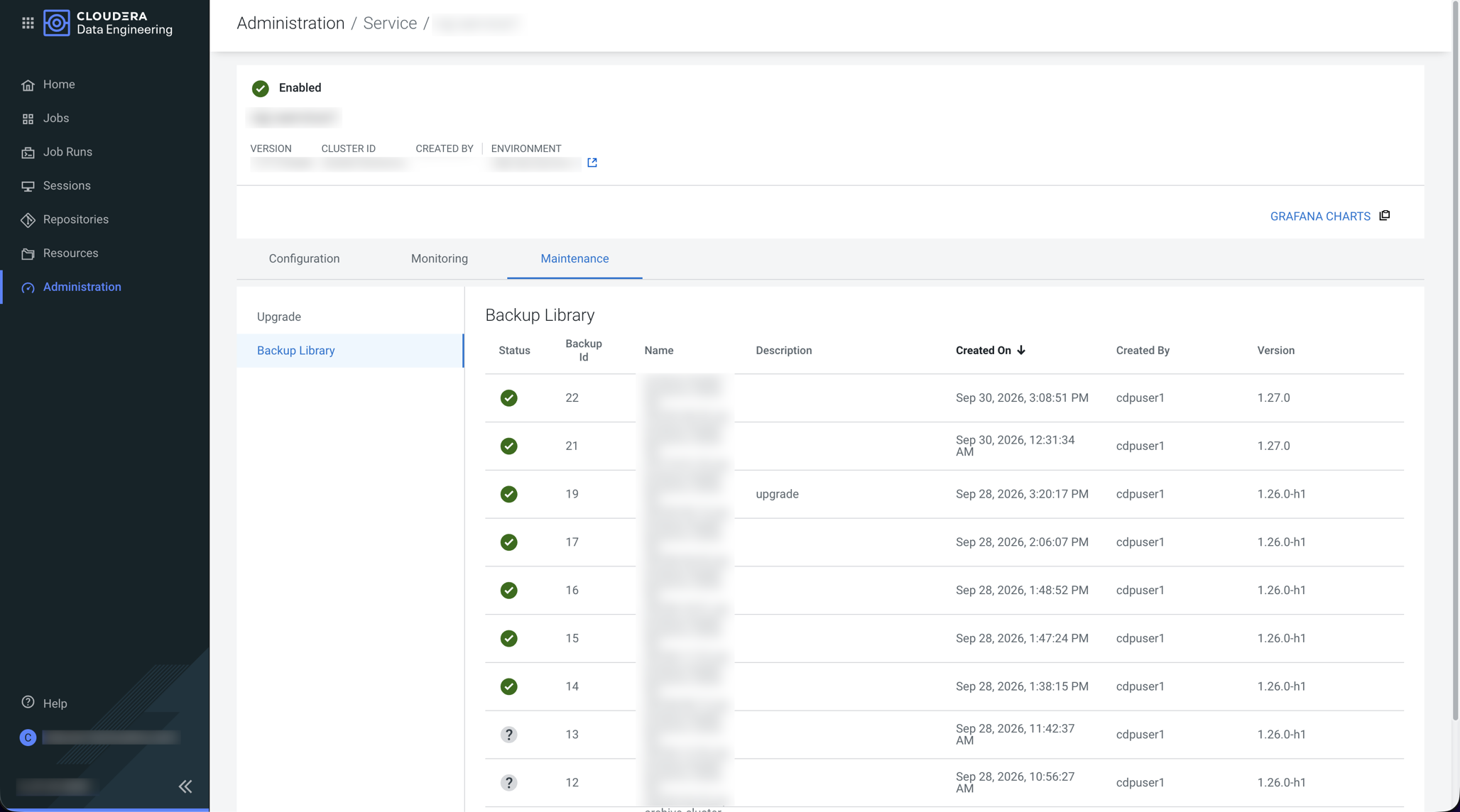

  6. Optional: When the backup is complete, to view the backup that was created, select Backup Library.
