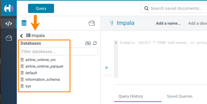

  3. To run Impala queries:
    1. On the Overview page under Virtual Warehouses, click on the Data Explorer (Hue) button.
      The query editor is displayed:
    2. Click a database to view the tables it contains.
      When you click a database, it sets it as the target of your query in the main query editor panel.
    3. Type a query in the editor panel and click the run icon to run the query.

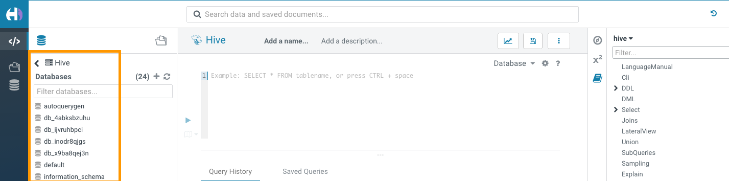

  4. To run Hive queries:
      The Hive query editor is displayed:
