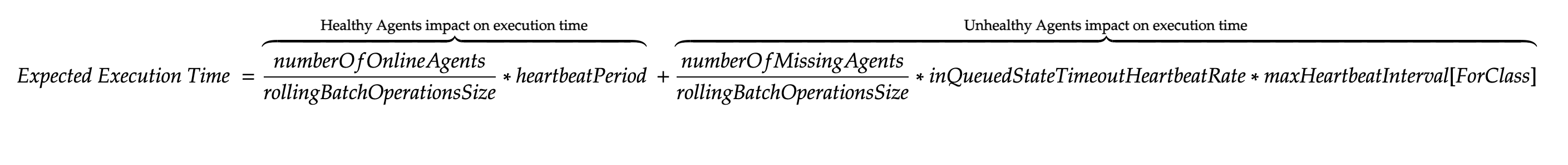

If you combine all the configurations explained in the scenarios, you can derive an expected execution time formula:
