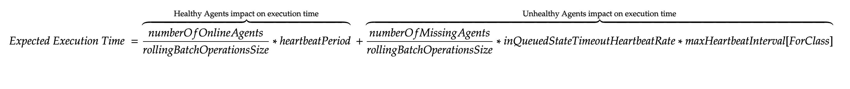

  • efm.operation.monitoring.rollingBatchOperationsFrequency: Based on former execution times, find the frequency where at most 25% of the rolling batch size frees up in a single iteration.
  • efm.monitor.maxHeartbeatInterval in combination with efm.operation.monitoring.inQueuedStateTimeoutHeartbeatRate: Maxheartbeatrate should be close to 75 percentile so you can keep inQueuedStateTimeoutHeartbeatRate to a value which should not be more than 3. If a higher number is needed for the rate, you should investigate those agents why those agents do not match with criterias.
  • efm.operation.monitoring.inDeployedStateTimeout in combination with efm.operation.monitoring.inDeployedStateCheckFrequency: Deployed state timeout should be 120% of the longest expected operation execution time. State check frequency should be set to such a value where the Edge Flow Manager checks state at most 4-10 times during the operation execution.
If you combine all the configurations explained in the scenarios, you can derive an expected execution time formula:
