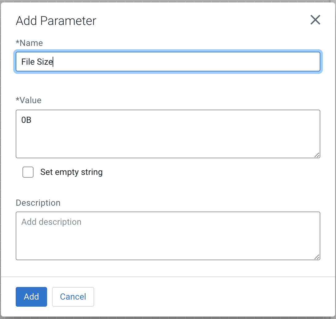

- Find the one or more properties or configurations that may need unique values on a per
agent basis and create parameters. Keep track of
namewhich will be used as an ID in our REST API calls. You will reference this asparameter namemoving forward.
