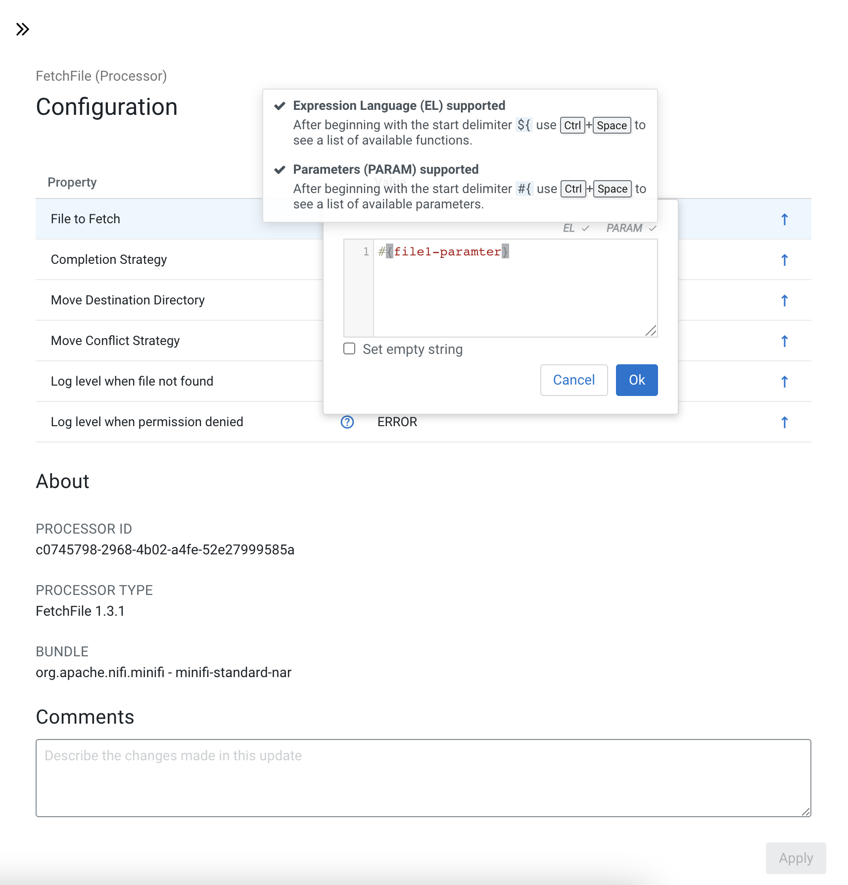

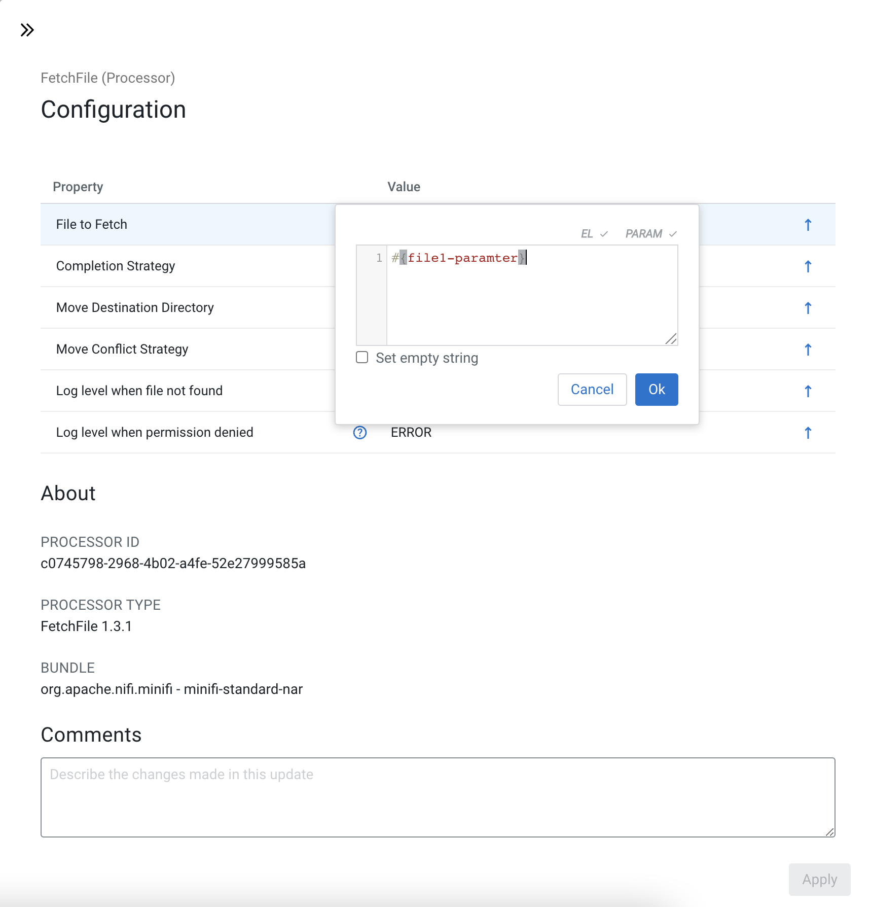

Referencing existing parameters
Existing parameters can be referenced for a processor or service property value during configuration.

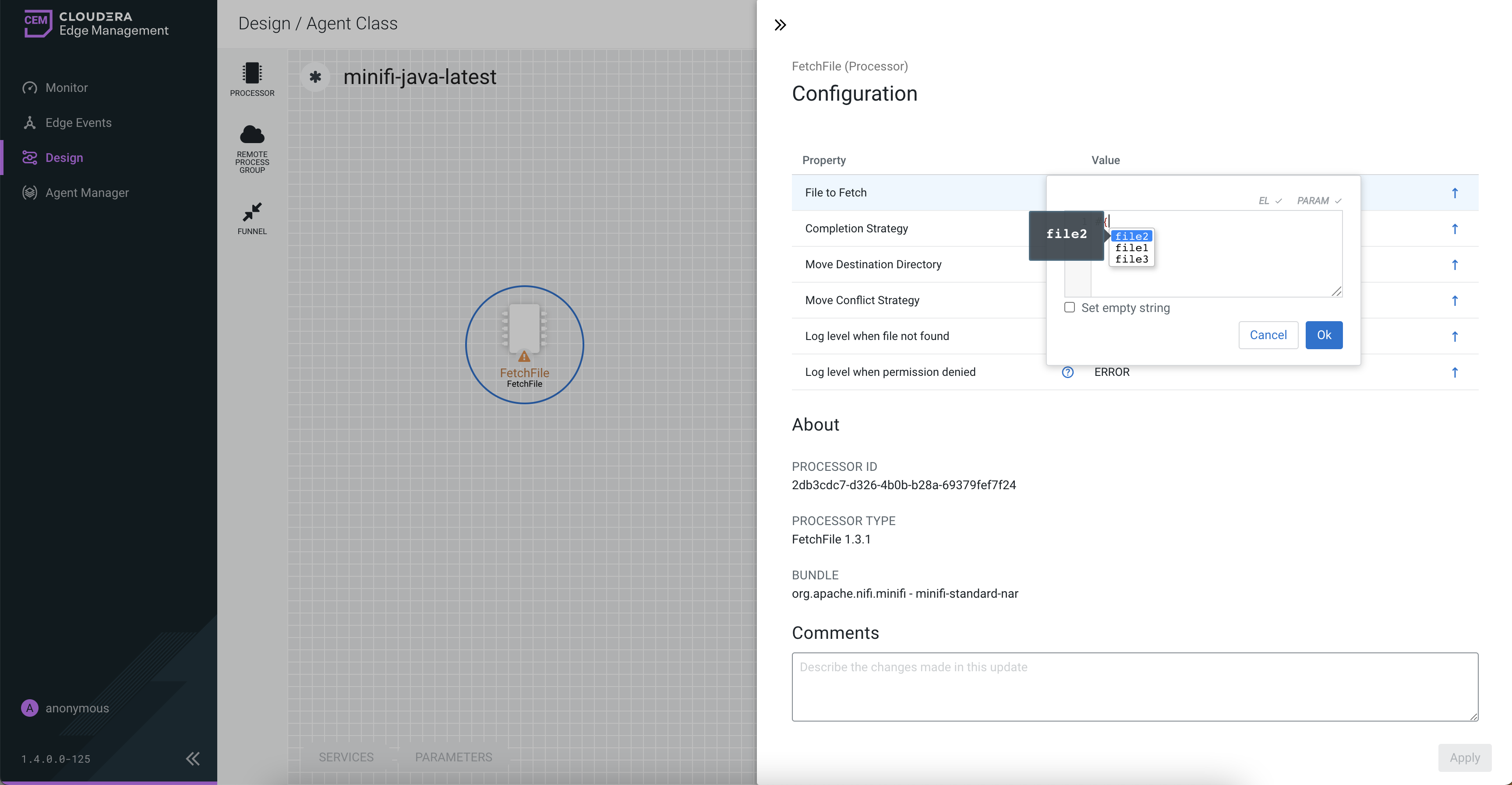

  1. To reference an existing parameter, select the property value field and clear the default value if one exists.
  2. Enter the start delimiter #{.
  3. Enter the parameter name, or press Control+Space to view the list of available parameters.
  4. Complete the reference with a closing curly brace } and select Ok.
  5. Click Apply to save the changes.
    You can hover over the Expression Language and Parameters indicators for help text on this process.

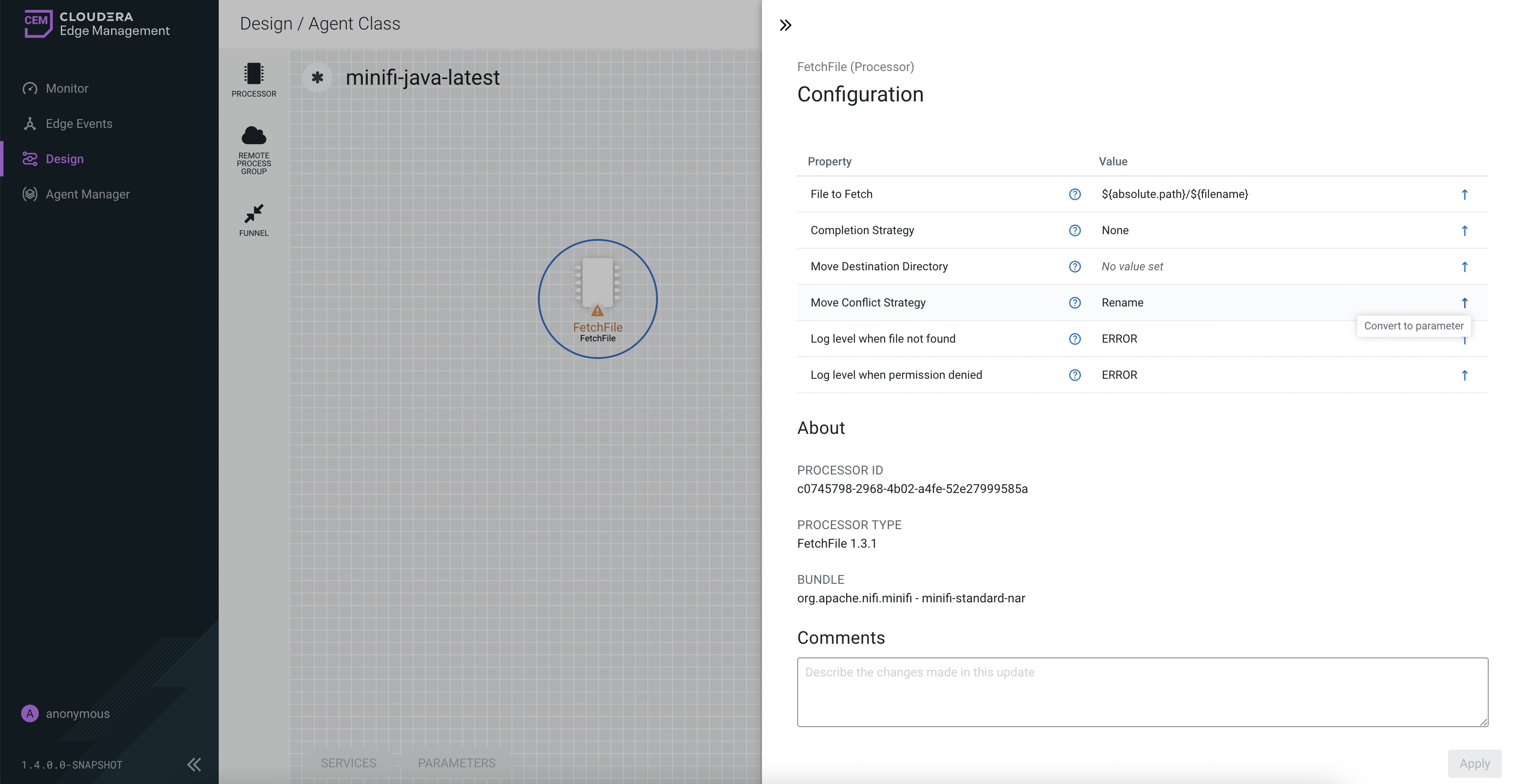

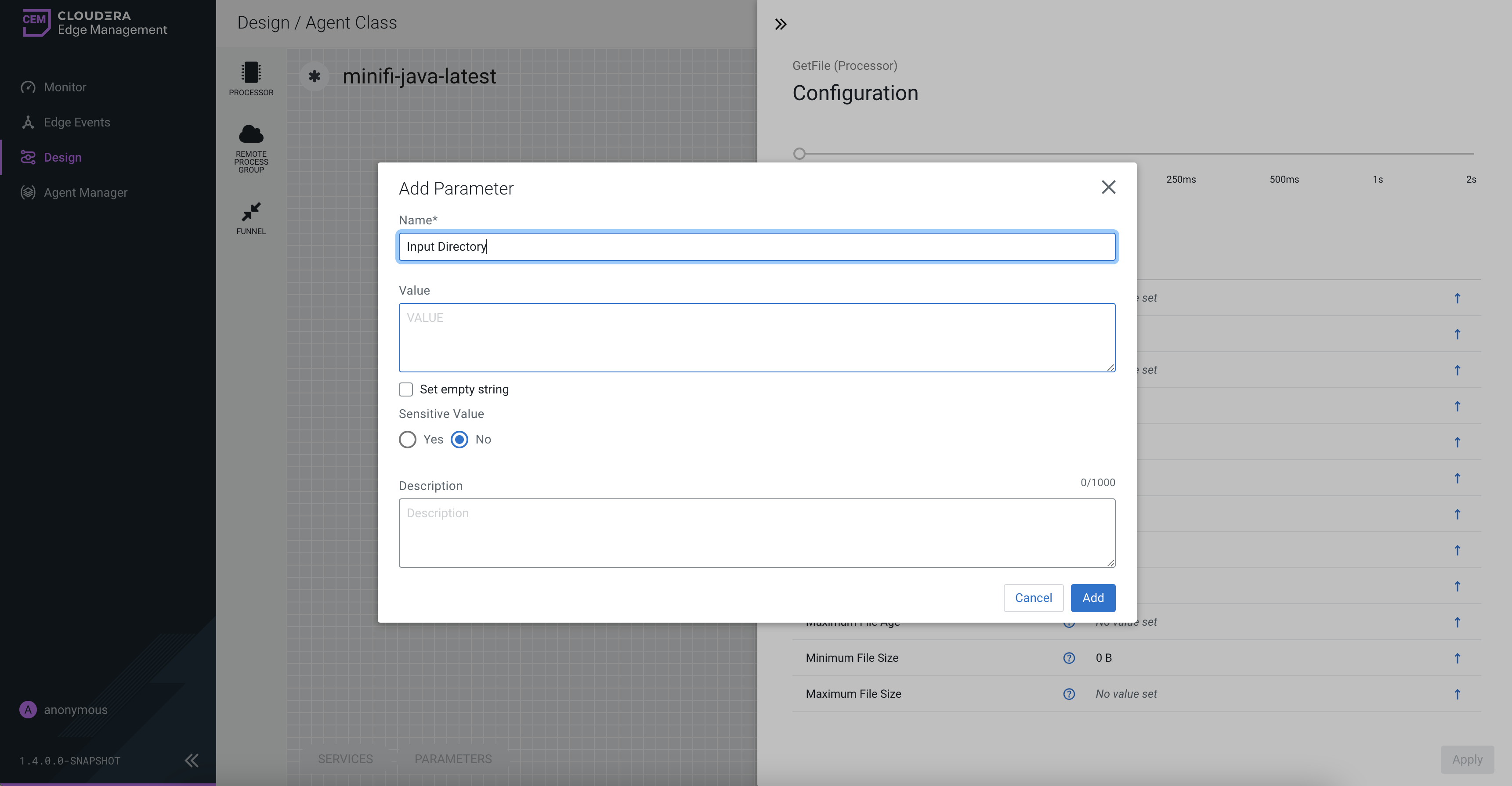

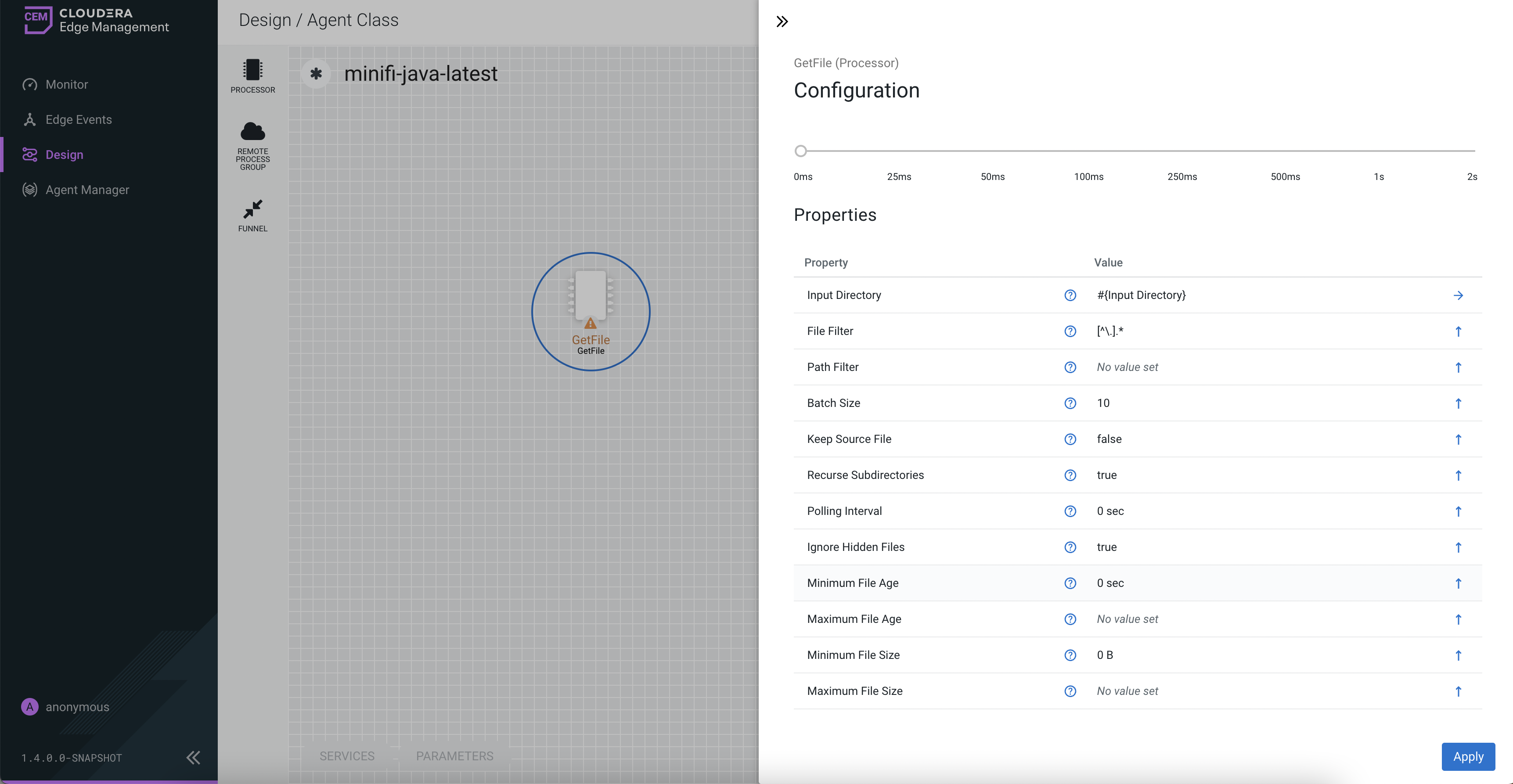

Converting property values to parameters
You can create parameters during the configuration of processors or services. Instead of entering a property value, you can convert the property value to a parameter.
  1. Click (the Convert to parameter icon) for the chosen property.
    The Create Parameter modal window appears.
  2. Configure the parameter properties.
  3. Click Add to create the parameter.
    The property will automatically reference the new parameter using the correct syntax.
  4. Click Apply to save the changes.

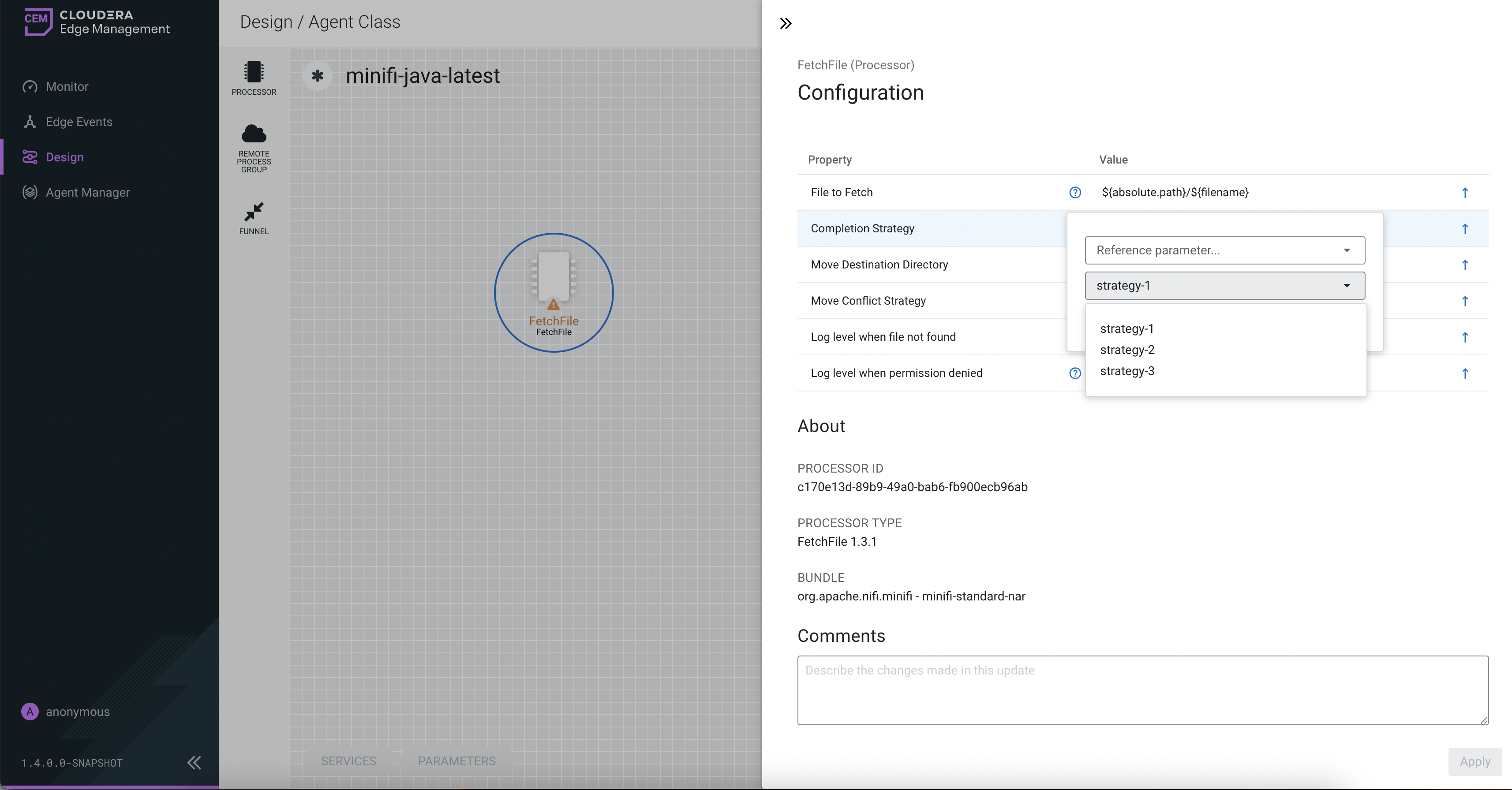

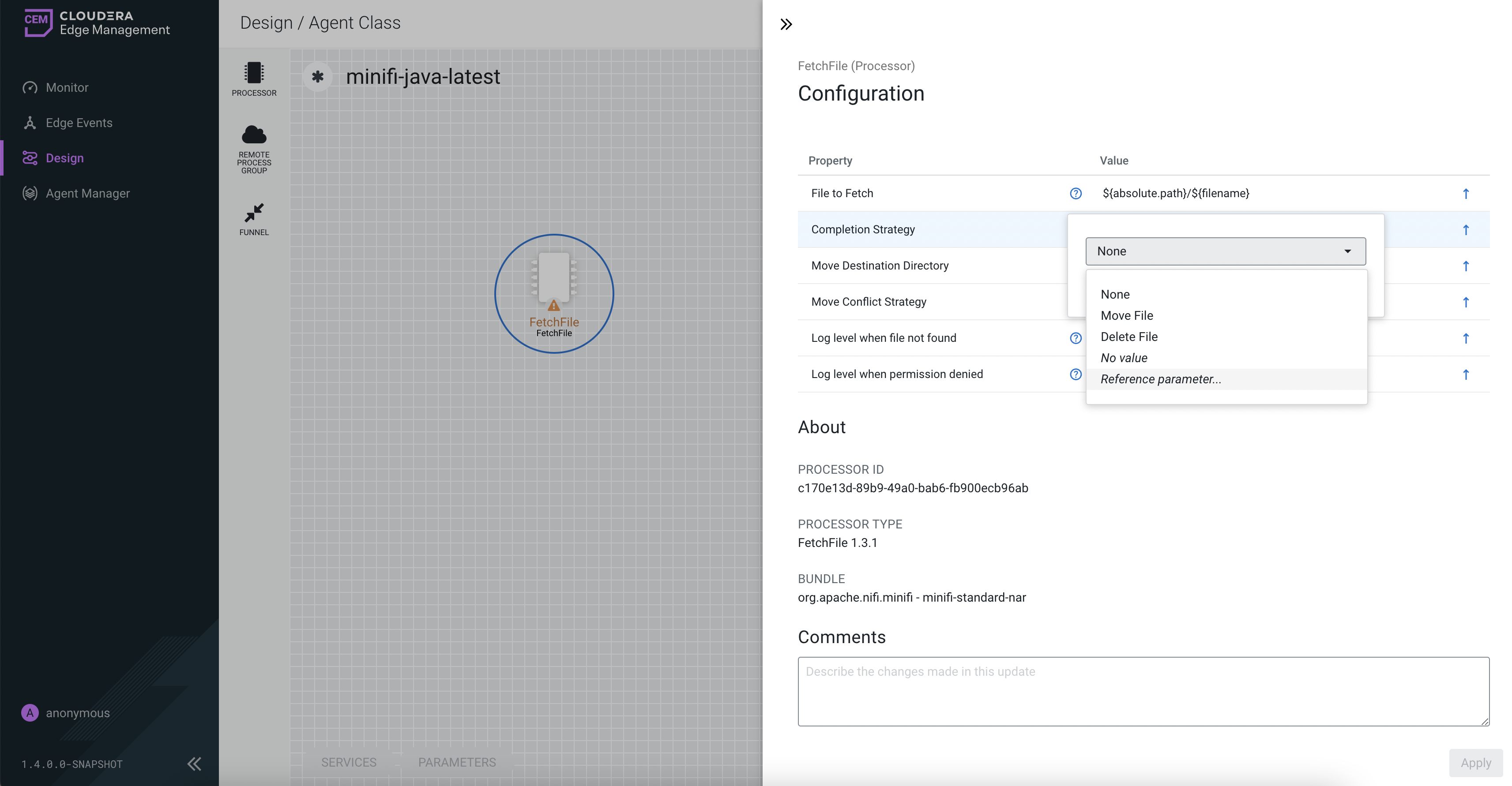

Converting selectable property values to parameters
Property values that are selectable can also reference parameters.
  1. Select the property value drop-down. The option Reference parameter... is available for eligible properties.
  2. Select Reference parameter… option. A list of parameters to choose appears.
  3. Select a parameter and click OK.

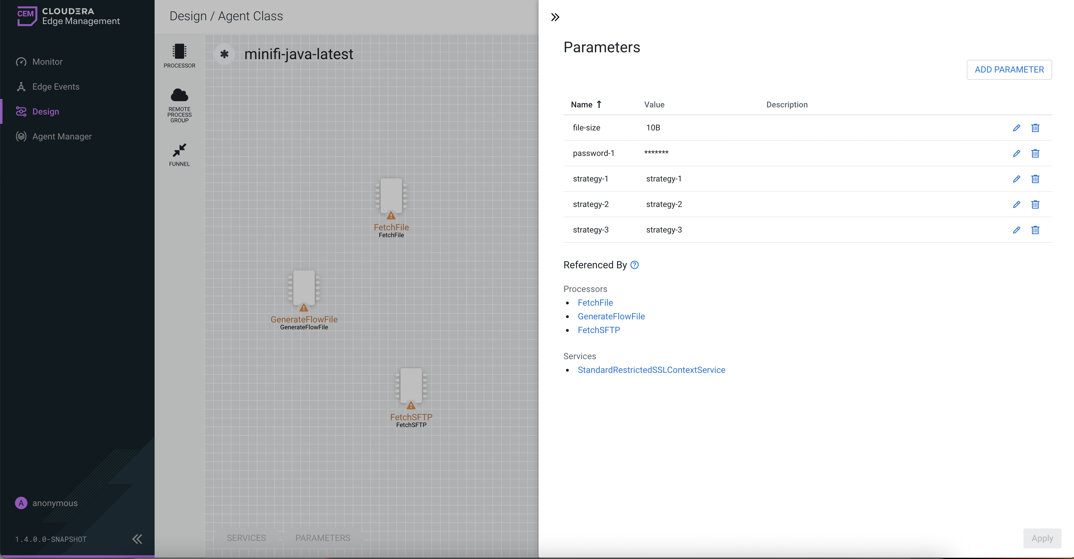

Referenced parameters
The Parameters window lists all parameters used in a flow, along with the components that reference them.
Select a specific parameter to view the processors and services that use it.
