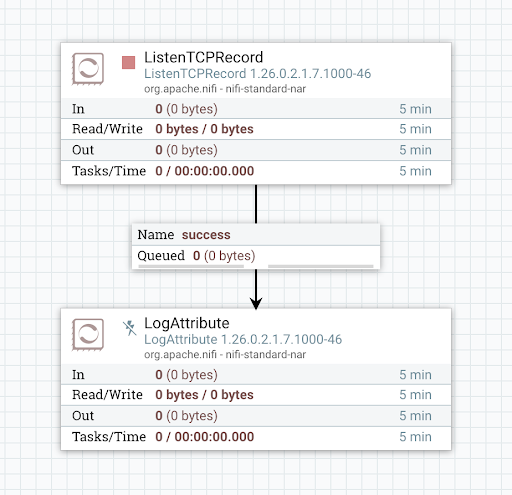

This process group contains the following simple flow:
The ListenTCPRecord processor does not reference any variables.

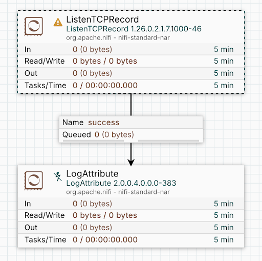

      In this example, you can see the following manual-change-request entry.
      	"sequence" : 6,
      	"type" : "manual-change-request",
      	"subject" : "b41966ad-0194-1000-a08d-a92489457356",
      	"message" : "The component has been deprecated. It is suggested to replace it with a combination of [org.apache.nifi.processors.standard.ListenTCP] and [org.apache.nifi.processors.standard.ConvertRecord] processors",
      	"context" : {
        	"rule" : "36227b60-75f0-40dc-8caf-a2ec577aa54c"
      1. To identify the processor affected by these changes, search for the value of the “subject” element in NiFi’s search box.
        It refers to the ListenTCPRecord processor.
      2. Open the TCP Listener process group.
        You can see that the processor is marked with dashed borders and its version number still shows that of the NiFi 1 instance. It means that it is a "ghost processor", not available in NiFi 2. The log message suggests replacing it with a combination of ListenTCP and ConvertRecord processors.
      3. Instantiate and configure the ListenTCP and ConvertRecord processors, connect them appropriately, and then remove the ghost processor.
