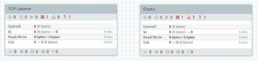

The flow consists of two process groups:
  • TCP Listener (ID: b41940d7-0194-1000-42fc-458834630567)
  • Elastic (ID: b42881c7-0194-1000-3cdf-1bd453a0ed0f)
At the root level, the flow is structured as follows:
TCP Listener Process Group
This process group contains the following simple flow:
The process group defines a variable called TCP Listener Port, which is referenced by the ListenTCPRecord processor.

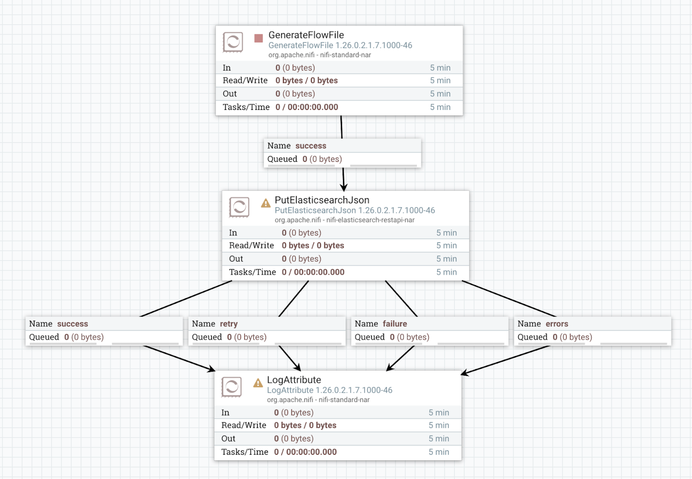

Elastic Process Group
This process group also contains a simple flow:

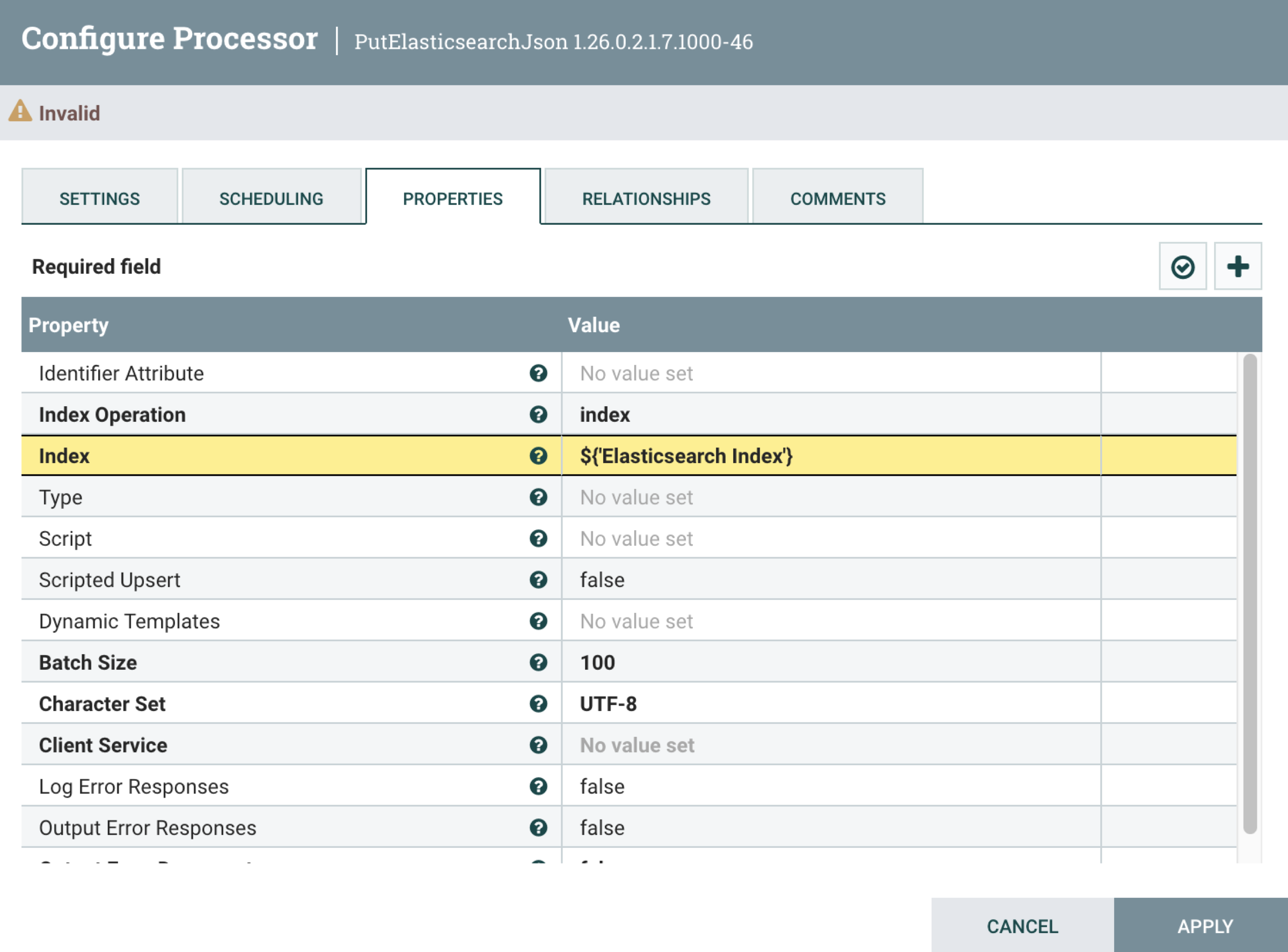

The process group defines a variable called Elasticsearch Index. This variable is referenced in the PutElasticsearchJson processor’s Index property.

      • The following were changes made during the template migration:
        • A new parameter context was created with a new parameter called Elasticsearch Index, which replaces the corresponding variable of the same name.
        • The new parameter is referenced from the PutElasticsearchJson processor.
        • The Elasticsearch Index variable was removed.
