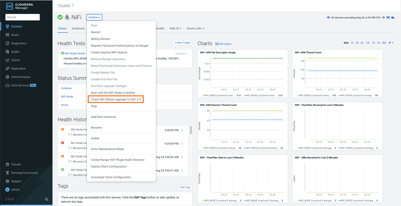

  1. From Cloudera Manager, click the Clusters tab in the left-hand navigation.
  2. Click NiFi in the list of services to display the NiFi service page.

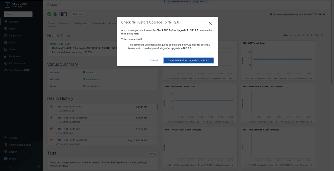

  3. Click the Actions drop-down next to the service name and select the Check NiFi Before Upgrade To NiFi 2.0 option.
  4. Click Check NiFi Before Upgrade To NiFi 2.0 again.

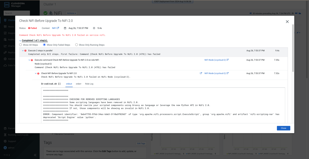

    The script runs across all NiFi nodes, providing a comprehensive list of items to address before starting an upgrade to NiFi 2.
  5. Review this list thoroughly to ensure a smooth upgrade process.

******************** CHECKING THAT UPGRADE PATH IS SUPPORTED
******************** (It is required to be on CFM 2.1.7+ before upgrading to CFM 4.0.0+)
Get current CFM version from bootstrap.conf and check it's valid to upgrade to CFM with NiFi 2.0 (CFM-4.0.0.0 or newer)
Property value for 'working.dir' = /opt/cloudera/parcels/CFM-2.1.7.1000-42/NIFI
Current CFM version could be upgraded to CFM with NiFi 2.0 (CFM-4.0.0.0 or newer).
******************** CHECKING THAT JAVA 21 IS USED
******************** (Java 21 is the minimum Java version required for NiFi and NiFi Registry 2.0)
Get 'java' property value from bootstrap.conf
Property value for 'java' = java
Getting java home from JAVA_HOME in env variables.
Executing command: /usr/java/jdk1.8.0_232-cloudera/bin/java -version 2>&1 | awk -F[\"\.] -v OFS=. 'NR==1{print $2}'
Command output: 1
WARN: Your current Java version is too low for upgrading to NiFi 2.0 (CFM-4.0.0.0). Please install Java version 21 on each host with NiFi and follow the upgrade documentation for NiFi 2.0 (CFM-4.0.0.0). NOTE: Do not change the JDK for the current NiFi. It should only be changed during the upgrade to NiFi 2.0 (CFM-4.0.0.0).
******************** CHECKING FOR REMOVED COMPONENTS
******************** Some components have been removed in NiFi 2.0.
******************** You should switch to the recommended option before upgrading.
******************** If not, those components will be showing as ghost components in NiFi.
ERROR: Component identifier: '8d74d462-7c52-35d1-ad1b-665696503ea2' of type 'org.apache.nifi.processors.gettcp.GetTCP', group 'org.apache.nifi' and artifact 'nifi-tcp-nar' is no longer supported.
ERROR: Component identifier: 'f78dba93-e6ec-38d7-b5e4-fdbcd09fd831' of type 'org.apache.nifi.processors.pulsar.pubsub.PublishPulsar', group 'io.streamnative.connectors' and artifact 'nifi-pulsar-nar' is removed, but it is planned to be reintroduced later. Please check the available CFM-4.x releases.
ERROR: Component identifier: '2e2edf20-3efc-388a-ac96-943b717e5252' of type 'org.apache.nifi.processors.twitter.GetTwitter', group 'org.apache.nifi' and artifact 'nifi-social-media-nar' is no longer supported. Please consider using 'ConsumeTwitter' instead.
ERROR: Component identifier: 'a0766b6b-140e-31a8-a1fb-80f10459f870' of type 'org.apache.nifi.kerberos.KeytabCredentialsService', group 'org.apache.nifi' and artifact 'nifi-kerberos-credentials-service-nar' is no longer supported. Please consider using 'KerberosKeytabUserService' instead.
******************** CHECKING FOR REMOVED SCRIPTING LANGUAGES
******************** Some scripting languages have been removed in NiFi 2.0.
******************** You should rewrite your scripted components using Groovy as language or leverage the new Python API in NiFi 2.0.
******************** If not, those components will be showing as invalid in NiFi 2.0.
ERROR: Component identifier: 'e0334fb0-738b-3000-bdfc-fee3e59f539d' of type 'org.apache.nifi.processors.script.InvokeScriptedProcessor', group 'org.apache.nifi' and artifact 'nifi-scripting-nar' has deprecated 'Script Engine' value 'ruby'.
ERROR: Component identifier: 'e9d304ef-6c58-39ea-aa27-c01a6d5718fe' of type 'org.apache.nifi.processors.script.ExecuteScript', group 'org.apache.nifi' and artifact 'nifi-scripting-nar' has deprecated 'Script Engine' value 'python'.
******************** CHECKING FOR VARIABLES
******************** Variables no longer exist in NiFi 2.0 and are replaced by Parameters and Parameter Contexts.
ERROR: Component identifier: 'e65e16f2-d5ba-32b4-a04e-1ae97c44da02' contains 2 variable(s).
ERROR: Component identifier: '1428d513-770b-3c26-94c9-9641d57050c1' contains 3 variable(s).
******************** CHECKING FOR EVENT DRIVEN SCHEDULING STRATEGY
******************** Event Driven Scheduling Strategy no longer exists. Use Time Driven scheduling strategy instead.
No component is configured with Event Driven scheduling strategy.
******************** CHECKING FOR TEMPLATES
******************** Templates no longer exist in NiFi 2.0. The use of NiFi Registry is recommended for versioning flows.
ERROR: Component identifier: '6c387684-c2f2-3bbe-b485-8b6593cda6ba' with 'componentType' 'TEMPLATE'.
******************** CHECKING FOR INCORRECT KERBEROS CONFIGURATION
******************** NiFi components with Kerberos configuration that are available in NiFi 2.0 should be configured with the 'Kerberos User Service'
ERROR: Component identifier: 'a716b969-9163-3e70-a162-b819b9ec4b63' of type 'org.apache.nifi.processors.kafka.pubsub.ConsumeKafka_2_6', group 'org.apache.nifi' and artifact 'nifi-kafka-2-6-nar' has configured Kerberos properties. Please configure Kerberos using 'KerberosUserService', as this is the only configuration supported in NiFi 2.0.
ERROR: Component identifier: '0d650d47-5136-303c-a694-678a027b27cf' of type 'org.apache.nifi.processors.parquet.PutParquet', group 'org.apache.nifi' and artifact 'nifi-parquet-nar' has configured Kerberos properties. Please configure Kerberos using 'KerberosUserService', as this is the only configuration supported in NiFi 2.0.
ERROR: Component identifier: '86c88c6a-369f-3209-9a79-dd6168c28b48' of type 'org.apache.nifi.processors.hadoop.PutHDFS', group 'org.apache.nifi' and artifact 'nifi-hadoop-nar' has configured Kerberos properties. Please configure Kerberos using 'KerberosUserService', as this is the only configuration supported in NiFi 2.0.
Script finished work successfully
ERROR: You should not upgrade until the above errors are taken care of!
