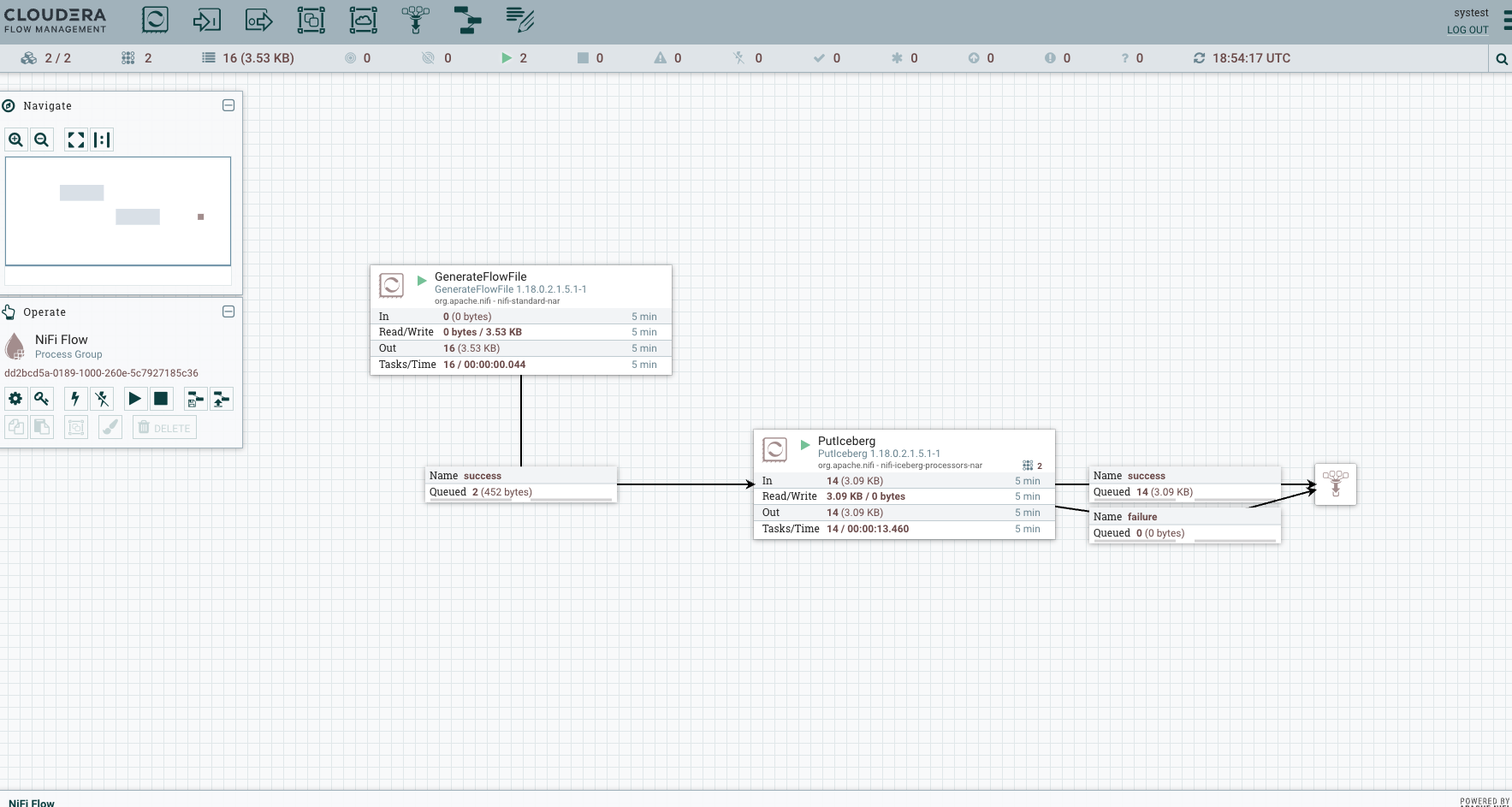

Starting the data flow
Learn how run the flow and verify that data is successfully transferred to the Iceberg table.
To verify the operation of your Iceberg ingest data flow:
Check that data is running through the flow that you have built and it actually appears in the target table.
Monitor the NiFi processors to ensure they are not encountering any errors during the data transfer process.
Use the NiFi user interface to examine the volume of data passing through processors. You can also access status history by right-clicking the processors or connections.
Query and analyze the ingested data using Hue.
