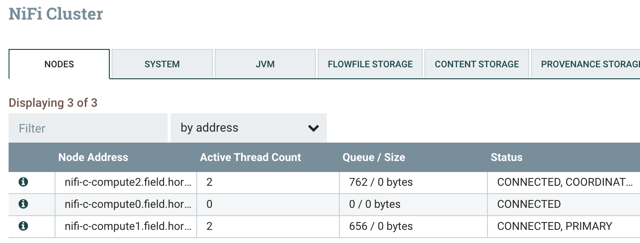

Increasing thread pool size
Do not increase the thread pool size unless you see that the active threads count is always equal to the maximum number of available threads. For example, if you have a 3-node cluster with eight cores per node, do not increase the thread pool size from 24 to a higher number, unless the active thread count displayed in the UI is often equal to 72. (3 nodes x 24 available threads per node = 72).

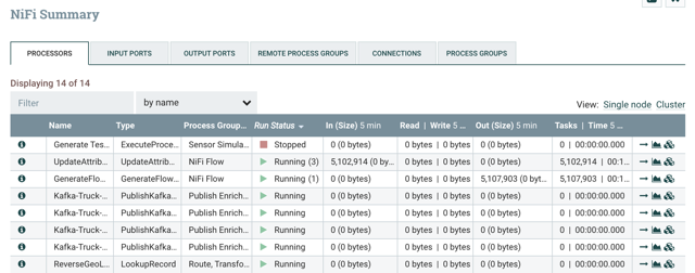

      You can use the NiFi Summary UI to identify the number of threads used per processor.

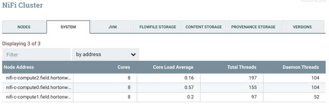

      Core load average of NiFi nodes
If the active threads count is equal to the maximum number of available threads, review the core load average on your NiFi nodes.
      If the core load average is below 80% of the number of cores (below 6.4 in the example), and if the active threads count is at its maximum, you can slightly increase the thread pool size. Start by increasing the thread pool size by n+1 times the number of cores, where n is the current value. You usually want to keep the load average around 80% the number of cores to account for the loss of one node. You also want to have some resources available to process the additional amount of work on the remaining nodes.

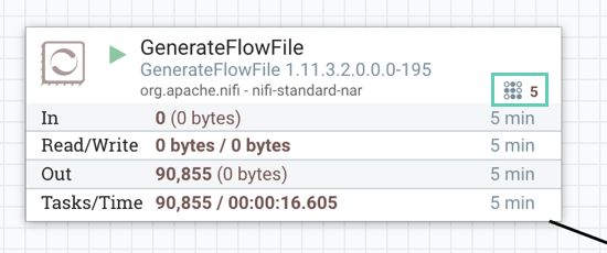

A processor displays active threads across the cluster:
      If a processor has active threads and is not processing data as fast as expected while the load average on the server is low, the issue can be related to I/O operations on disks. In this case it is a good idea to check the I/O statistics on the disks used for the NiFi repositories.
