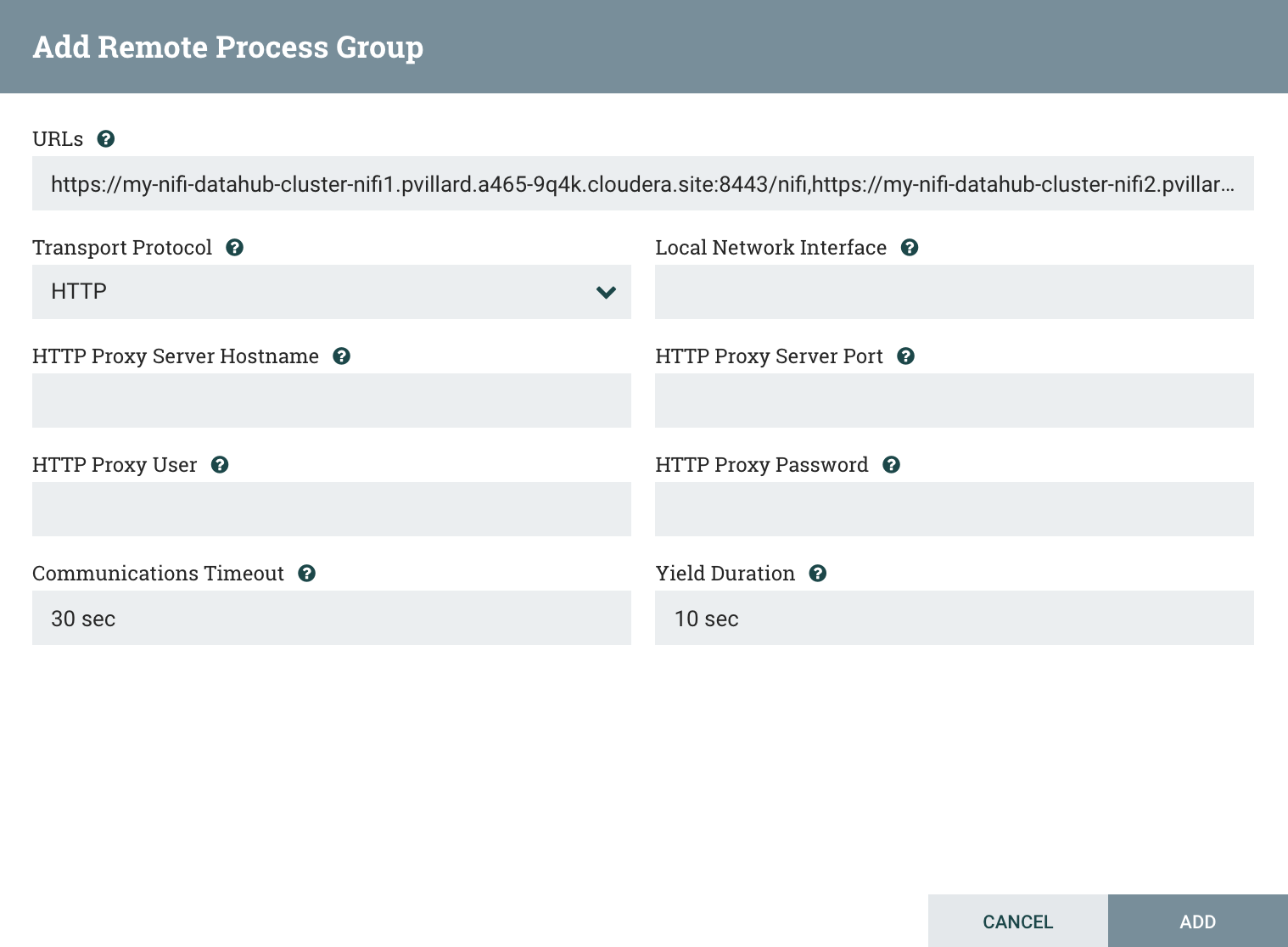

Drag a Remote Process Group onto the NiFi canvas, configure HTTP protocol, and
specify one or more of the NiFi nodes running on your Cloudera on cloud cluster.
After the site-to-site connection is initiated, the source NiFi cluster is
aware of the topology of the remote NiFi cluster and of any increase or decrease
of the size of the remote cluster. However, it is recommended that you specify
at least 2 nodes to ensure higher availability when the site-to-site connection
is initiated.

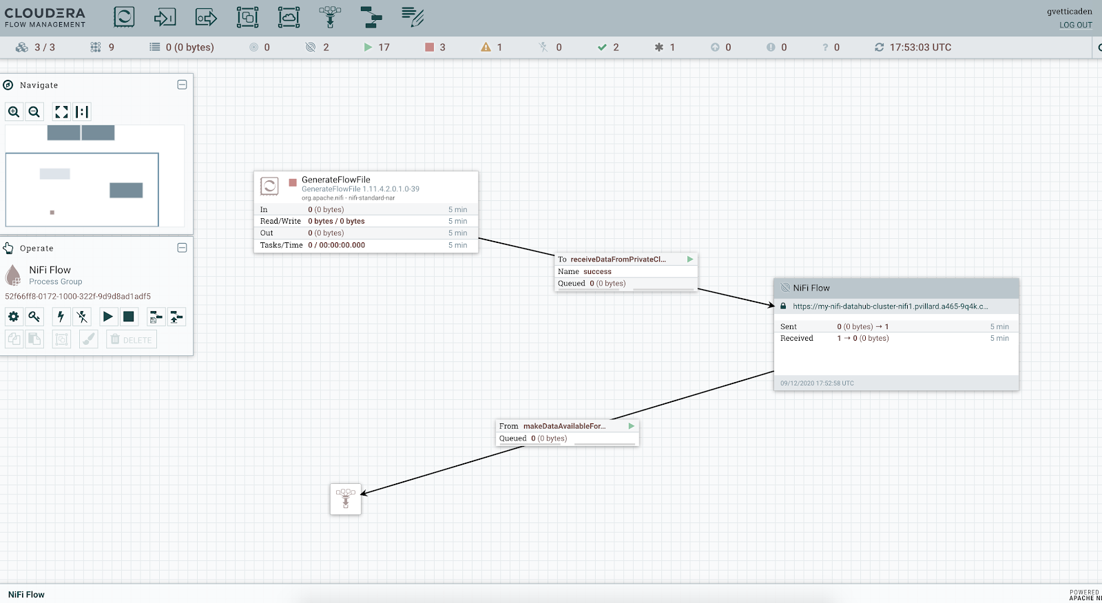

Right-click the Remote Process group and select Enable
transmission.
Connect the GenerateFlowFile processor to the Remote Process
Group and select the Input Port that you created and
started on the remote cluster in Cloudera on cloud:
You can also define a connection from the Remote Process Group to another
component to download data made available by the remote cluster running in the
Cloudera on cloud environment. In the this
example, the Remote Process Group is connected to a funnel.

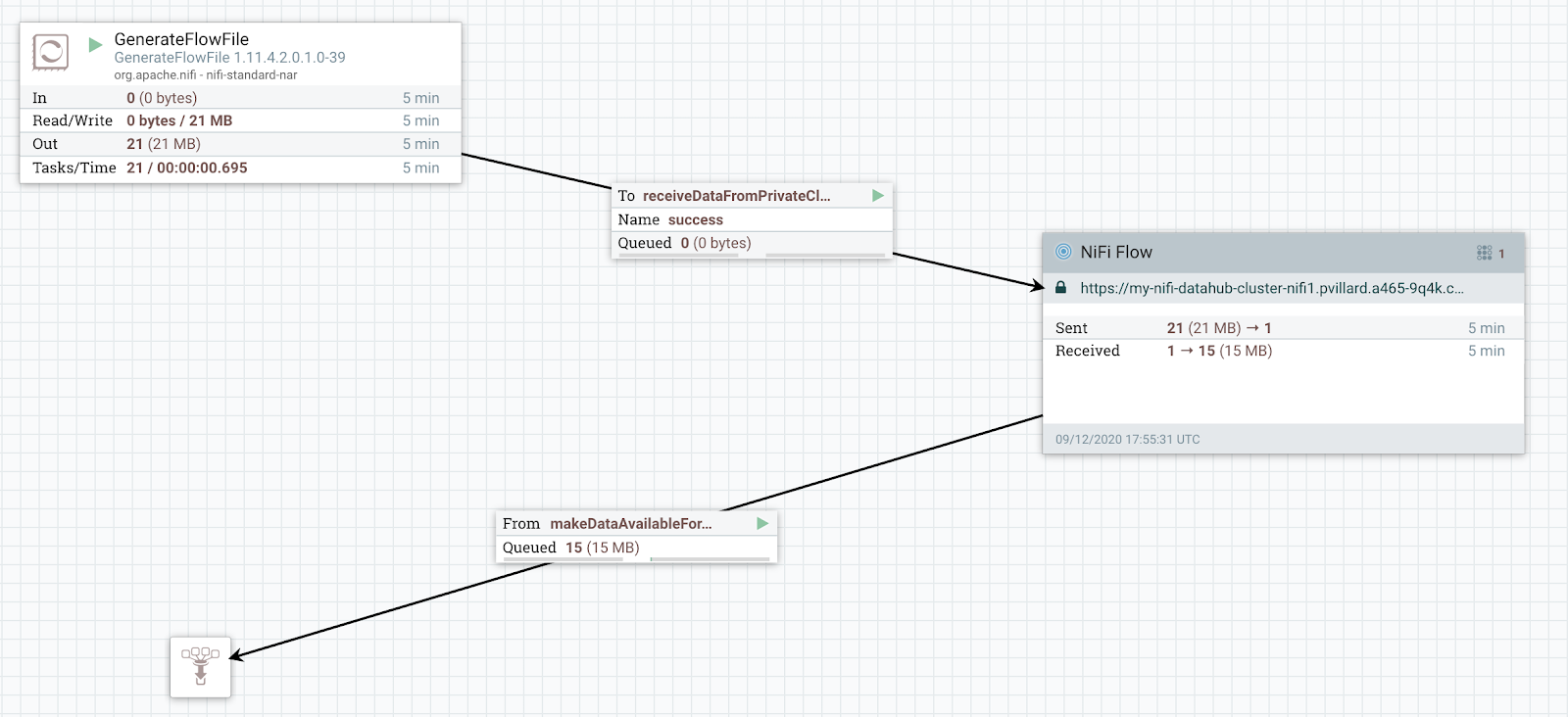

After you have defined the data flow for your Cloudera Base on premises cluster, start the Cloudera Base on premises data flow and confirm that the
data is moving back and forth between the environments:
In the Cloudera Base on premises environment,
your data flow looks similar to the following:

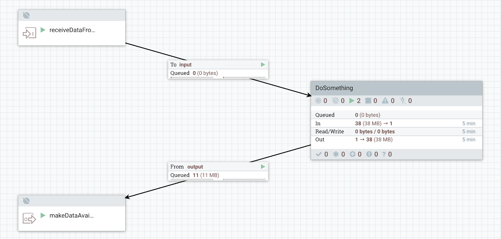

In the Cloudera on cloud environment, your data flow
will look similar to the following:
