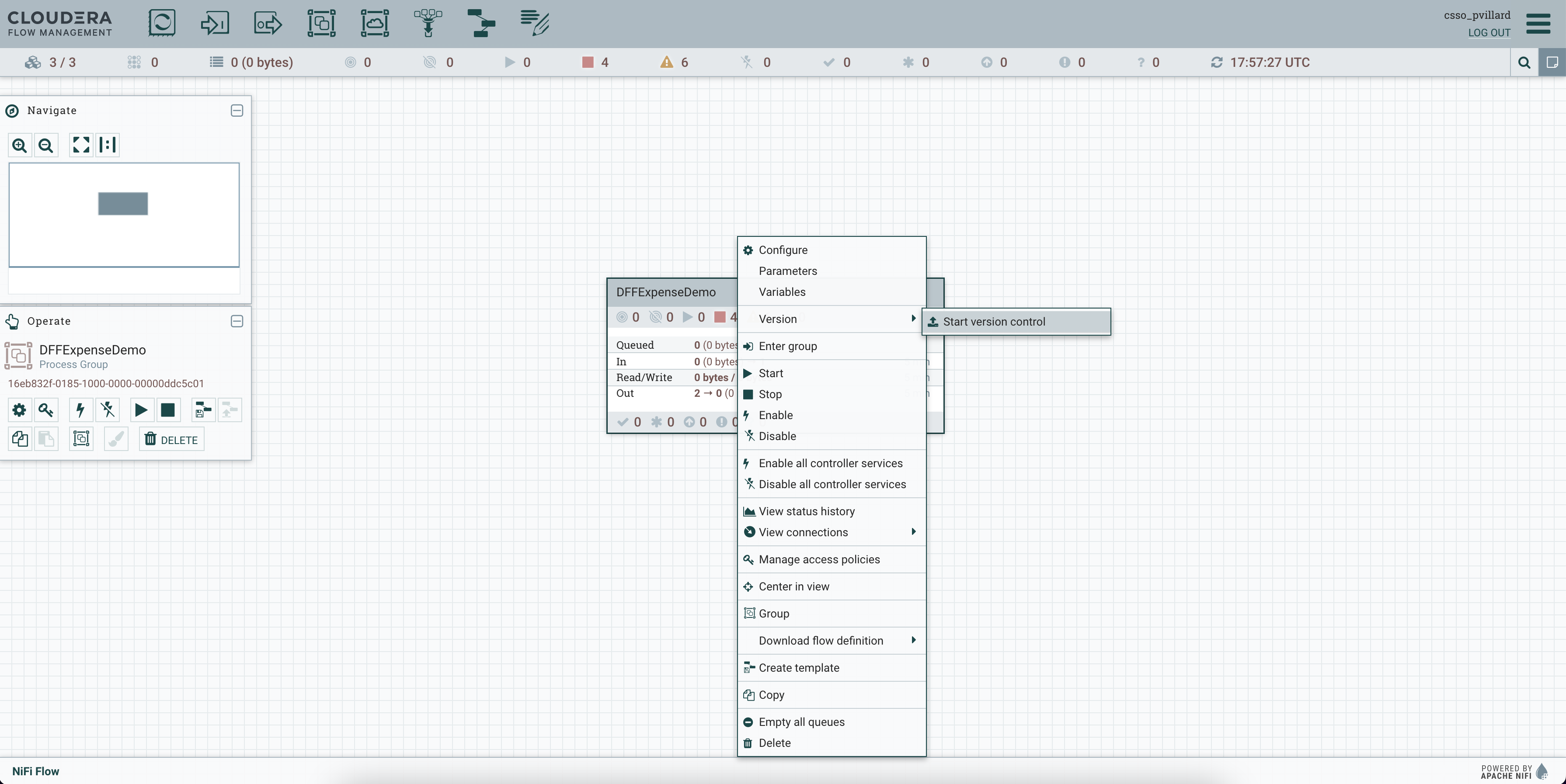

  1. Right-click the process group and select Version > Start version control.

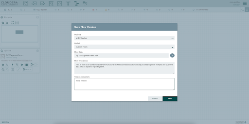

  2. Select the Registry that you want to use.
  3. Select Custom flows for the bucket and give your flow a name, a description, and a comment for the first version.

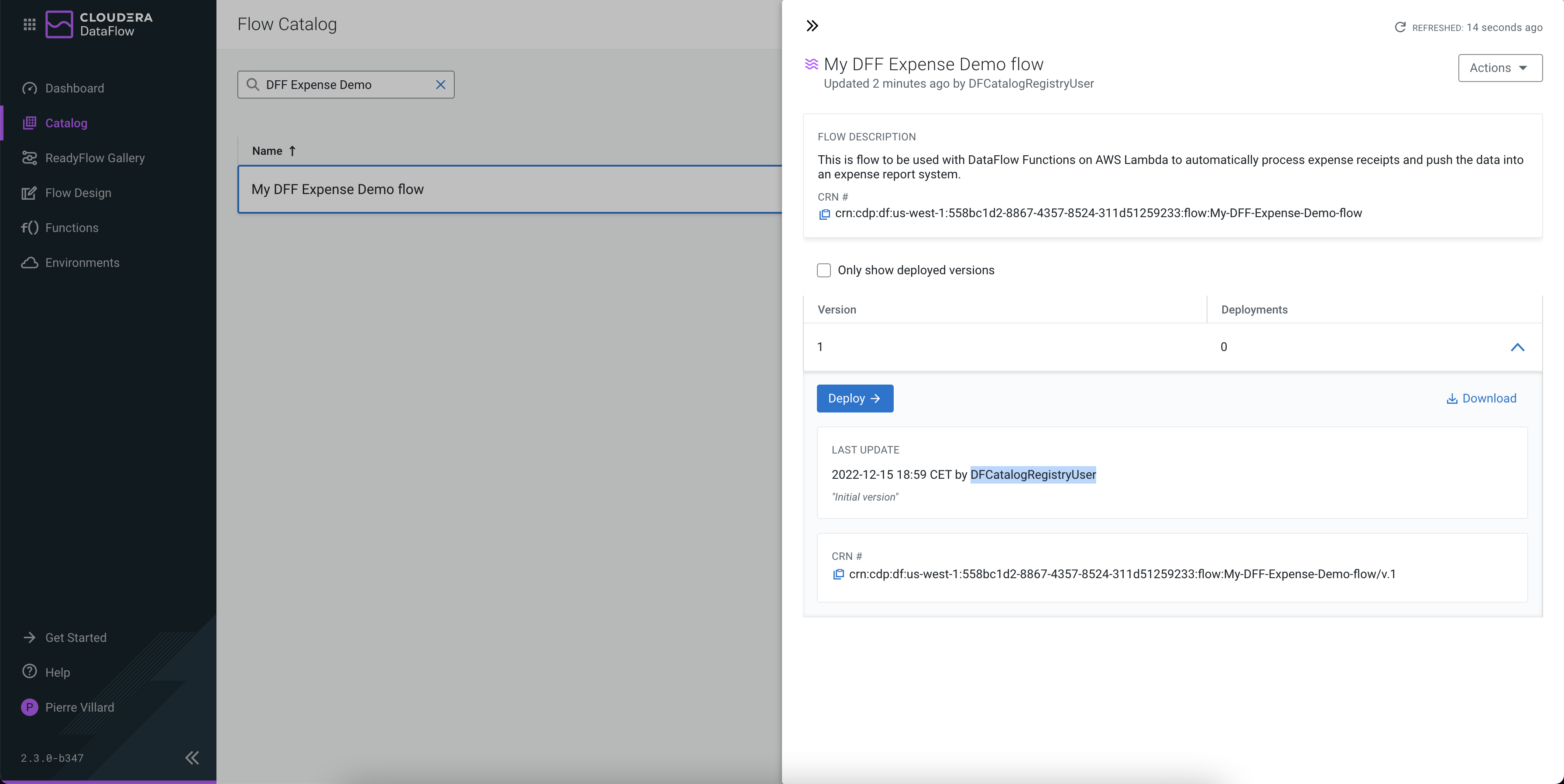

  4. Click Save.
The flow is now available in the DataFlow Catalog.
