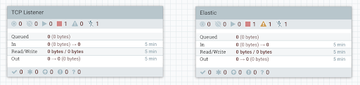

The input directory contains the following flow definition files:
  • TCP_Listener_flow_definition.json
    This file contains the TCP Listener process group (ID: b41940d7-0194-1000-42fc-458834630567)
  • Elastic_flow_definition.json
    This file contains process group Elastic (ID: b42881c7-0194-1000-3cdf-1bd453a0ed0f)
TCP Listener Process Group
This process group contains the following simple flow:
The process group defines a variable called TCP Listener Port, which is referenced by the ListenTCPRecord processor.
Elastic Process Group
This process group also contains a simple flow:
The process group defines a variable called Elasticsearch Index, which is referenced in the PutElasticsearchJson processor’s Index property.
