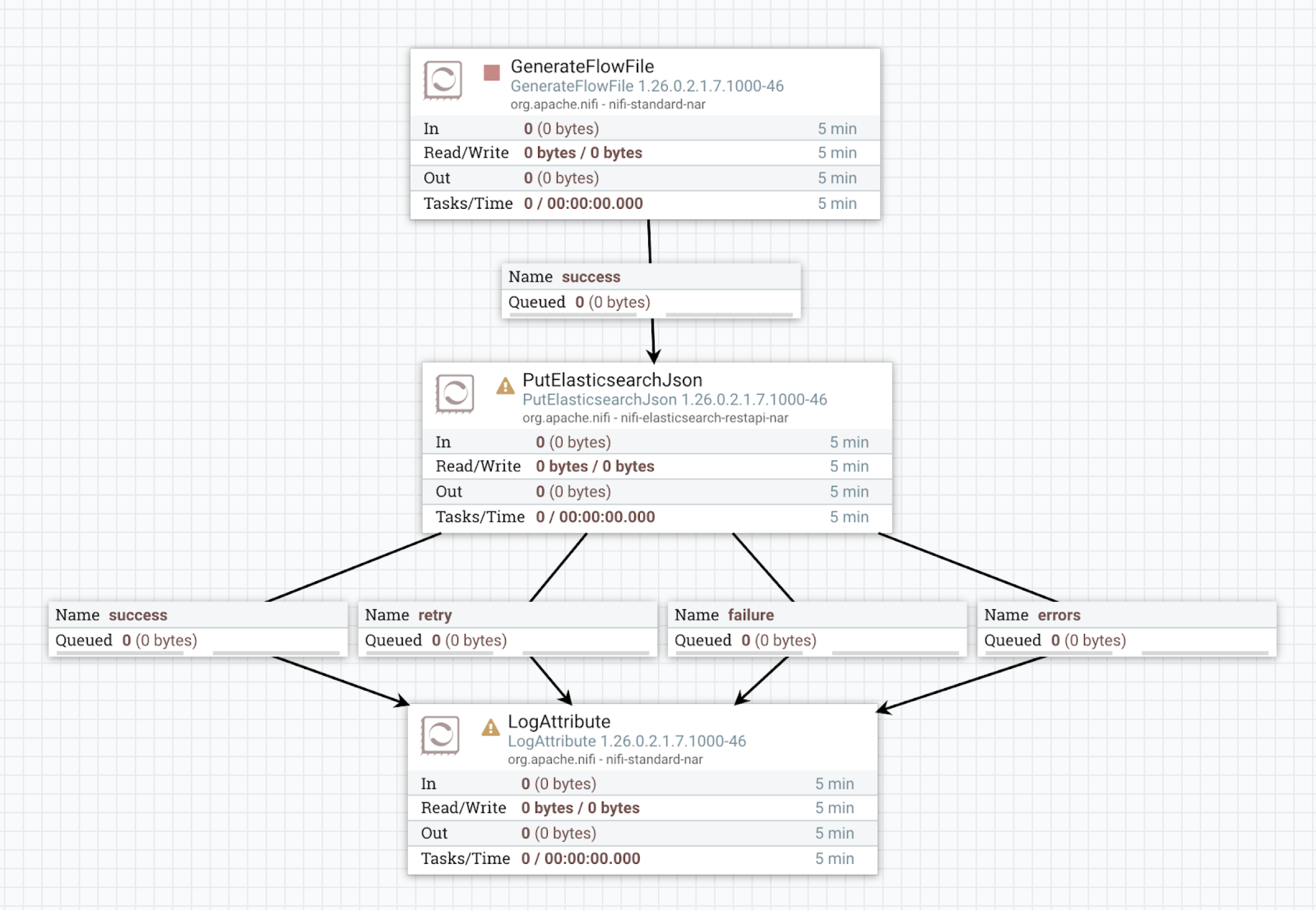

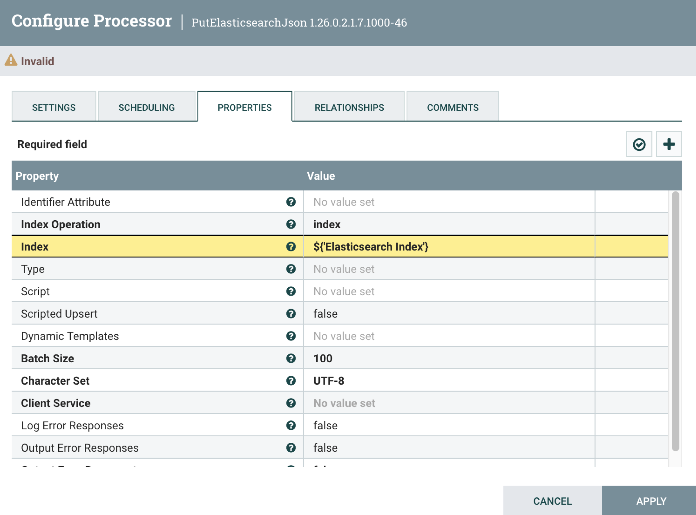

Elastic Process Group
This process group also contains a simple flow:
The process group defines a variable called Elasticsearch Index. This variable is referenced in the PutElasticsearchJson processor’s "Index" property.

  4. Run Stage 1 component migration on the Elastic process group.
    1. Move migrated_flow.json.gz from Step 2 into the input folder (/etc/migration-tool-input) and rename it to flow.json.gz for clarity.
    2. Make a backup of the output folder (/etc/migration-tool-output/components) before running the next migration step.
    3. Run Stage 1 component migration on the Elastic process group using the following command.
      bin/migration.sh nifi migrate-components \
      -i /etc/migration-tool-input/flow.json.gz \
      -od /etc/migration-tool-output/components \
      -pgid b42881c7-0194-1000-3cdf-1bd453a0ed0f \
      --sourceCompatibleOutput
      This generates a sourceVersion folder that contains the two output files of the Stage 1 migration.
      activity_log.json
      • Log of all actions performed during this stage of the migration.
      • A modified NiFi 1 flow, which is not compatible with NiFi 2 yet.
      • It contains everything the original flow did, except the Elastic process group was modified with the actions described in the activity log.
  5. Validate the Stage 1 component migration output for the Elastic process group.
    1. Load the migrated_flow.json.gz into a NiFi 1 instance and check the flow.
    2. Review the activity_log.json file.
      It contains a change-info entry that informs you of changes to a NiFi 2 processor, identified by the subject ID.
      	"sequence" : 2,
      	"type" : "change-info",
      	"subject" : "b428aad6-0194-1000-d73d-9f2332a59f04",
      	"message" : "Property [Max JSON Field String Length] has been added (NIFI-12343); Property [put-es-json-not_found-is-error] has been renamed to [put-es-not_found-is-error] (NIFI-12255); Property [put-es-json-error-documents] has been removed (NIFI-12255); Relationships [success] has been renamed to [original]; Relationship [successful] has been added (NIFI-12255);",
      	"context" : {
        	"rule" : "6501a693-b524-4d1a-b11e-69747c2651e8"
      To identify the processor affected by these changes, search for the value of the “subject” element in NiFi’s search box.
      You are directed to the PutElasticsearchJson processor. No manual modifications are needed at this stage. However, it is important to note that changes will be applied to the PutElasticsearchJson processor during Stage 2 of the migration. Once the full component migration (Stage 1 and Stage 2) is complete, instructions will be provided on how to handle this change.
