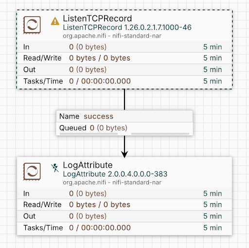

Open the TCP Listener process group.
You can see that the processor is marked with dashed borders and its version number still shows that of the NiFi 1 instance. It means that it is a "ghost processor", not available in NiFi 2. The log message suggests replacing it with a combination of ListenTCP and ConvertRecord processors.
Instantiate and configure the ListenTCP and ConvertRecord processors, connect them appropriately, and then remove the ghost processor.
