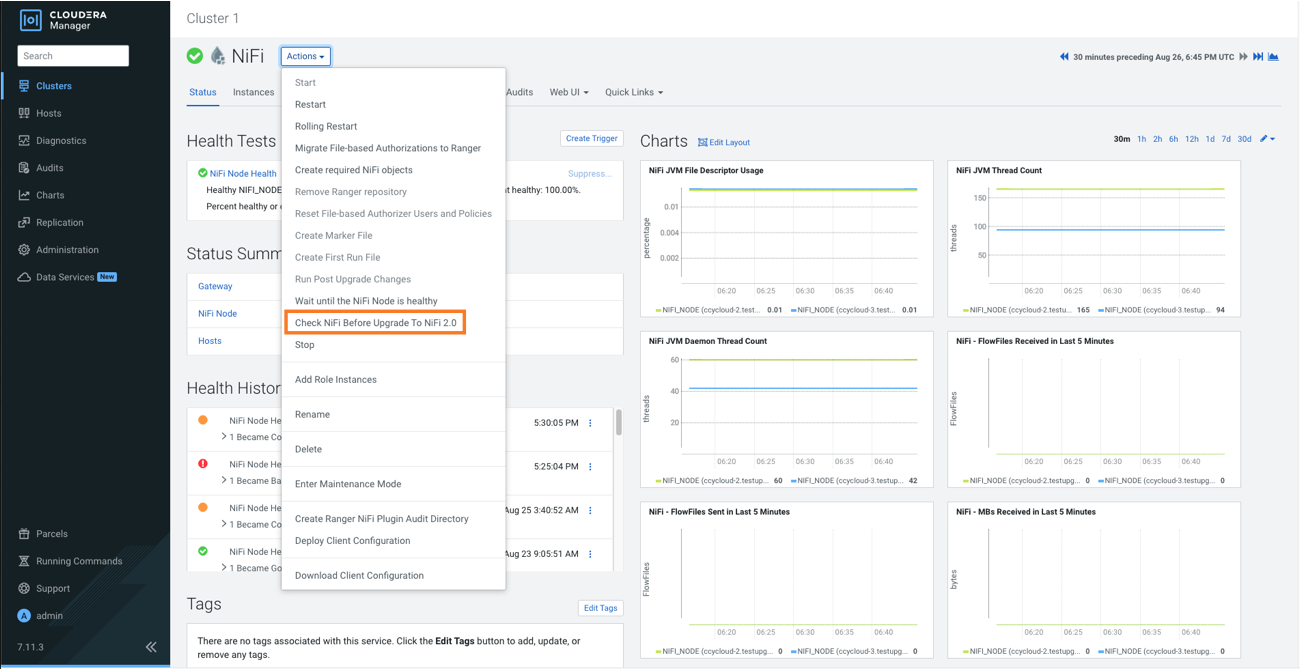

  1. From Cloudera Manager, click the Clusters tab in the left-hand navigation.
  2. Click NiFi in the list of services to display the NiFi service page.
  3. Click the Actions drop-down next to the service name and select the Check NiFi Before Upgrade To NiFi 2.0 option.

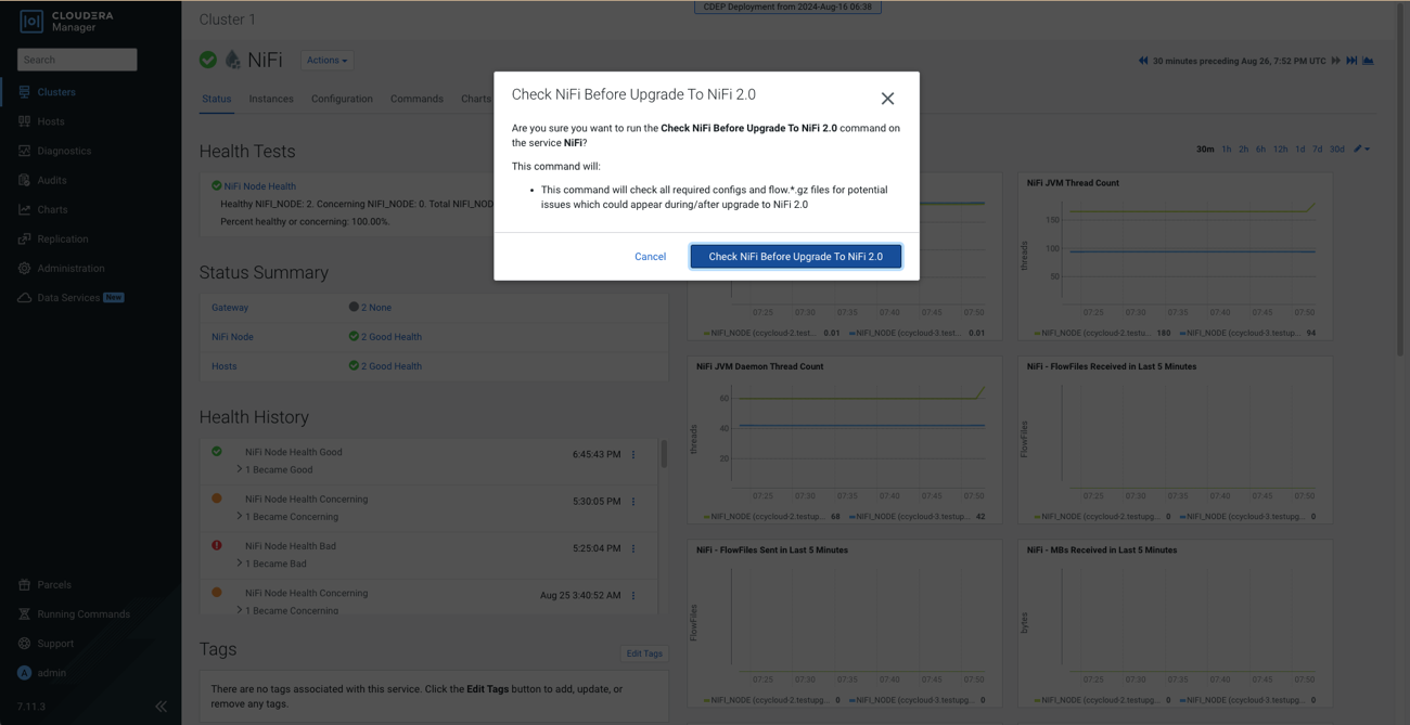

  4. Click Check NiFi Before Upgrade To NiFi 2.0 again.

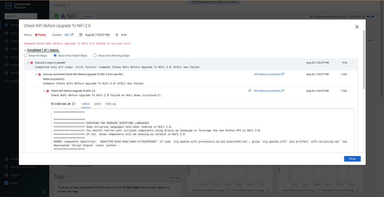

    The script runs across all NiFi nodes, providing a comprehensive list of items to address before migrating to NiFi 2.
  5. Review this list thoroughly to ensure a smooth migration process.

******************** CHECKING FOR REMOVED SCRIPTING LANGUAGES
******************** Some scripting languages have been removed in NiFi 2.0.
******************** You should rewrite your scripted components using Groovy as language or leverage the new Python API in NiFi 2.0.
******************** If not, those components will be showing as invalid in NiFi 2.0.
ERROR: Component identifier: 'e0334fb0-738b-3000-bdfc-fee3e59f539d' of type 'org.apache.nifi.processors.script.InvokeScriptedProcessor', group 'org.apache.nifi' and artifact 'nifi-scripting-nar' has deprecated 'Script Engine' value 'ruby'.
ERROR: Component identifier: 'e9d304ef-6c58-39ea-aa27-c01a6d5718fe' of type 'org.apache.nifi.processors.script.ExecuteScript', group 'org.apache.nifi' and artifact 'nifi-scripting-nar' has deprecated 'Script Engine' value 'python'.
