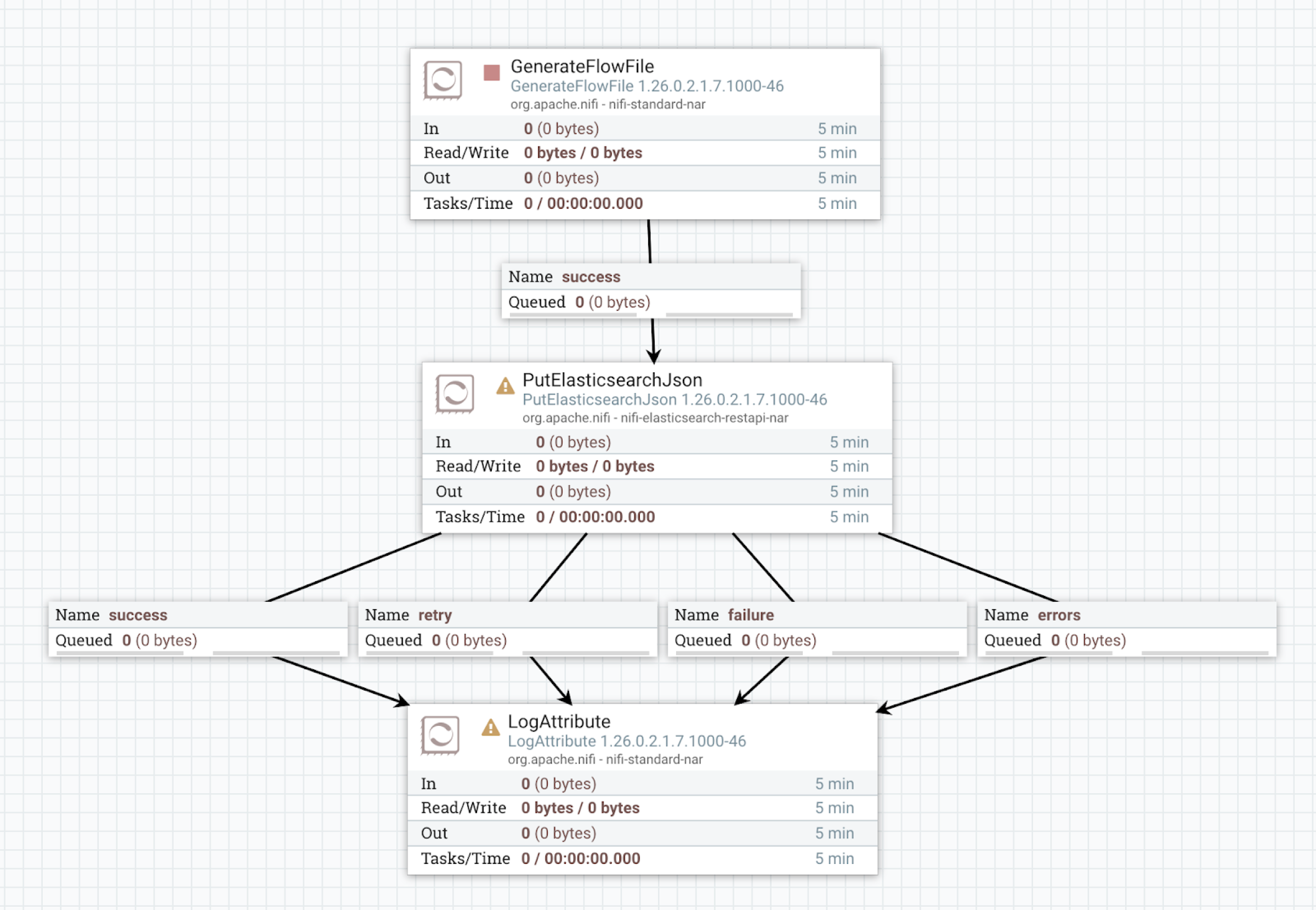

Elastic Process Group
This process group also contains a simple flow:

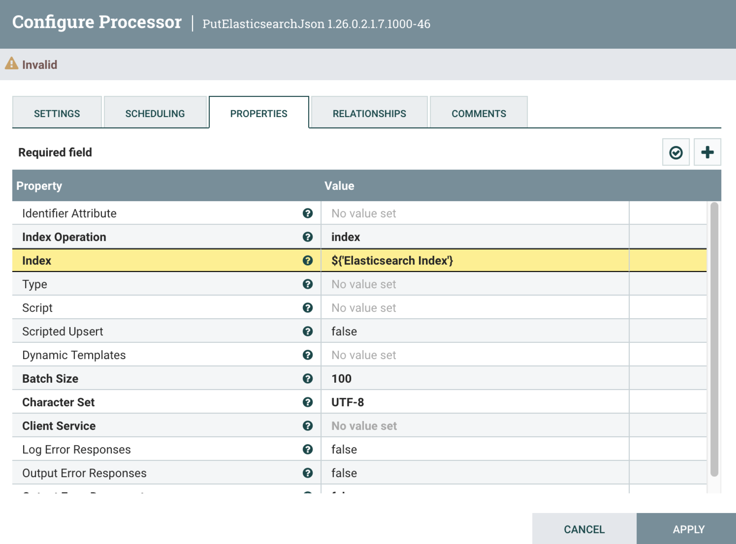

The process group defines a variable called Elasticsearch Index. This variable is referenced in the PutElasticsearchJson processor’s Index property.

  4. Run Stage 1 component migration on the Elastic process group.

  5. Validate the Stage 1 component migration output for the Elastic process group.
    1. Load the migrated_flow.json into a NiFi 1 instance and check the flow.
    2. Review the activity_log.json file.
      It contains a change-info entry that informs you of changes to a NiFi 2 processor, identified by the subject ID.

      To identify the processor affected by these changes, search for the value of the “subject” element in NiFi’s search box.
      You are directed to the PutElasticsearchJson processor. No manual modifications are needed at this stage. However, it is important to note that changes will be applied to the PutElasticsearchJson processor during Stage 2 of the migration. Once the full component migration (Stage 1 and Stage 2) is complete, instructions will be provided on how to handle this change.
