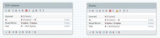

This example uses two template files:
  • migrated_TCP_Listener_template.json
    This file contains process group TCP Listener (ID: b41940d7-0194-1000-42fc-458834630567)
  • migrated_Elastic_template.json
    This file contains process group Elastic (ID: b42881c7-0194-1000-3cdf-1bd453a0ed0f)

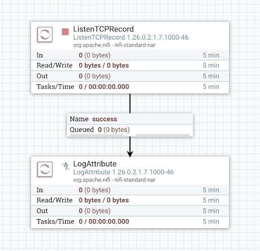

TCP Listener Process Group
This process group contains the following simple flow:

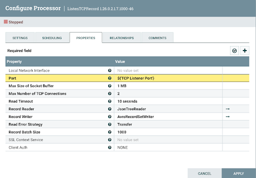

The process group defines a variable called TCP Listener Port, which is referenced by the ListenTCPRecord processor.

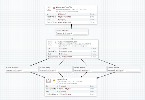

Elastic Process Group
This process group also contains a simple flow:

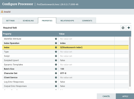

The process group defines a variable, Elasticsearch Index, which is referenced in the Index property of the PutElasticsearchJson processor.

  6. Validate the Stage 1 component migration output for TCP_Listener_template.json.
    1. Load the migrated_TCP_Listener_template.json into a NiFi 1 instance and check the flow.
    2. Review the activity_log.json file and check for any manual-change-requests or manual-validation-requests. If none are present, proceed to the next step.
      In this example, you can see the following information in the Activity Log:
      	"sequence" : 2,
      	"type" : "change-info",
      	"subject" : "b41966ad-0194-1000-a08d-a92489457356",
      	"message" : "Component [org.apache.nifi.processors.standard.ListenTCPRecord] has been deprecated (NIFI-13509)",
      	"context" : {
        	"rule" : "36227b60-75f0-40dc-8caf-a2ec577aa54c"
      Search for the value of the “subject” element in NiFi’s search box.You are directed to the ListenTCPRecord processor. No manual modifications are needed at this stage. However, it is important to note that the ListenTCPRecord processor is deprecated and is not available in NiFi 2. Once the full component migration (Stage 1 and Stage 2) is complete, instructions will be provided on how to handle this deprecation.

    2. Review the activity_log.json file. It contains a change-info entry that informs you of changes to a NiFi 2 processor, identified by the subject ID.
      	"sequence" : 2,
      	"subject" : "b428aad6-0194-1000-d73d-9f2332a59f04",
      	"message" : "Property [Max JSON Field String Length] has been added (NIFI-12343); Property [put-es-json-not_found-is-error] has been renamed to [put-es-not_found-is-error] (NIFI-12255); Property [put-es-json-error-documents] has been removed (NIFI-12255); Relationships [success] has been renamed to [original]; Relationship [successful] has been added (NIFI-12255);",
      	"context" : {
        	"rule" : "6501a693-b524-4d1a-b11e-69747c2651e8"
      To identify the processor affected by these changes, search for the value of the “subject” element in NiFi’s search box.
      You are directed to the PutElasticsearchJson processor. No manual modifications are needed at this stage. However, it is important to note that changes will be applied to the PutElasticsearchJson processor during Stage 2 of the migration. Once the full component migration (Stage 1 and Stage 2) is complete, instructions will be provided on how to handle this change.

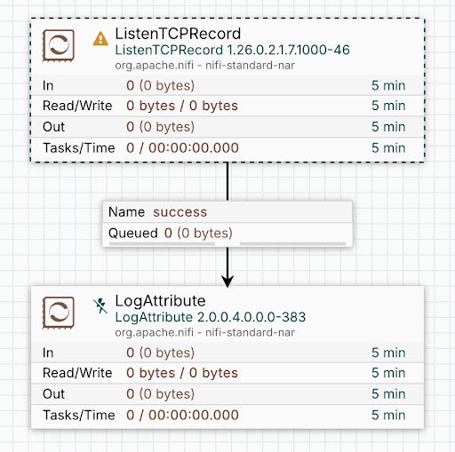

      In this example, you can see the following manual-change-request entry.
      	"sequence" : 6,
      	"type" : "manual-change-request",
      	"message" : "The component has been deprecated. It is suggested to replace it with a combination of [org.apache.nifi.processors.standard.ListenTCP] and [org.apache.nifi.processors.standard.ConvertRecord] processors",
      	"context" : {
      1. To identify the processor affected by these changes, search for the identifier value of the “subject” element in NiFi’s search box. It refers to the ListenTCPRecord processor.
      2. Open the TCP Listener process group. You can see that the processor is marked with dashed borders and its version number still shows that of the NiFi 1 instance. It means that it is a "ghost processor", not available in NiFi 2. The log message suggests replacing it with a combination of ListenTCP and ConvertRecord processors.
      3. Instantiate and configure the ListenTCP and ConvertRecord processors, connect them appropriately, and then remove the ghost processor.
