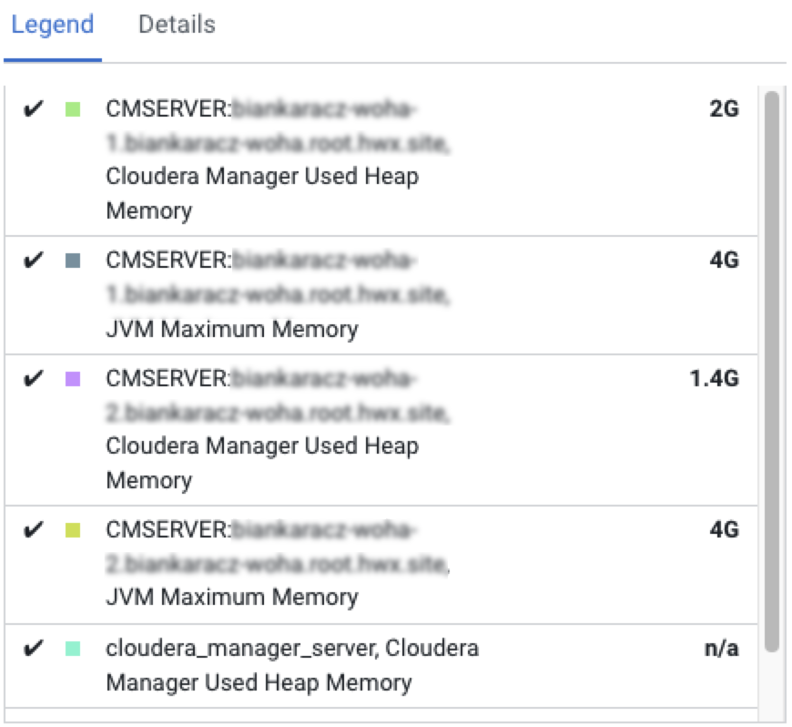

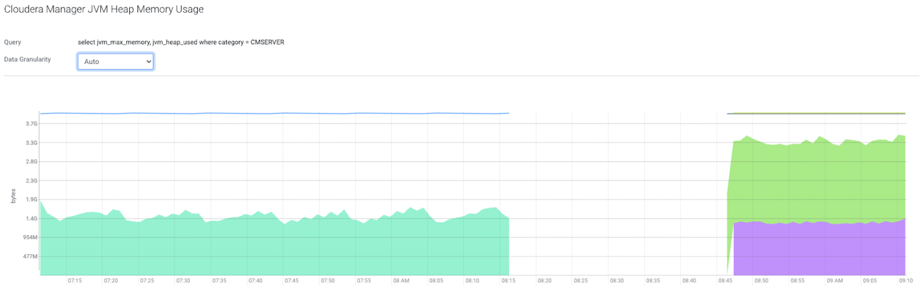

Changes in Health Tests
On HA-mode compatible versions, the naming of the Cloudera Manager server entities has changed to distinguish between multiple instances. This change will impact the customers that are upgrading from an earlier version.
In the earlier versions, the Cloudera Manager server name was
cloudera_manager_server, which changed to
CMSERVER:{Cloudera Manager server's host
name}.Due to this name convention change, you
will observe in the chart below that the Cloudera Manager server has a
new name and color on the charts. Meanwhile, the metrics for the old
entity name are still available.
The cyan area in the chart represents the single Cloudera Manager server running in non-HA mode. The green and purple areas represent the 2 Cloudera Manager servers with HA enabled.
The metrics are still available with the old entity name (cloudera_manager_server) after an upgrade to an HA-compatible version.
