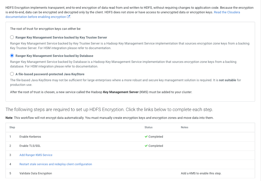

This task uses the Set up HDFS Data At Rest Encryption wizard to install a Ranger KMS that uses a database as the backing key store.
The following image shows the Set up HDFS Data At Rest Encryption page. When you select your encryption keys root of trust option, a list of tasks that you must do to enable encryption to-and-from HDFS is displayed.
You complete each task independently from the other tasks. Where, the task’s Status column indicates whether the step has been completed and the Notes column provides additional context for the task. If your Cloudera Manager user account does not have sufficient privileges to complete a task, the Notes column indicates the privileges that are required.
