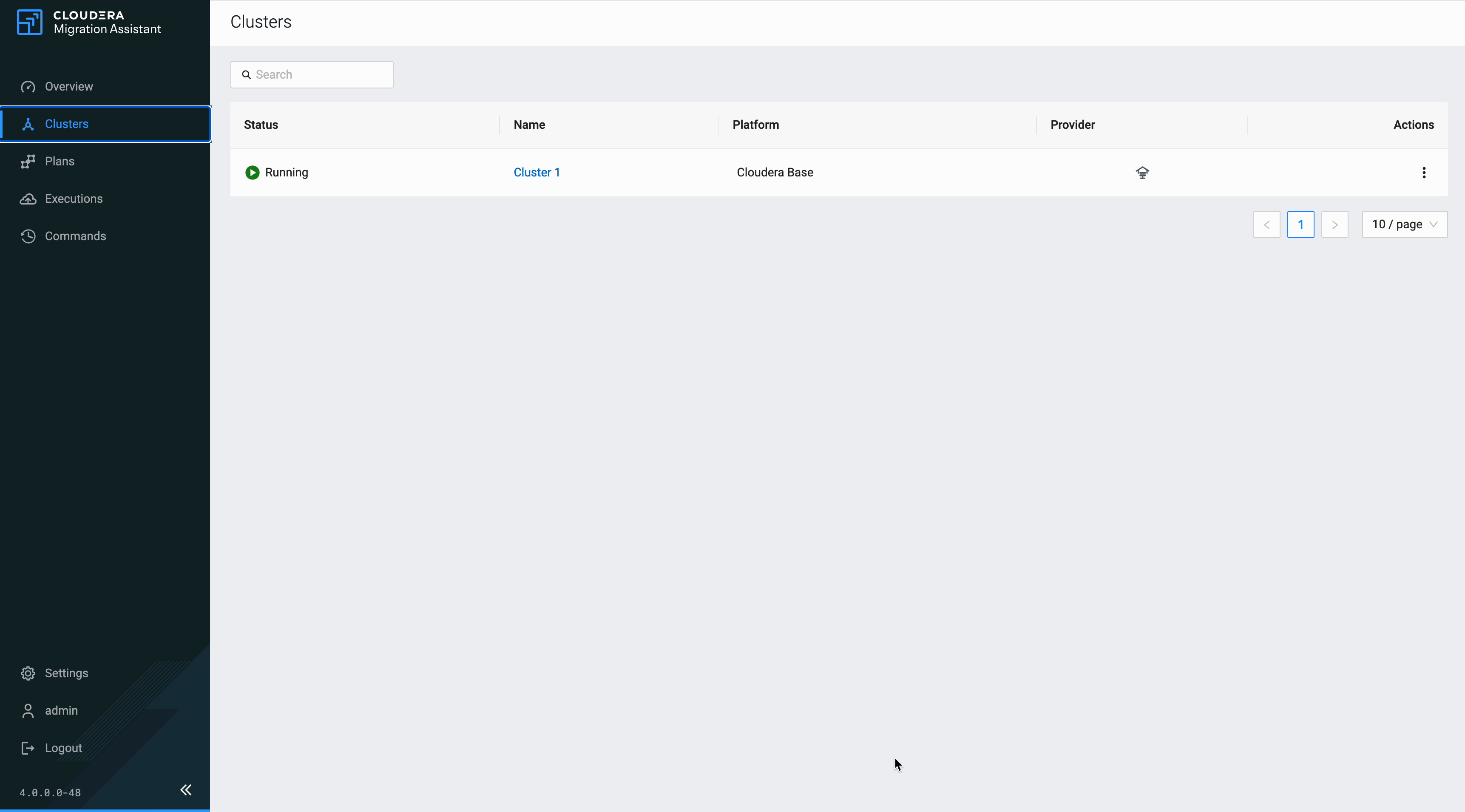

  1. Navigate to the Clusters page and click the cluster you want to scan.
    Figure 1. Cloudera Migration Assistant Clusters page

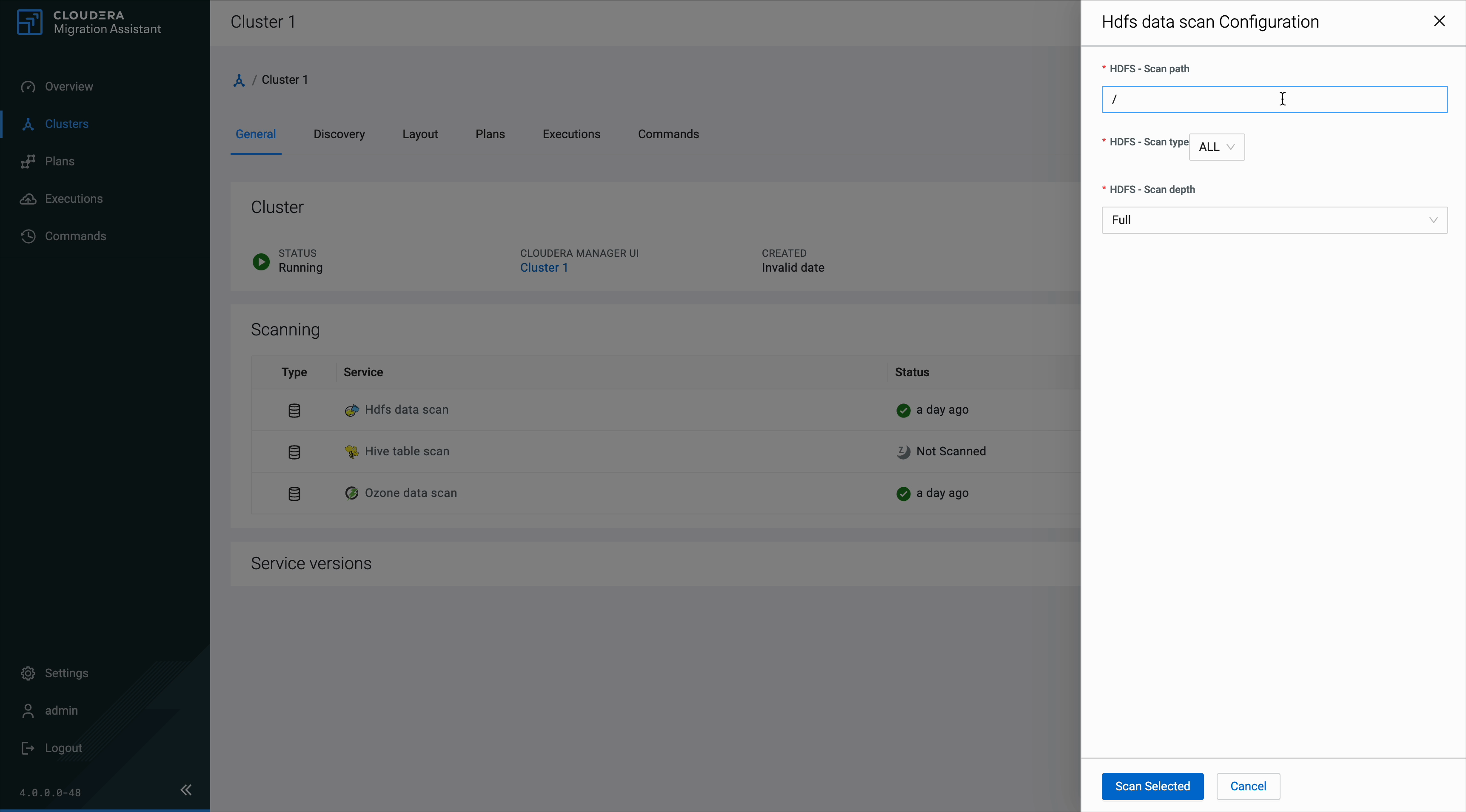

  2. On the cluster detail page, find the Scanning section, which lists the available scan types for your cluster. Click the configuration icon on the right side of the scan type you want to trigger.
    Figure 2. Cloudera Migration Assistant cluster scanning

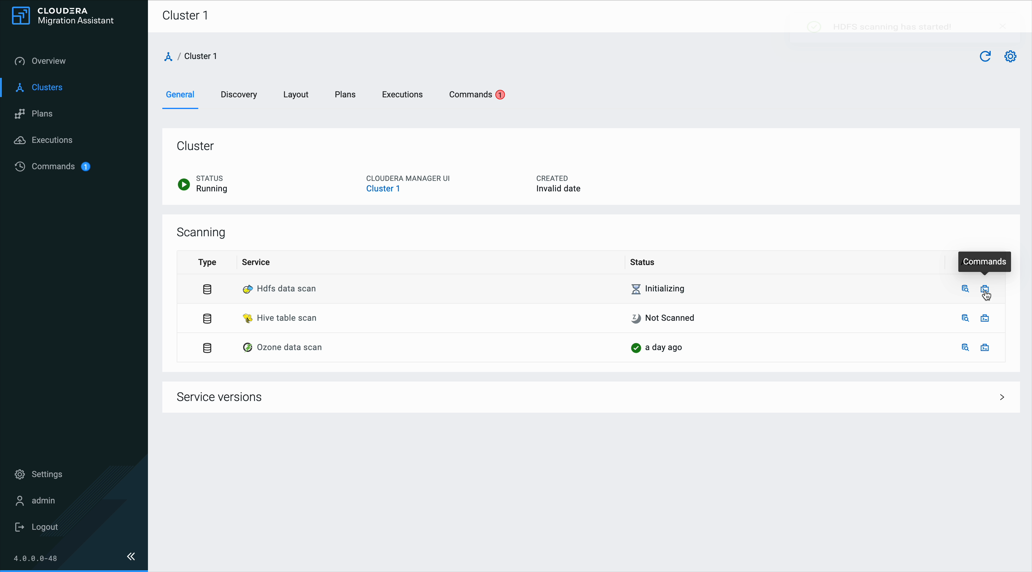

  3. In the scan configuration drawer, configure the scan parameters (for example, scan path, scan type, scan depth) and click Scan Selected.
    Figure 3. Cloudera Migration Assistant scan configuration

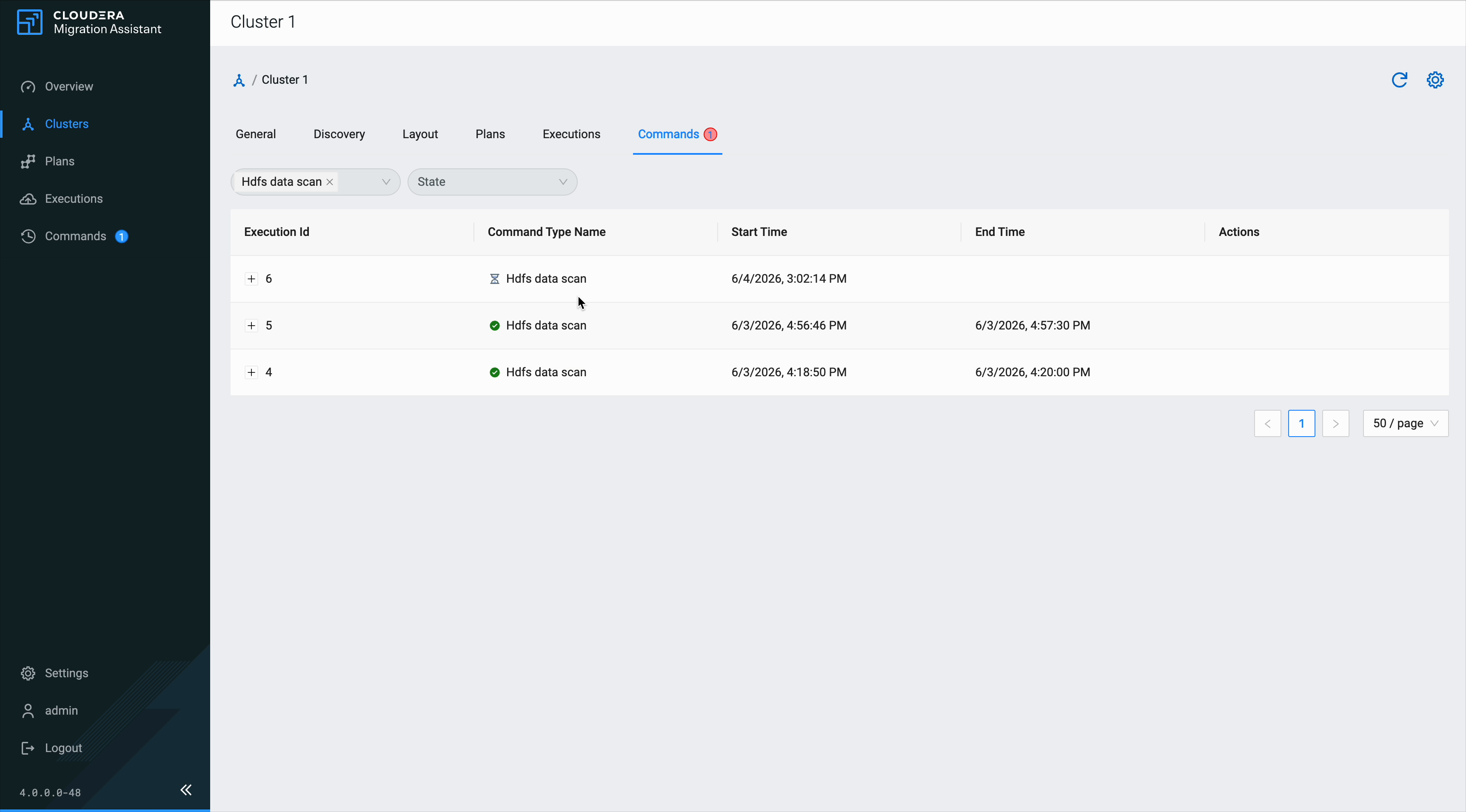

  4. The scan starts and the status changes to Initializing. Track scan progress by clicking the Commands tab, which shows a badge with the number of active commands.
    Figure 4. Cloudera Migration Assistant scan in progress

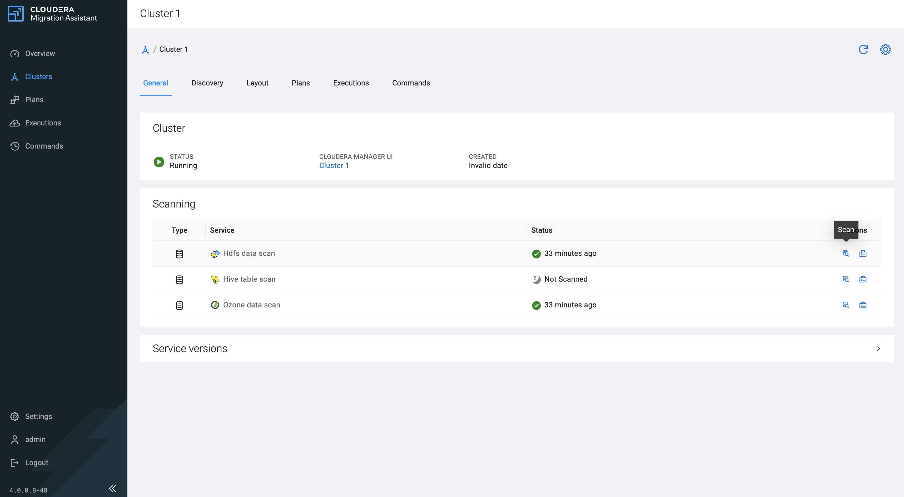

  5. On the Commands tab, expand a command to view its Output Log, Error Log, and Configuration.
    Figure 5. Cloudera Migration Assistant scan commands
Selected datasets and workloads on the scanned cluster finish cataloging according to the scan types you triggered.
