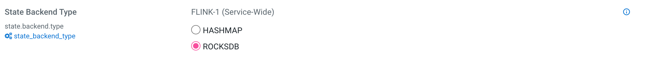

You can configure the state backend for your streaming application using Cloudera Manager or you can also specify the state backend in your Flink application.
- Open your cluster in Cloudera Manager.
 - Select Flink from the list of services.
 - Click Configuration.
 - Search for
state.backendand select HASHMAP or ROCKSDB based on your requirements. ROCKSDB is set by default.
                                     - Click Save changes.
- The per-job state backend can be configured by setting the
env.setStateBackendtoHashMapStateBackendorEmbeddedRocksDBStateBackendon theStreamExecutionEnvironmentof the job as shown in the following example:StreamExecutionEnvironment env = StreamExecutionEnvironment.getExecutionEnvironment(); env.setStateBackend(new EmbeddedRocksDBStateBackend());StreamExecutionEnvironment env = StreamExecutionEnvironment.getExecutionEnvironment(); env.setStateBackend(new HashMapStateBackend());

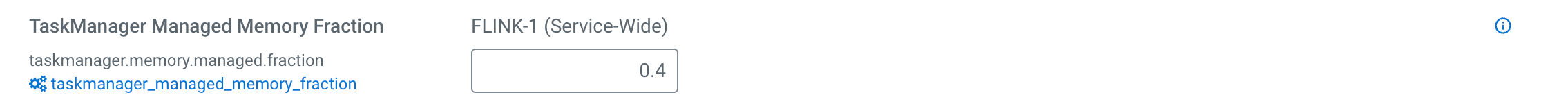

When choosing RocksDB as state backend, you can also adjust how much memory RocksDB should use as a cache to increase lookup performance by setting the memory managed fraction of the TaskManagers.
The default fraction value is 0.4, but with larger cache requirements you need to increase this value together with the total memory size. For more information, see the Set up TaskManager Memory and the Memory Tuning Guide documentations:
 - Search for
taskmanager.memory.managed.fractionand change the default value as needed.

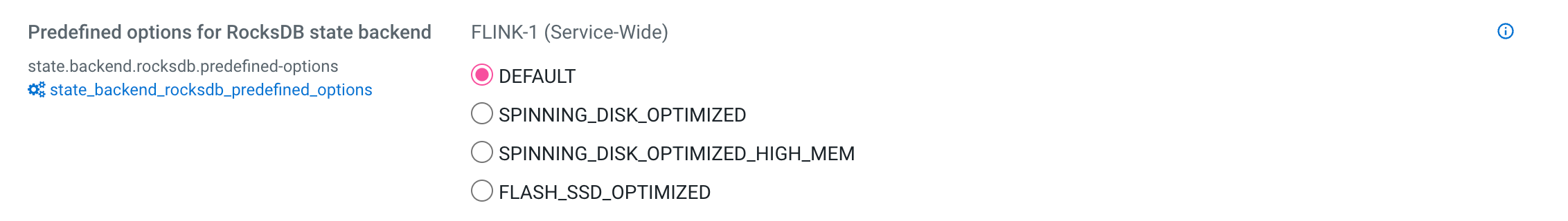

DEFAULT: option set by default and applicable for all settings.SPINNING_DISK_OPTIMIZED: option for regular spinning disks configured for better performance. The option is configured with the following values:CompactionStyle=LEVELLevelCompactionDynamicLevelBytes=trueMaxBackgroundJobs=4MaxOpenFiles=-1
SPINNING_DISK_OPTIMIZED_HIGH_MEM: option for regular spinning hard disks configured for better performance, but with higher memory consumption. The option is configured with the following values:BlockCacheSize=256 MBytesBlockSize=128 KBytesFilterPolicy=BloomFilterLevelCompactionDynamicLevelBytes=trueMaxBackgroundJobs=4MaxBytesForLevelBase=1 GByteMaxOpenFiles=-1MaxWriteBufferNumber=4MinWriteBufferNumberToMerge=3TargetFileSizeBase=256 MBytesWriteBufferSize=64 MBytes
FLASH_SSD_OPTIMIZED: option for flash SSDs configured for better performance. The following additional options are set:MaxBackgroundJobs=4MaxOpenFiles=-1
 - Search for
state.backend.rocksdb.predefined-optionsand change the default value as needed.
- Update the
EmbeddedRocksDBStateBackendfor theStreamExecutionEnvironmentof the Flink job as shown in the following example:EmbeddedRocksDBStateBackend.setPredefinedOptions(PredefinedOptions.SPINNING_DISK_OPTIMIZED_HIGH_MEM)
