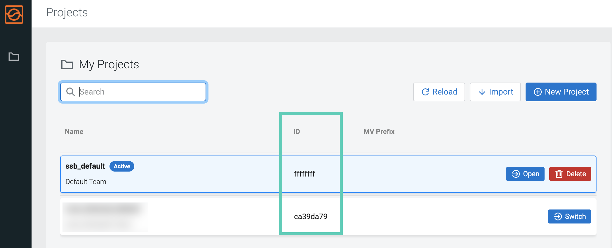

Accessing the project ID
        GET /api/v2/projects call in CLI to list all
        projects that the user has access to.Using REST API Tool

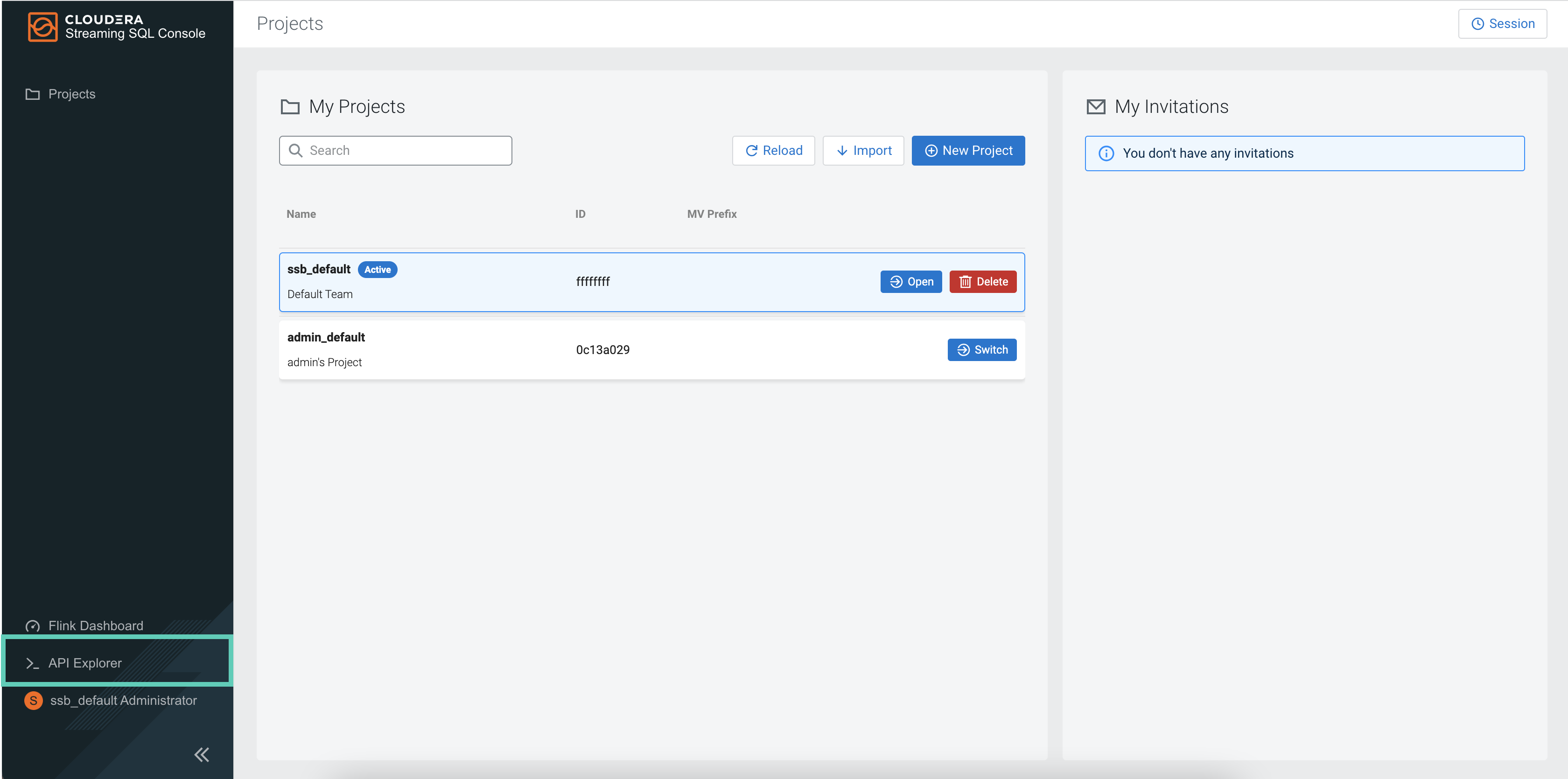

Using Swagger UI
You can access the Swagger UI to use the Cloudera SQL Stream Builder REST API by adding your hostname and the Streaming SQL Engine port to the Swagger UI URL.
http(s)://[***CLUSTER_DOMAIN***]:[***STREAMING_SQL_ENGINE_SERVER_PORT***]/swagger-ui/index.html?configUrl=/swagger/api-docs/swagger-config
   You can also download the swagger.json for the Cloudera SQL Stream Builder REST API using the Swagger
    UI.
