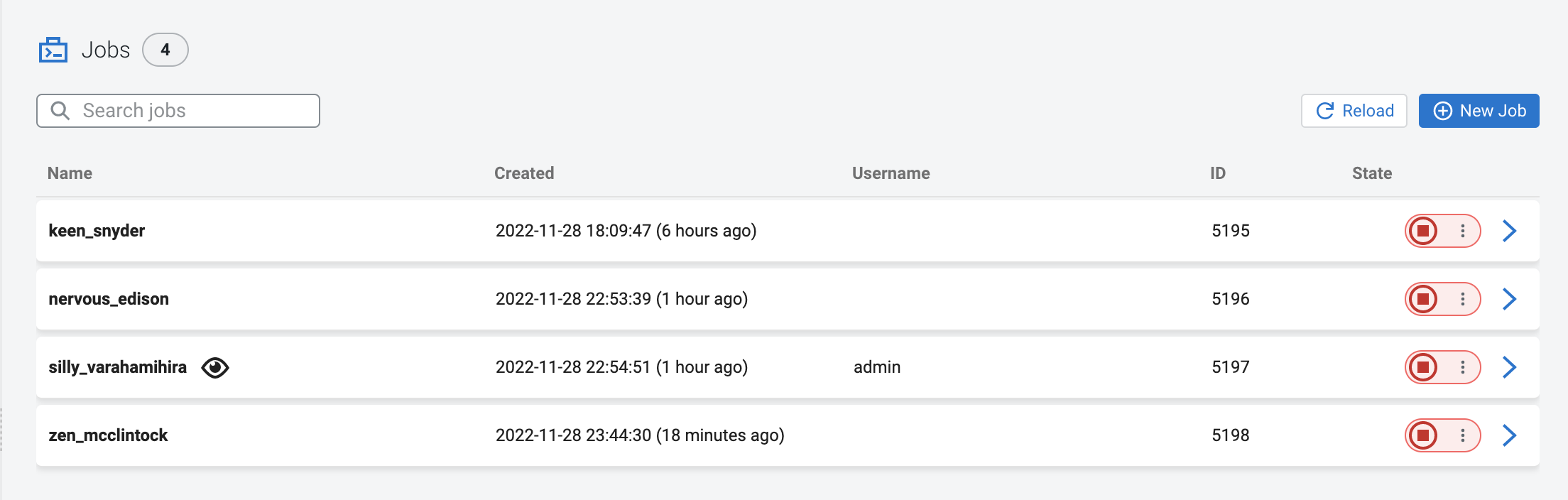

When using the Jobs tab in Streaming SQL Console to monitor your SQL
jobs, you can review the ID, the Name, the Start time, the State of the submitted jobs, and
the User who submitted the SQL job.
Click next to Jobs.
Select Manage.
By default, all of the jobs are displayed on
the Jobs tab.

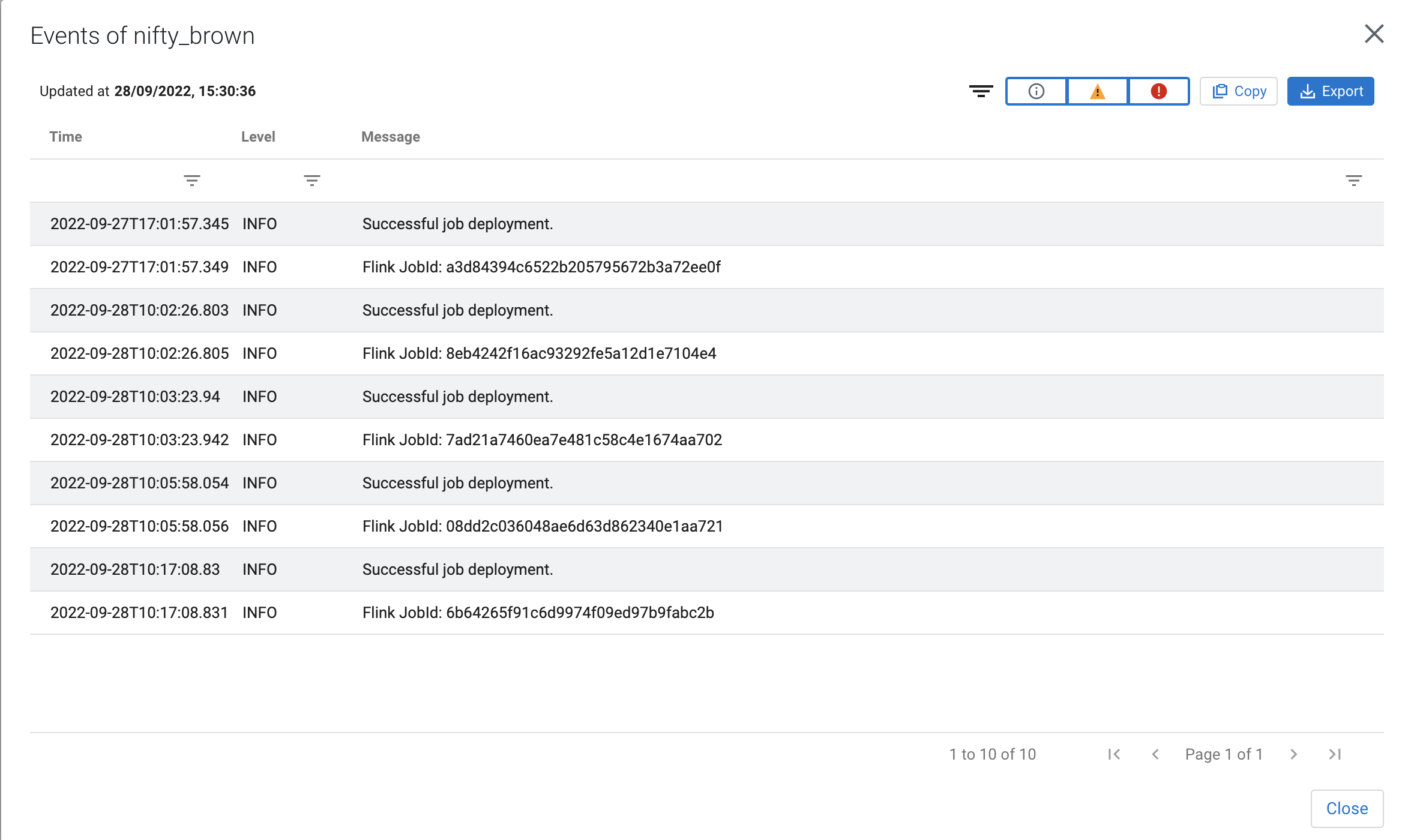

Click .
Select Events.
The Events window appears
detailing the Flink job information that can be further filtered based on the log
level settings.
