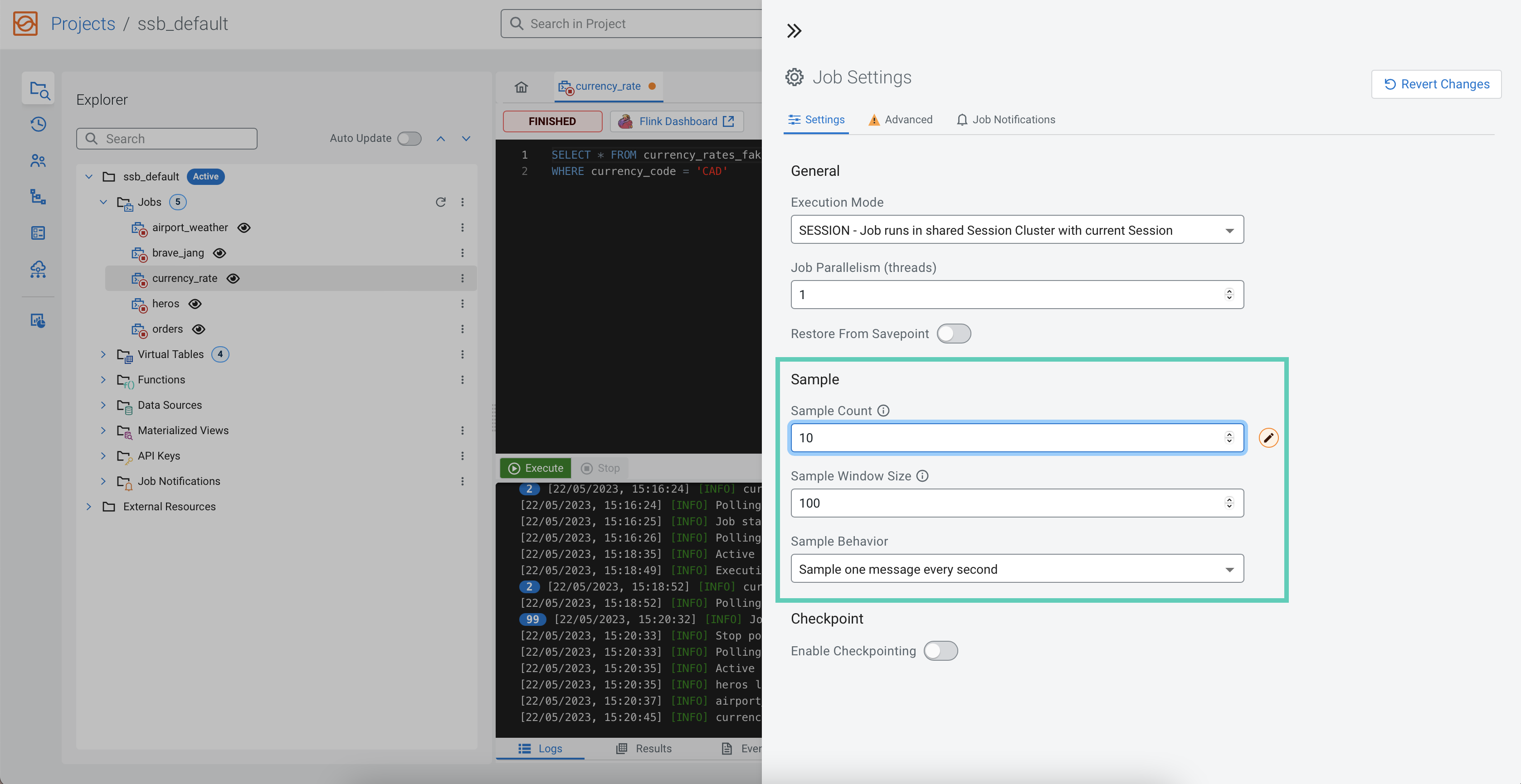

Samples as data source🔗
When using sampling as a data source, you must have a running job on Streaming SQL Console,
which produces sampling data as the job runs. You can change the default sampling behavior at
the Job Settings that affects the frequency, count and the sample window
size of the sampled messages.

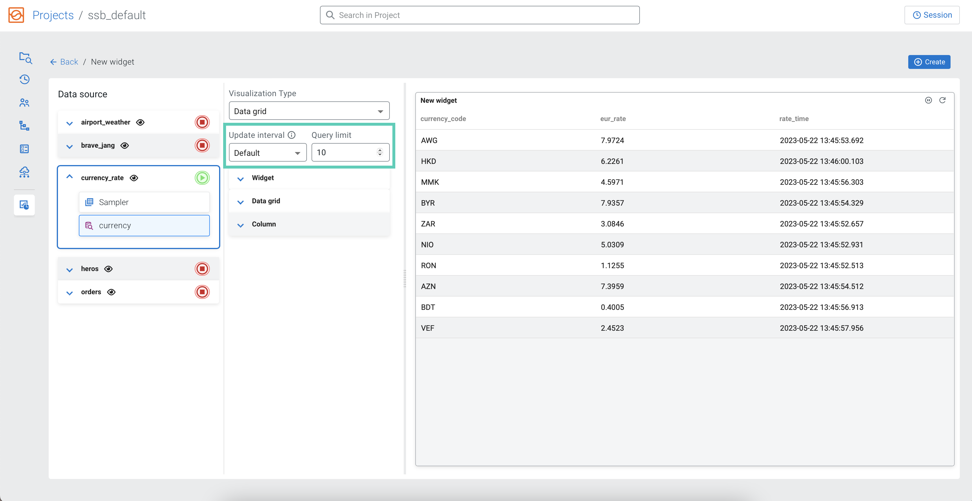

Materialized View as data source🔗
When using Materialized View as a data source, you must have a running job with a Materialized
View query. The Materialized View endpoint is called in a period of time according to the update
interval and query limit configured for the widget.
Update interval
The update interval is the time the widgets waits to call from the endpoint.
Query limit
The query limit sets the maximum amount of records to be returned for each call
If the update interval
is set to Default, the update interval can be specified on the
Dashboard after the widget is created. The time selected on the
Dashboard will be applied to every widget that has
Default configured for update interval.
