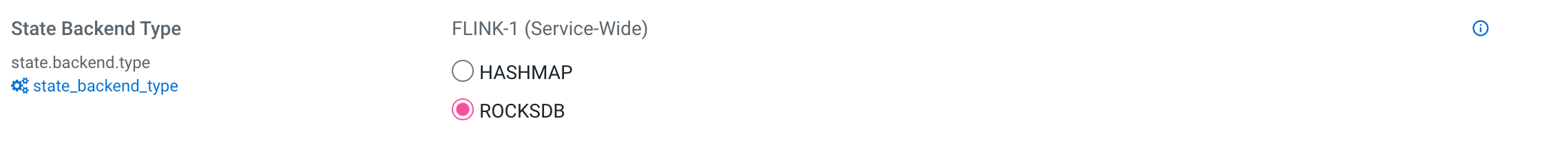

You can configure the state backend for your streaming application using Cloudera Manager or you can also specify the state backend in the SQL editor in Streaming SQL Console.
  1. Open your cluster in Cloudera Manager.
  2. Select Flink from the list of services.
  3. Click Configuration.
  4. Search for state.backend and select HASHMAP or ROCKSDB based on your requirements. ROCKSDB is set by default.
  5. Click Save changes.
