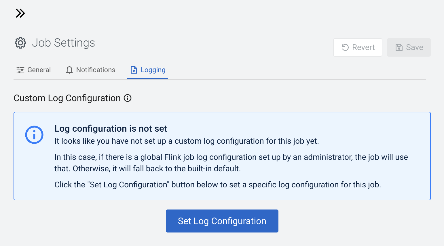

  3. Click Logging.
  4. Click Set Log Configuration.

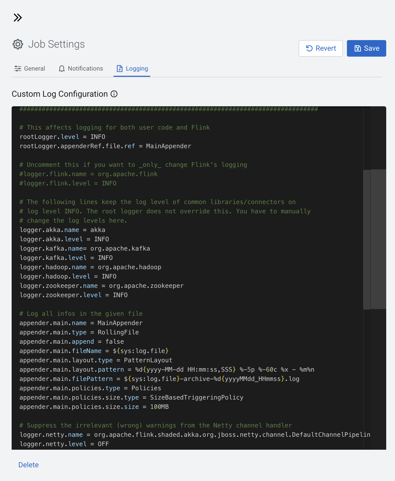

  5. Modify the settings based on your requirements.
  6. Click Save. (You can restore the default logging configuration through clicking Delete and Set Log Configuration again.)
