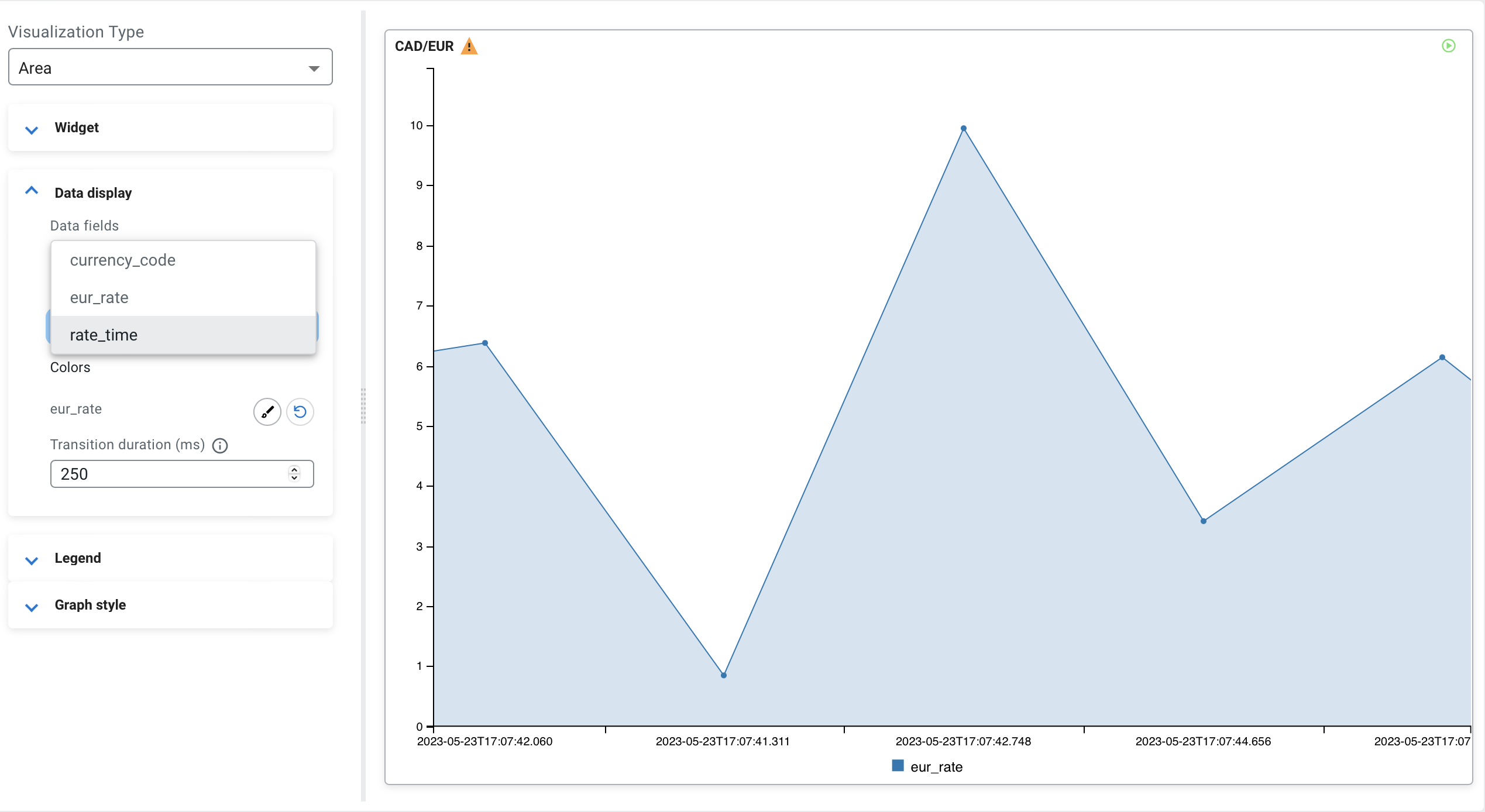

   You can reset the color of the visualization using the
 button.

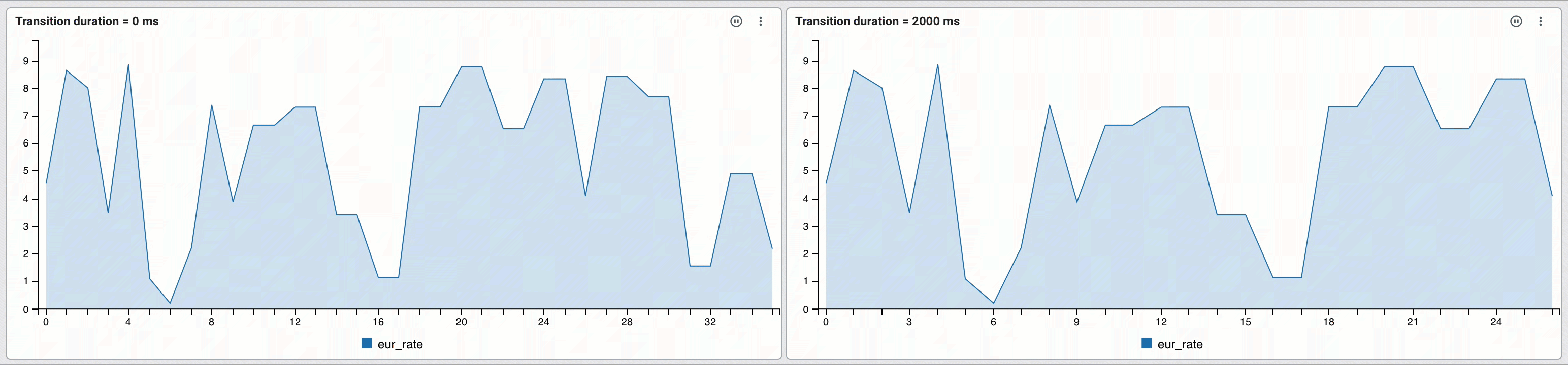

Transition duration (ms)

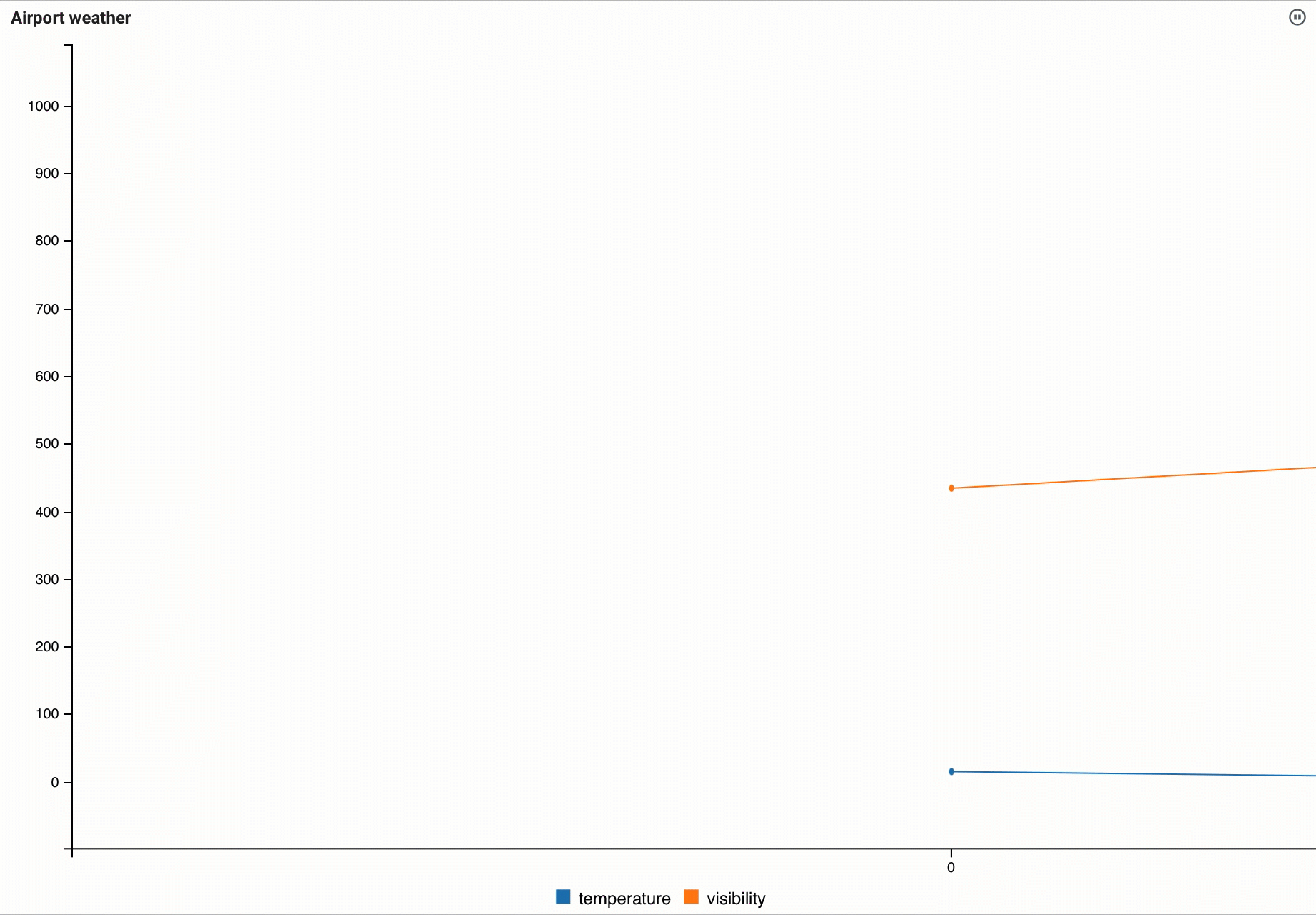

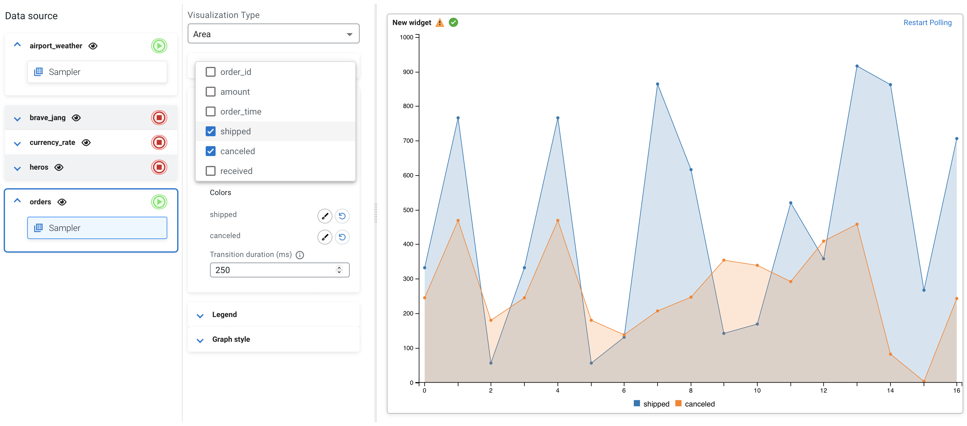

Configuring graph style
You can customize the styles of the widgets based on how you want to visualize the data.

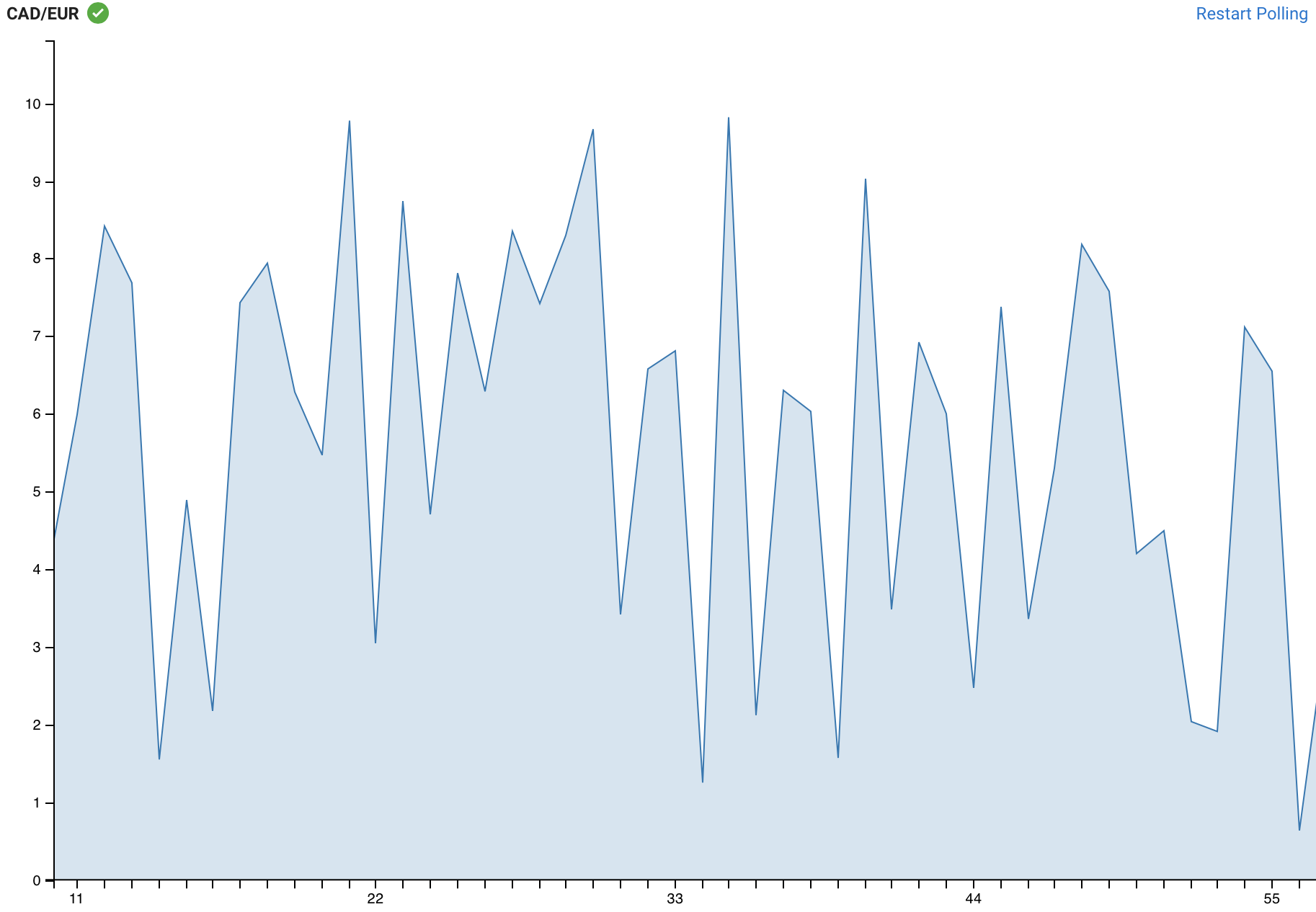

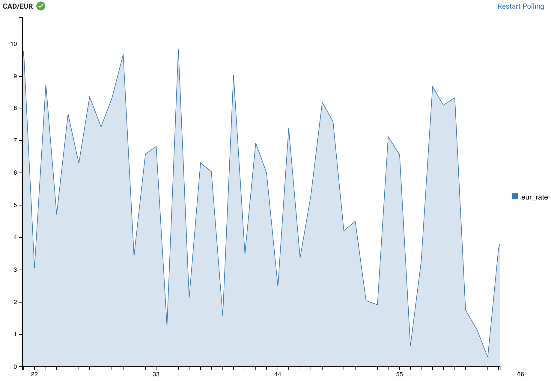

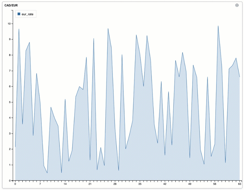

Visualization type: Area
You can use the Area visualization type when you want to show how the values changed over a period of time.
  CREATE TABLE currency_rates (
  `currency_code` VARCHAR(2147483647),
  `eur_rate` DECIMAL(6, 4),
  `rate_time` TIMESTAMP(3)
) WITH (
  'fields.currency_code.expression' = '#{Currency.code}',
  'fields.rate_time.expression' = '#{date.past ''15'',''SECONDS''}',
  'connector' = 'faker',
  'rows-per-second' = '100',
  'fields.eur_rate.expression' = '#{Number.randomDouble ''4'',''0'',''10''}'
SELECT * FROM currency_rates
WHERE currency_code = 'CAD'| Name | CAD/EUR |
| Data fields | eur_rate |
| Legend poition | Inset |
| Line interpolation | Area |
| Connect null | enabled |
| Show points | disabled |

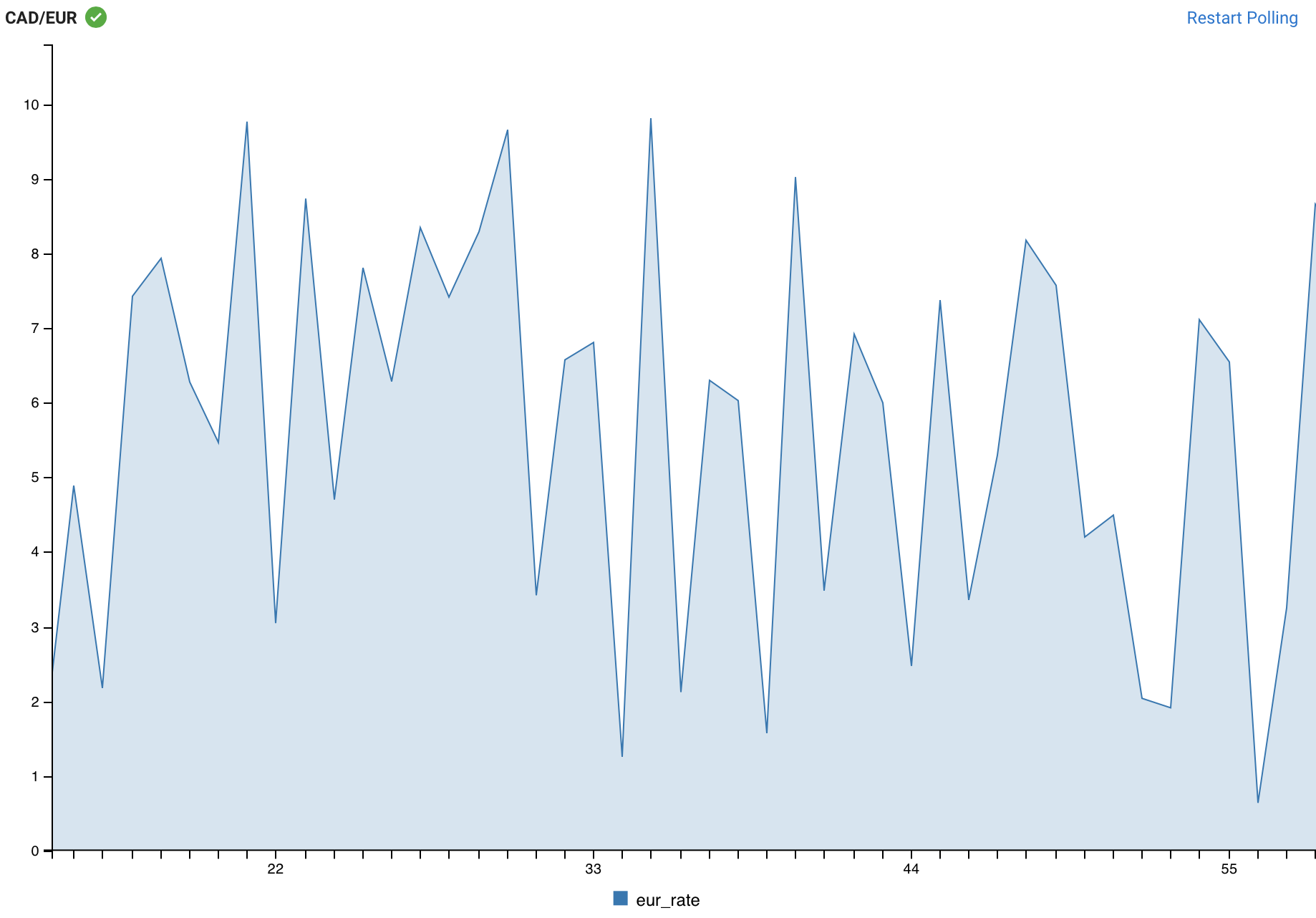

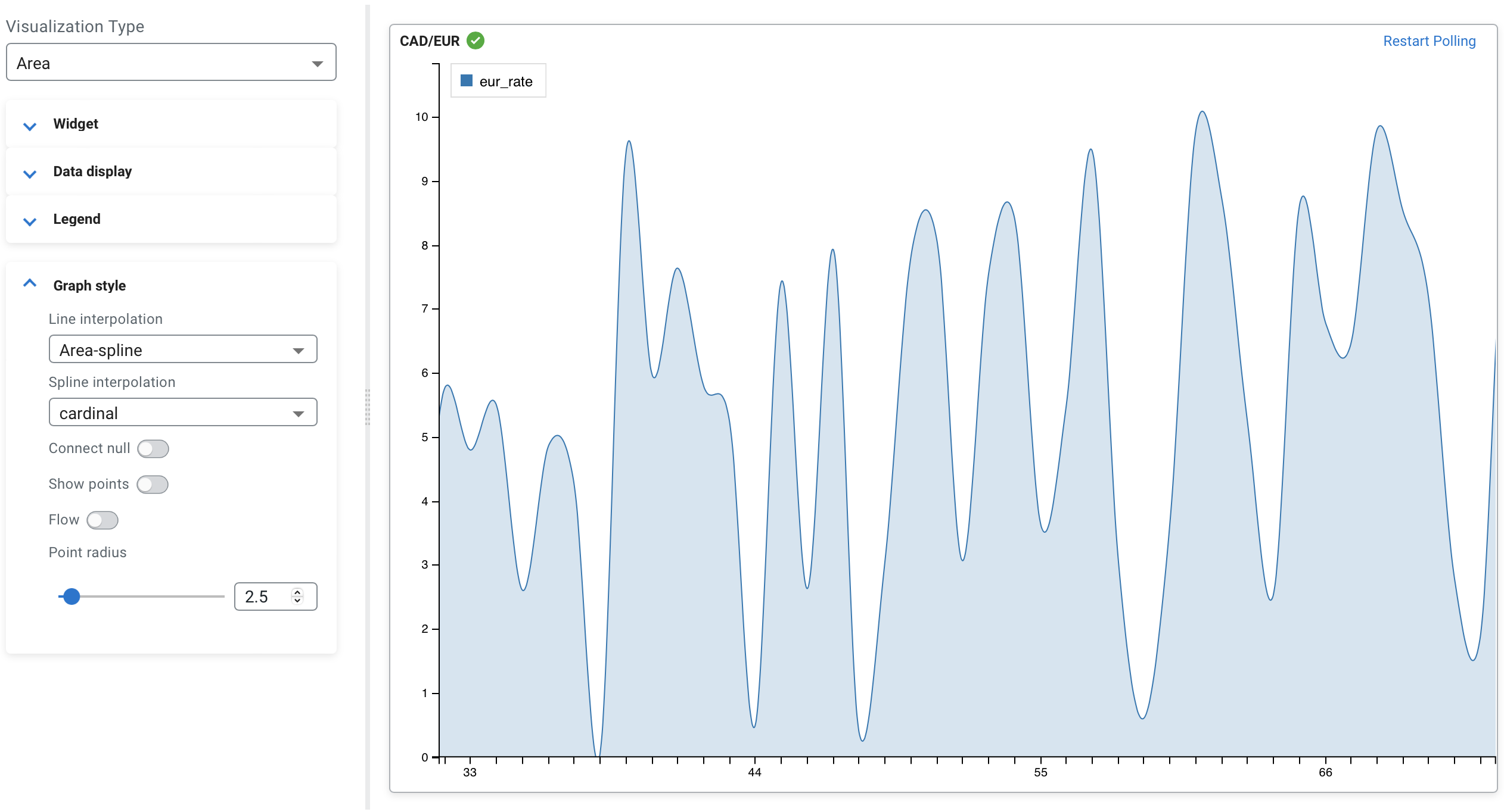

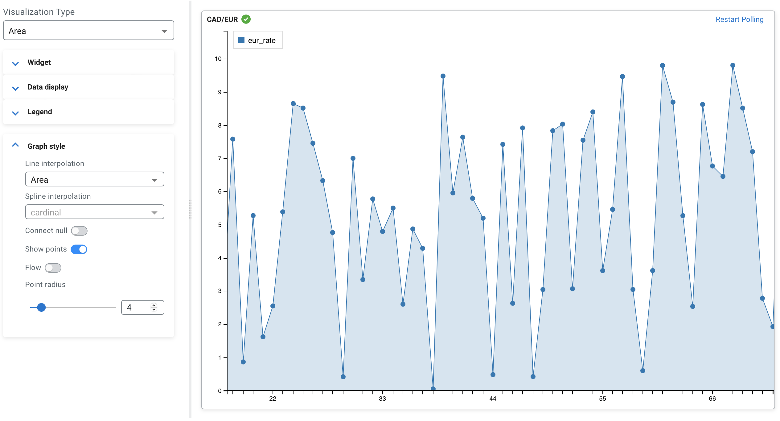

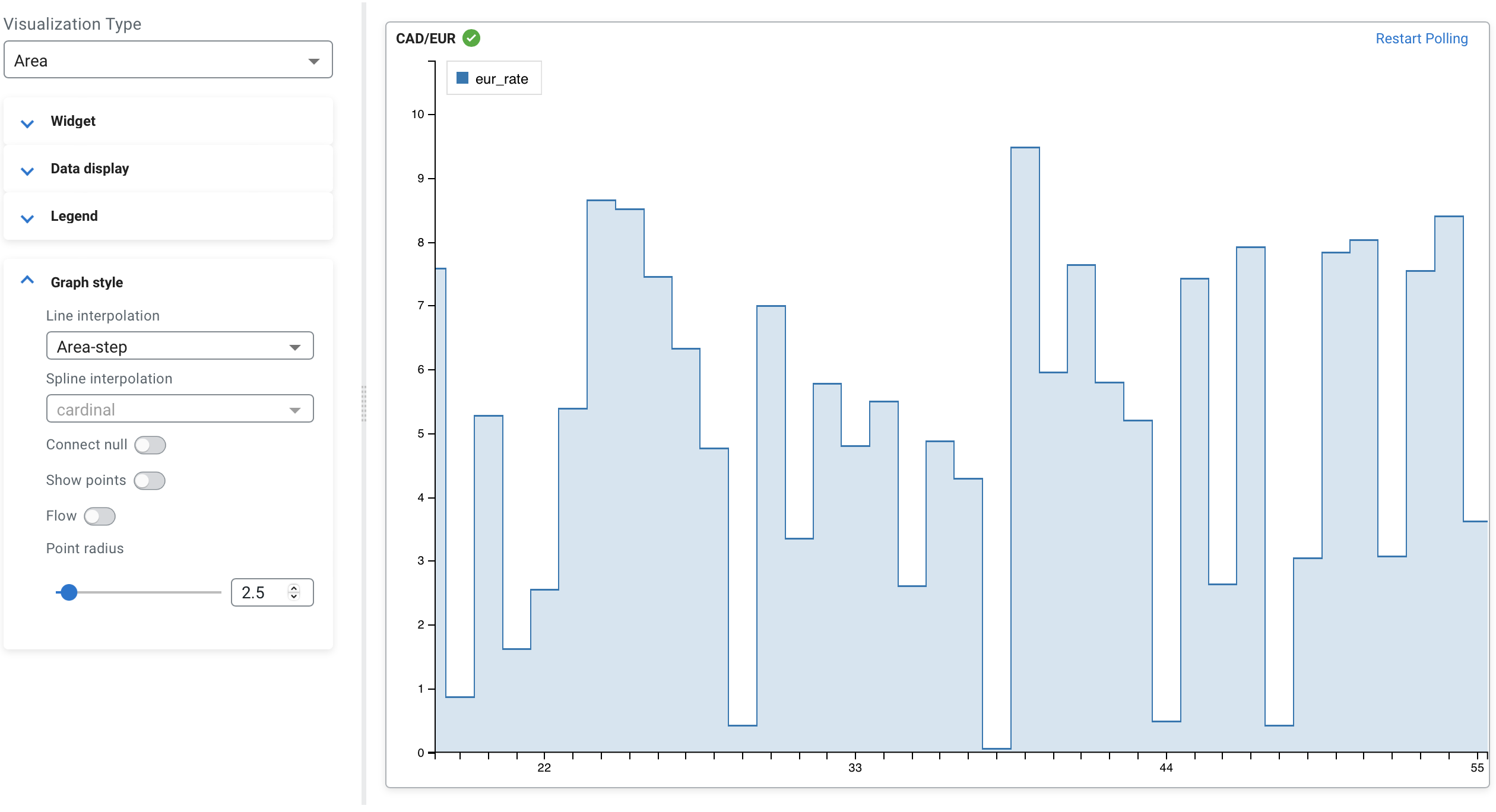

- Line interpolation
 - Determines the line interpolation of the visualization. You have the option to select Area-spline and Area-step for line interpolation.
 - Show points and Point radius
 - You can enable whether to show each data point in line using the Show
       points toggle. The size of the points can be changed using the Point
       radius configuration, which is set to 2.5 by default. The
      following example shows the enabled Show points with 4.0 Point radius:

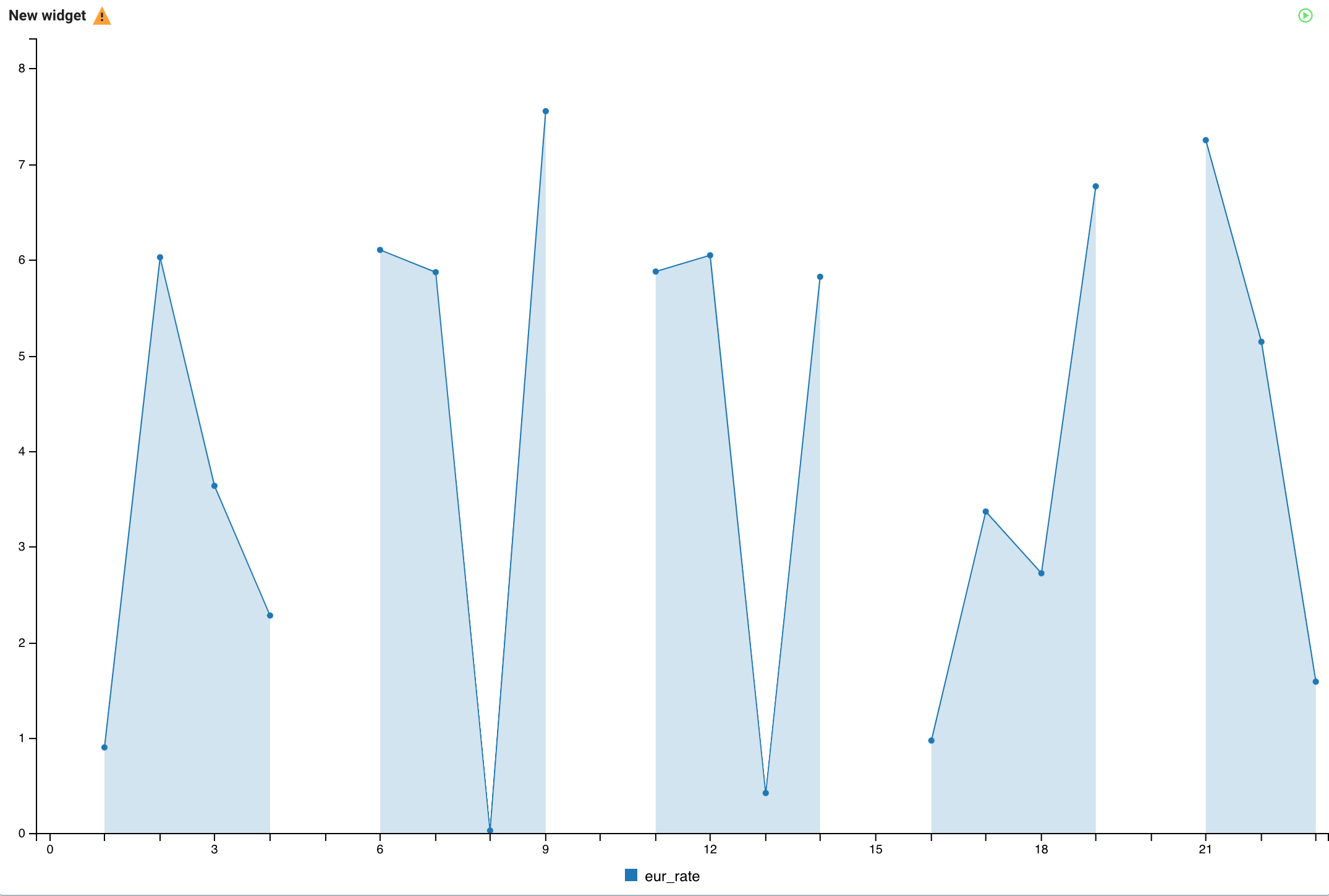

       - Connect null
 - Using the connect null configuration, you can set if the null data points are connected or
      not. If enabled, the region of the null data is connected without any data point. When
      disabled, the data points are not connected as shown in the following example:
       - Flow
 - You can set the movement of the data by enabling or disabling the Flow function, which
      means the new data points flow to the chart from the right side compared to arriving
      periodically as processed on the widget.

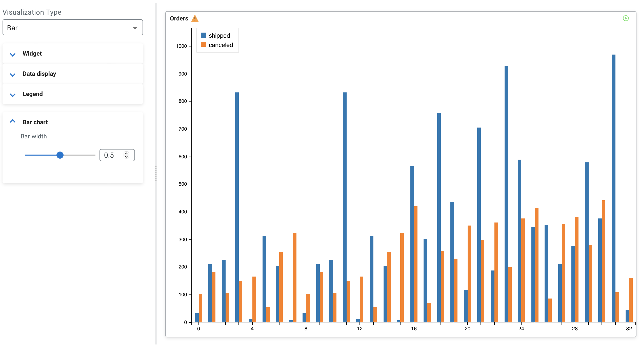

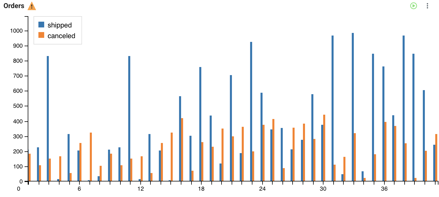

Visualization type: Bar
You can use the Bar visualization type when you want to show how the data is distributed or want to compare the data between different groups.
    CREATE TABLE orders (
  `order_id` INT,
  `amount` INT,
  `order_time` TIMESTAMP(3),
  `shipped` VARCHAR(2147483647),
  `canceled` VARCHAR(2147483647),
  `received` VARCHAR(2147483647),
  WATERMARK FOR `order_time` AS `order_time` - INTERVAL '15' SECOND
) WITH (
  'fields.order_time.expression' = '#{date.past ''15'',''SECONDS''}',
  'fields.amount.expression' = '#{number.numberBetween ''0'',''100''}',
  'fields.order_id.expression' = '#{number.numberBetween ''0'',''99999999''}',
  'fields.shipped.expression' = '#{number.numberBetween ''0'',''1000''}',
  'fields.received.expression' = '#{number.numberBetween ''0'',''800''}',
  'fields.canceled.expression' = '#{number.numberBetween ''0'',''500''}',
SELECT * FROM orders| Name | Orders |
| Data fields | shipped, canceled |
| Bar width | 0.5 |
- Bar width
 - You can specify the width of the bars on the widget by changing the default value.

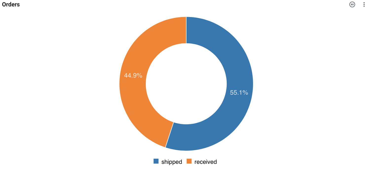

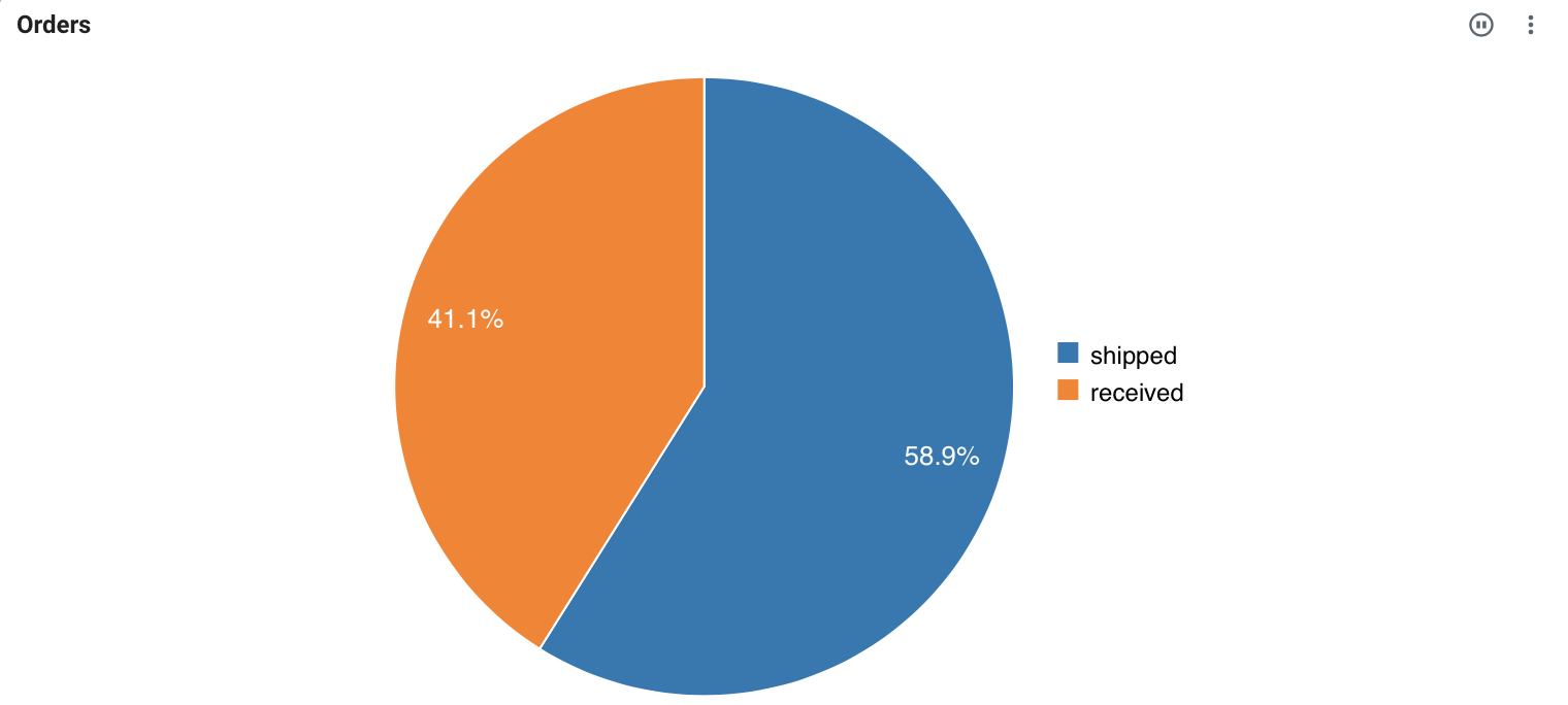

Visualization type: Donut
You can use the Donut visualization type when you want to show the proportions of data within a category where the size of the pieces represent the proportion of each category.
  `order_id` INT,
  `amount` INT,
) WITH (
| Data fields | shipped, received |
| Legend poition | Bottom |
| Show label | enabled |
- Show label
 - You can enable or disable the labels on the visualization as shown in the following
            illustration where labels are disabled:

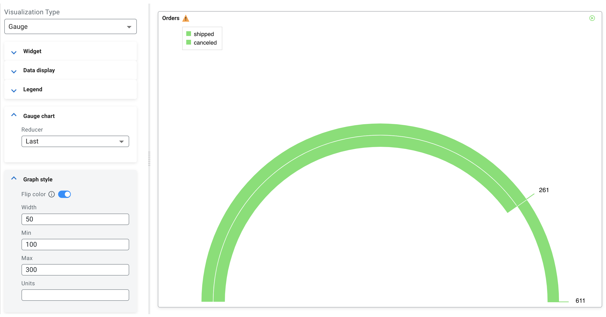

Visualization type: Gauge
You can use the Gauge visualization type when you want to show progress or amount compared to the maximum value.
  `order_id` INT,
  `amount` INT,
) WITH (
| Reducer | Last |
| Min | 100 |
| Max | 300 |
- Reducer
 - A reducer function that will be used to reduce many fields to a single value. You have
            the following options to choose from:
- Last
 - First
 - Min
 - Max
 - Total
 - All
 - Min, Max
 - You can specify the minimum and maximum value of the gauge chart.
             - Flip color
 - You can enable color switching based on the values set for minimum and maximum. When
            the values are larger than 75% of Max then the color of the widget changes to green.
            When the values are smaller than 25% of Min then the color of the widget changes to
              red.
             - Width
 - You can increase or decrease the width of the gauges on the widget.
             - Units
 - You can specify a unit for the displayed values on the widget.

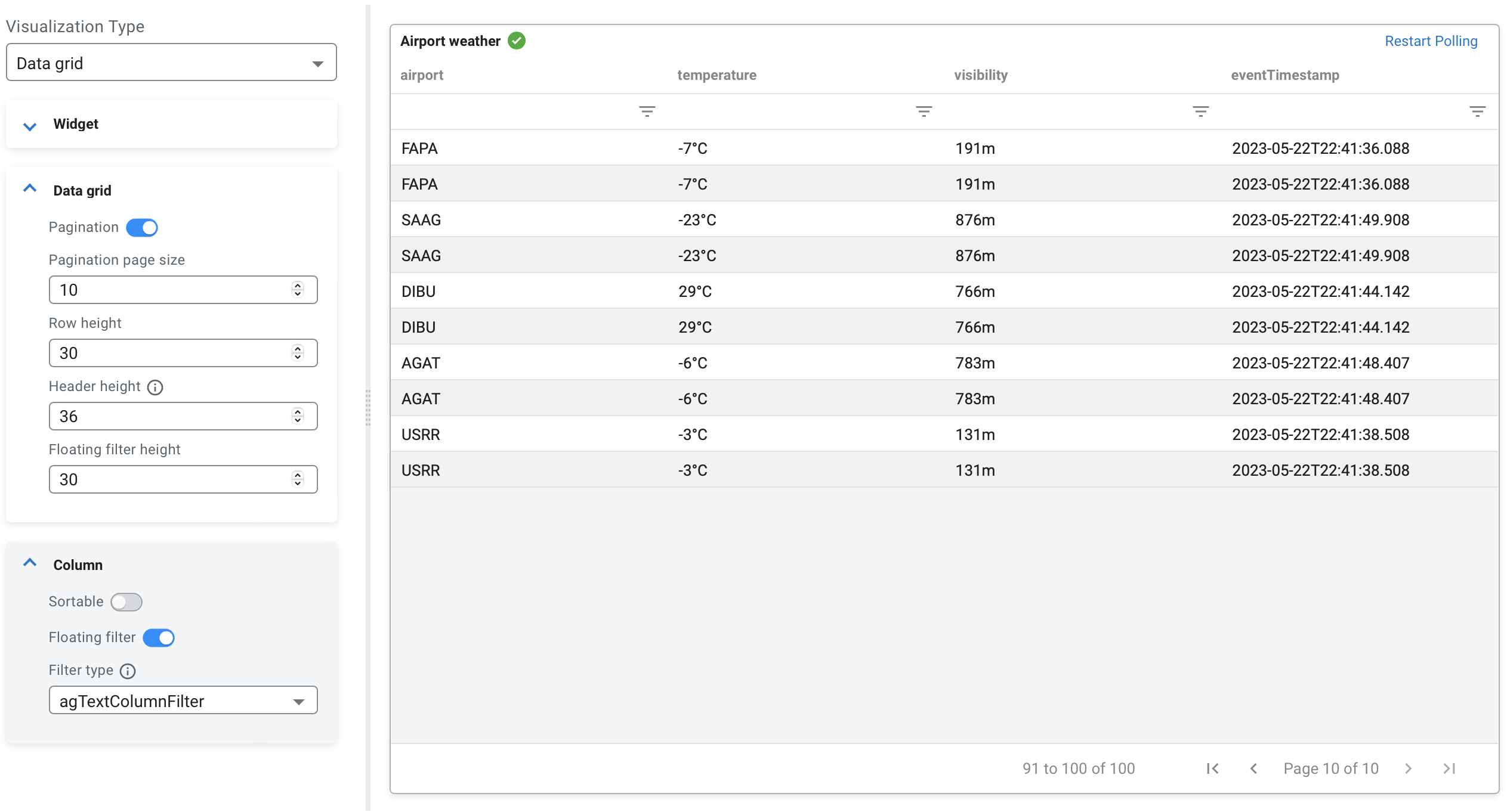

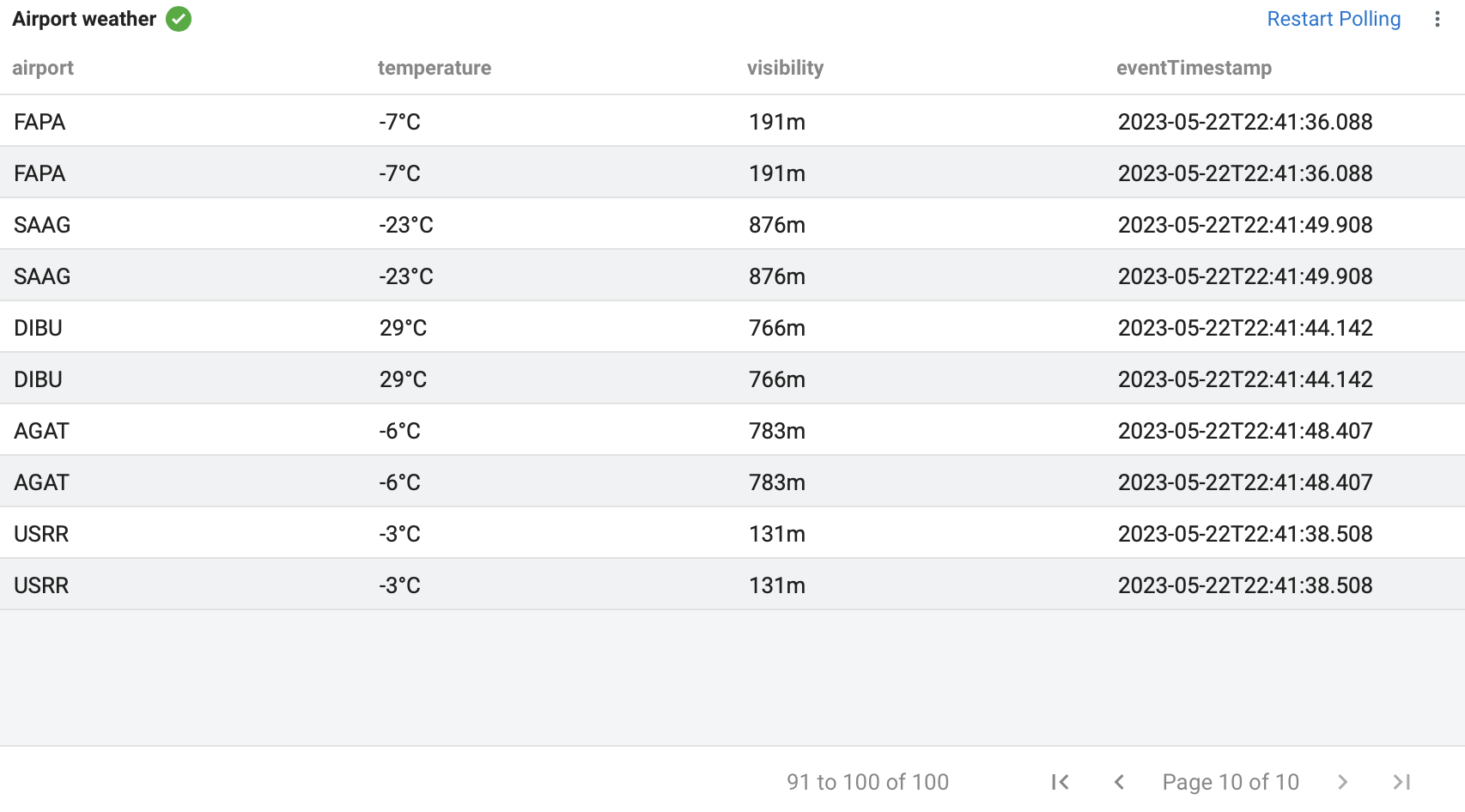

Visualization type: Data grid
You can use the Data grid visualization type when you want to show data in a table format.
    CREATE TABLE airport_weather (
  `airport` VARCHAR(2147483647) NOT NULL,
  `temperature` VARCHAR(2147483647) NOT NULL,
  `visibility` VARCHAR(2147483647) NOT NULL,
  `eventTimestamp` TIMESTAMP(3),
  WATERMARK FOR `eventTimestamp` AS `eventTimestamp` - INTERVAL '30' SECOND,
  CONSTRAINT `PK_-991666966` PRIMARY KEY (`airport`) NOT ENFORCED
) WITH (
  'fields.eventTimestamp.expression' = '#{date.past ''30'',''SECONDS''}',
  'fields.temperature.expression' = '#{Weather.temperatureCelsius}',
  'fields.airport.expression' = '#{Aviation.airport}',
  'fields.visibility.expression' = '#{numerify ''###m''}'
SELECT * FROM airport_weather| Name | Airport weather |
| Pagination | enabled |
| Page size | 10 |
| Row height | 30 |
| Header height | 36 |
| Sortable | disabled |

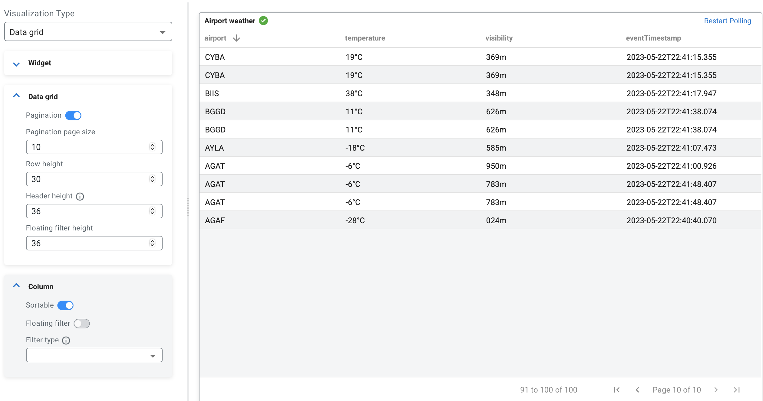

- Pagination and pagination page size
 - You can enable and disable the pagination of the data on the visualization where the
            page size provides the number of rows displayed.
             - Floating filter and floating filter height:
 - You can add floating filter to the data grid which enables text, number or date based
            filtering of the columns. For example, you can set the floating filter to text and
            filter the data to start with M:
             - Sortable
 - You can enable or disable sortable columns for the data grid. You can sort the data in
            the filtered column by clicking on the column name so the values are in increasing or
            decreasing order.

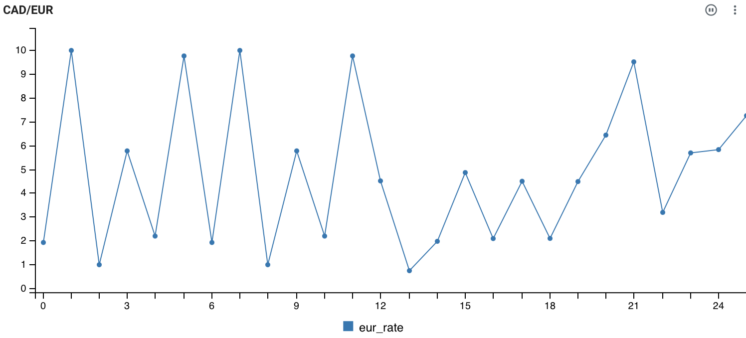

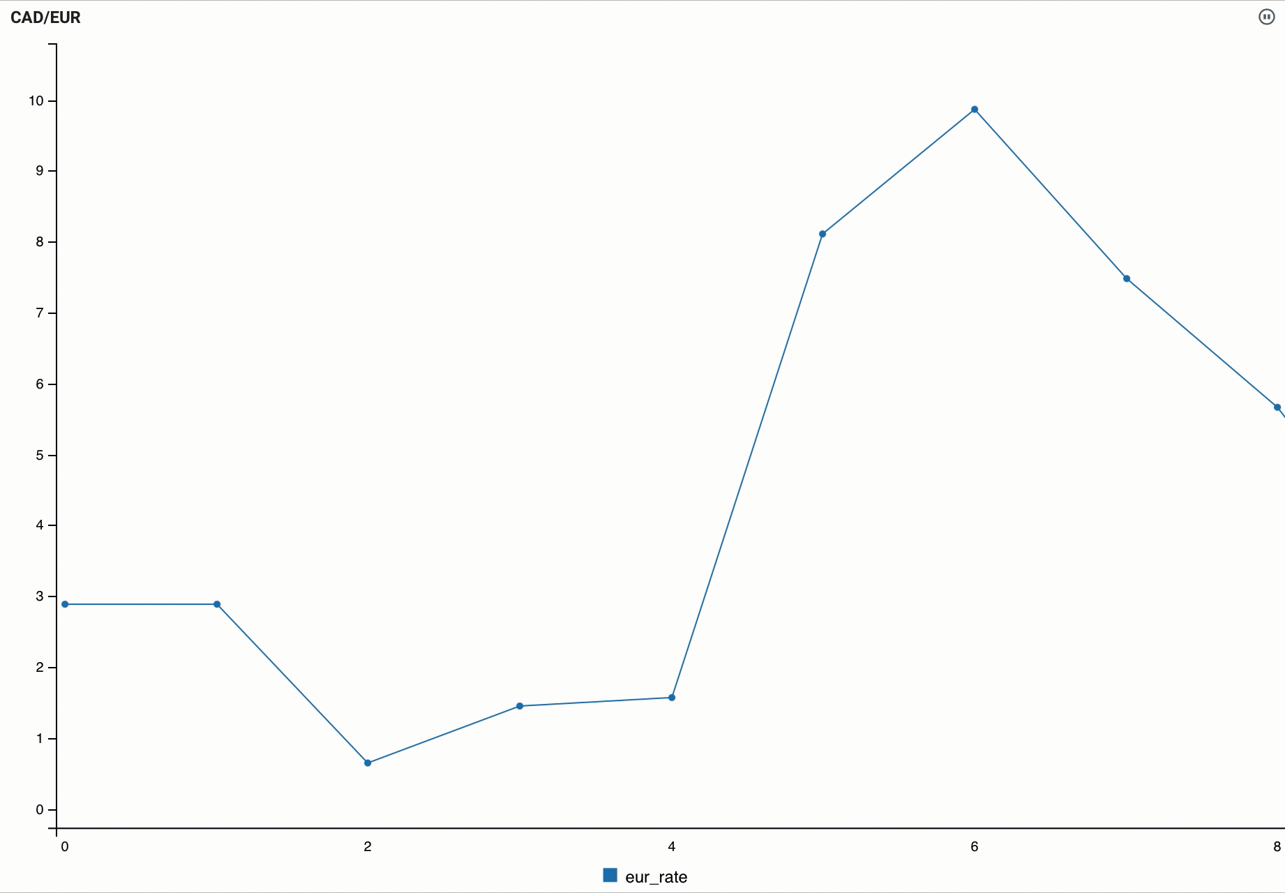

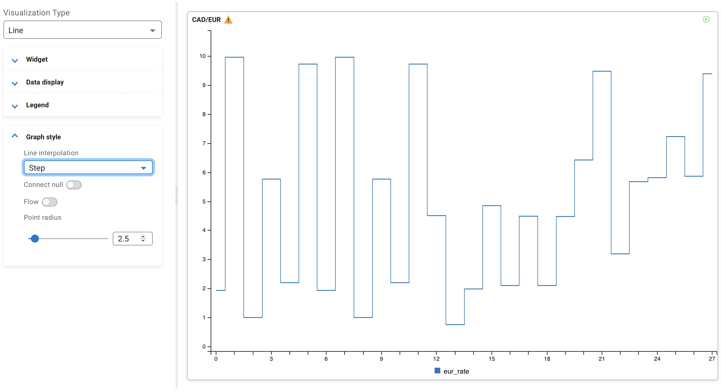

Visualization type: Line
You can use the Line visualization type when you want to show how the values changed over a period of time
) WITH (
| Line interpolation | Line |
| Point radius | 2.5 |

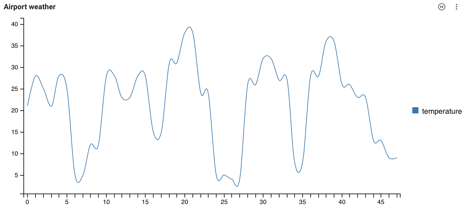

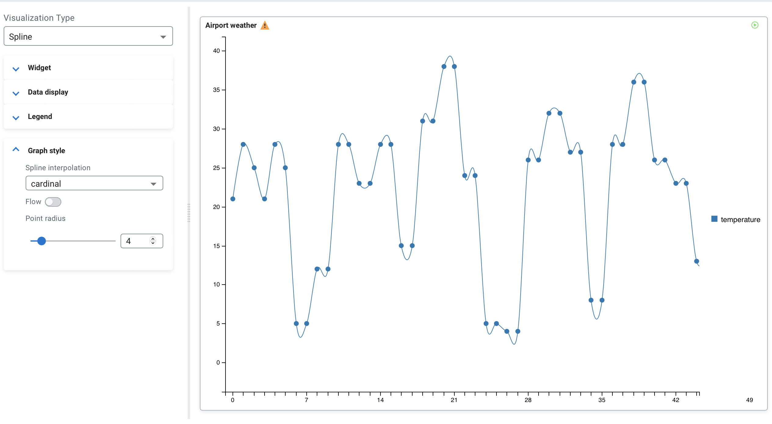

 - Determines the line interpolation of the visualization. You have the option to select Step
            as well as the interpolation as shown in the following example:
             - Point radius
              Point radius configuration, which is set to
              2.5 by default. The following example shows the enabled Show
             - Connect null
            connected or not. If enabled, the region of the null data is connected without any data
            point. When disabled, the data points are not connected as shown in the following
              example:
| Legend poition | Right |
- Show label

Visualization type: Spline
You can use the Spline visualization type when you want to show how the data changed over a period of time where the trends of change are emphasized.
) WITH (
WHERE airport = 'BIPA'| Name | Airport weather |
| Data fields | temperature |
| Spline interpolation | cardinal |
| Point radius | 0 |
 - You can specify the Spline interpolation which includes the following list of
              options:
- Linear, linear-closed
 - Basis, basis-open, basis-closed
 - Cardinal, cardinal-open, cardinal-closed
 - Monotone
 - Step, step-before, step-after
 - Point radius
             - Flow
